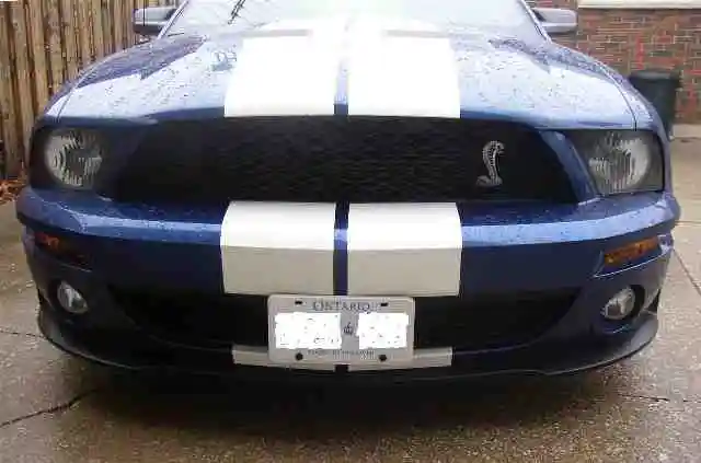

I have all you beat. My GT500 is a daily driven for me and I have 11,200km's on it since last August. All is good. I would like Ford Motor Co. step up to the wheel hop fix repacing the soft rear bushings will firmer ones.
Happy driving.
