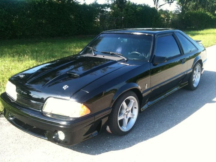

Hey guys was looking for a forum that helped people more than bashing them. And found this one so i joined. I have an 89 hatch with a 5.0 manual trans, all neoprene bushings lowereed with the cobra suspension. Thats what it came with. Now here are some things id like to know;​
1. From what i know the motor is stock. It is not the motor with mass air on it. So whats the benefits of mass air and where can i find it what will i need and what mm to fit where i want to go, which ill tell at the bottom.​
2.Because the motor is stock and i didnt win the lotto i manage a mechanic shop and i have two kids so i dont want to do it the cheap way but i dont have the budget to build the best of the best motor. Are there anything i can do to the original heads to help with things or is it just more cost efficient to get what i want going with new heads? Also as far as a cam which one, which brand. Also theres alot of different intakes and throttle body setups with different sizes considering i want the car to pop off when i hit it what would be the best size and combo to go with.​
I guess basically im trying to ask whats a descent setup for the 5.0 motor wise without spending 50,000 on a motor. Im looking for something street legal with a really good lope, but with plenty of power. i want to do it N/A no boost. I want to do this right as its a project not an everyday driver. But not a project i want to take forever id like to finish it over the next couple months. I would also like some suggestions on some transmissions i can drive manuals all day but want something my wife can run down the track as well. Ive been racing all my life but its always been the import scene. Now im on this side of the tracks looking to do something good. thank you in advance for any and all help that is given. ​

Really nice find!!
Bushings would be polyurethane not neoprene.
As far as the picture shows, that's a GT, not a hatchback. PO tried to make it look like a Cobra, which for Fox body was '93 only. '93 Cobra wheels are completely different. Looks like a Cervini fiberglass hood.
1. '89's all had mass air, yours must have it, too.
2. 3.55 gears & catback exhaust & headers if not already installed.
Before you do any mods, find out what's already been done. Detailed pics might help.

yeah i know the guy that had it and he put the wheels side skirts and the hood on it. Oh and those damn side emblems, which i already took off . i like more of the clean look. well this car 100% does not have the mass air on it. I dropped the motor off this morning to get it worked. We are doing a .30 bore forged pistons aluminum heads. With the pistons from what i was told will make it around 9.8:1 compression but here are going to deck it and whatever else it is to give it 10:1. That way it would handle what little spray i would put to it. if any. Ill have more details once the parts start coming in which will hopefully be over the next couple weeks.
