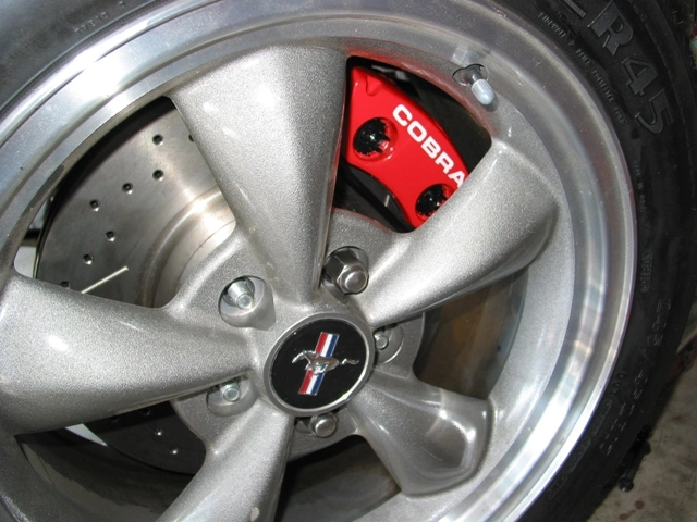

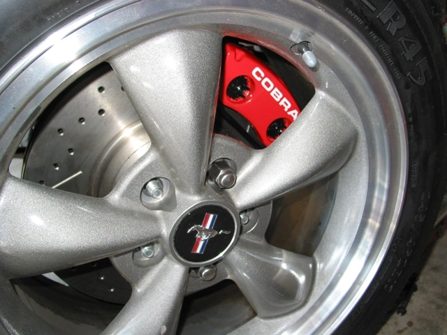

If you mean SN95 series then there are hundreds. I just put these rotors/calipers on mine, picture is from yesterday.
5.0StangRacer said:
do u have any pics of the full car, i love the look of the rotors behind the Bullits

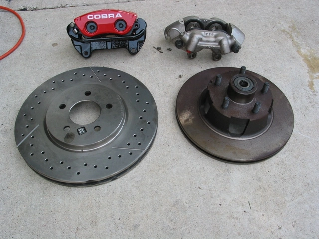

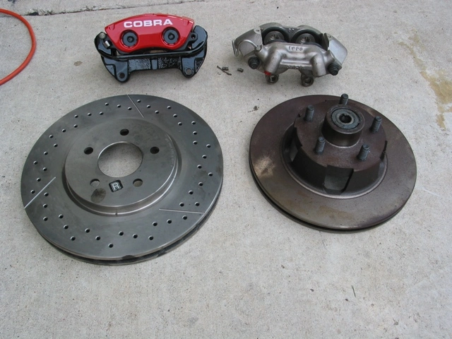

The car is a work-in-progess, there are many pictures on my website (link in sig). The wheels look great with the 13-inch rotors, I had factory power discs in there before and they looked like they came off a Honduh or something. You can see the difference here:
Here's a rather large picture, click here to view it. I didn't insert it here out of deferrence to dial-up users.

There were no directions whatsoever, but all I bought from Steve were the adapter plates. They came with a bag of hardware too. I bought the calipers and rotors over a year ago when another guy here was planning on making a similar bracket. The spindles I bought were for a '71 drum car, the shaft the wheel/brake assembly mounts to was the largest/strongest ever made for a Mustang. Someone told me that I could probably get a set of '71 drum bearings and that they'll fit the '67 hub since the OD did not change only the ID. Anyone here have an opinion on that? The '67 inner-bearings will NOT seat all the way down on the 71 spindle although the outer bearings are interchangeable.
Install was brain-dead simple, but I'm only 95% sure I did it right, so take that with a grain of salt. There really was little other choice for the install though, there's a sizeable "notch" on the other side of the bracket (http://www.edbert.net/images/2005/brakes2.jpg), very near the hole in the 2:00 position. This notch fit VERY tightly (good) around the boss for that hole on the spindle. I can see no other way the bracket could have been positioned.
Also I should mention...after getting a close-up look at the factory power disc bracket I can only say that Steve's bracket is much beefier.
