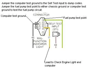

The fuel pump relay uses the computer to provide a ground on the Tan/Lt Green wire. That same Tan/Lt Green wire goes to the self test connector for the computer. Ground the Tan/Lt Green on the computer self test connector and the fuel pump will run if the relay & power circuits are OK.

As JRichker said, you can also determine if the ground pulse from the puter to the FP relay is bad when you test the socket.

OK so what im getting now is that if everything is fine and i ground that wire my car should have a working fp? Now if that doesent work where do i go next?

Ok so heres what i looked at so far today. there was a sighn of hope but it died. So grounded the wire in the test connector and turned they key into the ON position and it actually primed, but diddnt stay on. Now I went to the trunk to look at that switch and its hooked to the inertia switch. I switched that before i grounded the wire in the test connector. So i cant try much right now because my battery died so im charging my jumper box up and then ill go back at it. Im guess (and crossing my fingers now) That the switch i found has something to do with it. If it does im gonna tear that ****er out.
