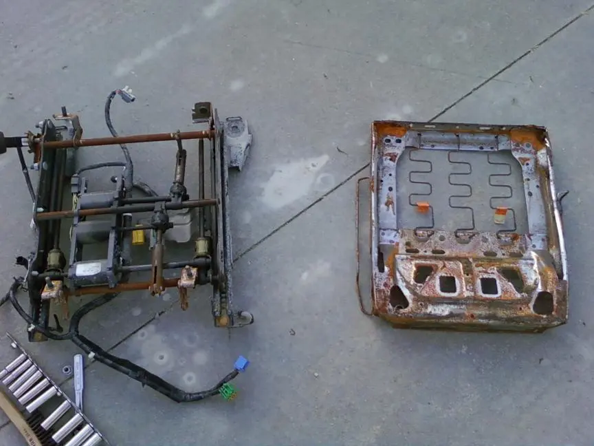

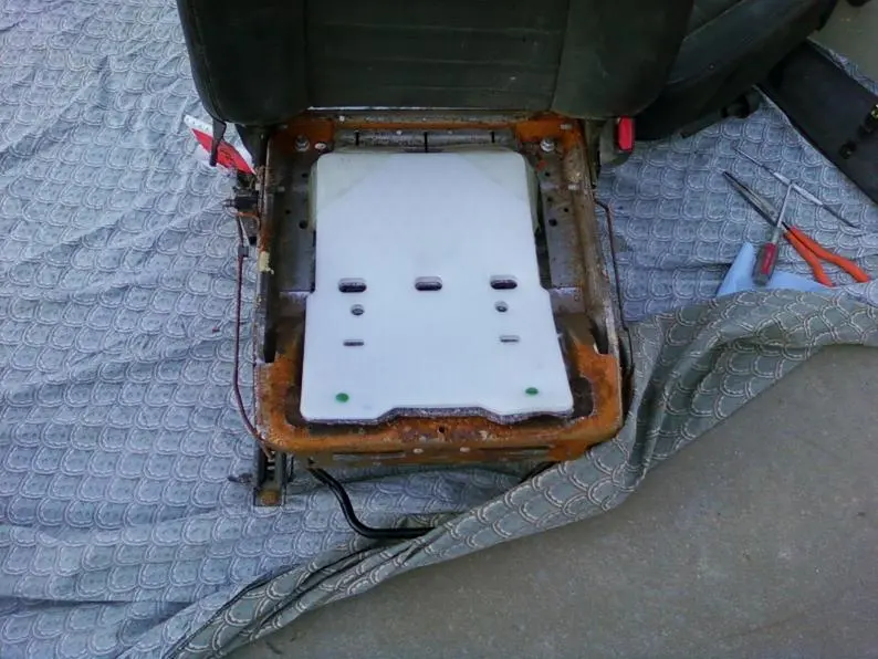

Ok. I hit a snag. Aparrently the seats I have were from a flood vehicle or got very wet because the seat frames are rusty and there is moisture under the leather. So I am returning these and getting a new set. I will post more when I get more pics.

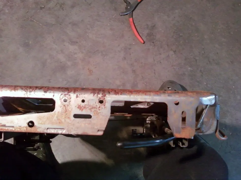

Here is a pic of the bottom seat frame stripped of all other parts and the 99-04 seat bracket that it will be mounted to. The other picture is of the airbag sensor on the 05 seats that will also be removed because it will not be used.

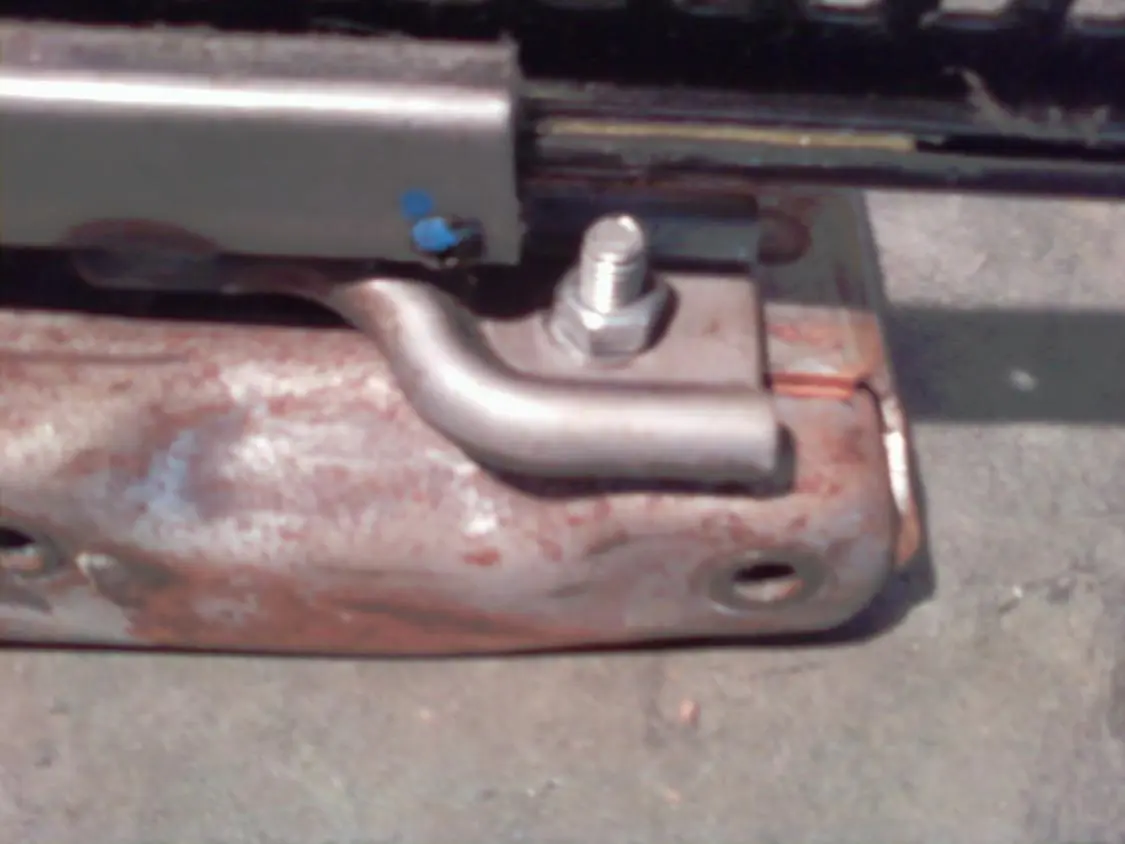

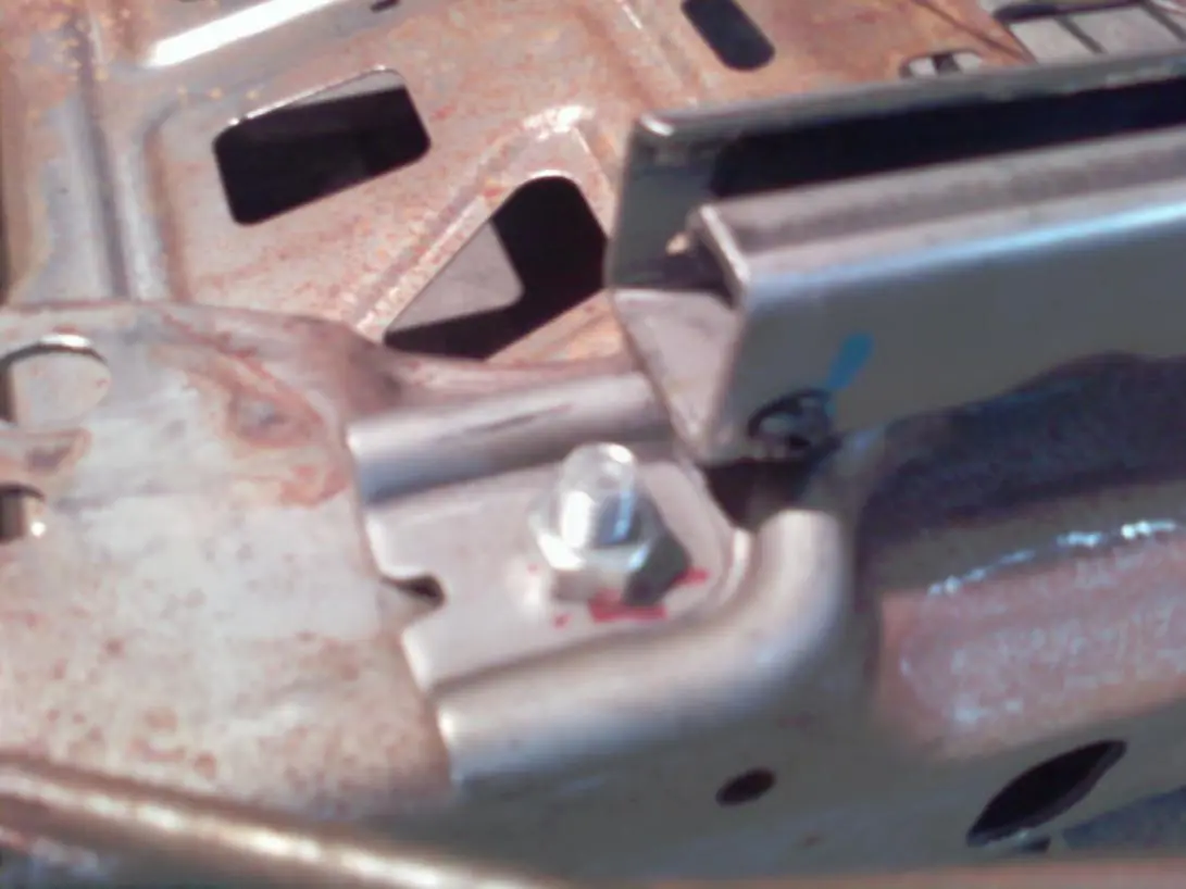

Here are some pics of how the seat was mounted. It took some time to figure out where the seats would function the best. I cut the threads off of some grade 8 bolts and welded them to the new seat frames so I could bolt them to the seat tracks.

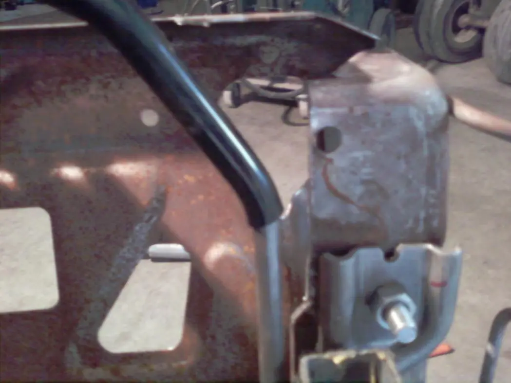

This is the passenger seat. I had to notch the frame so I could get the seat adjuster to work. It is still difficult because I did not raise the bottom of the new seat bracket up at all but it makes it look cleaner. It stays in the same spot most of the time anyways. With it being so close to the bottom of the seat it gives it the hidden look.
