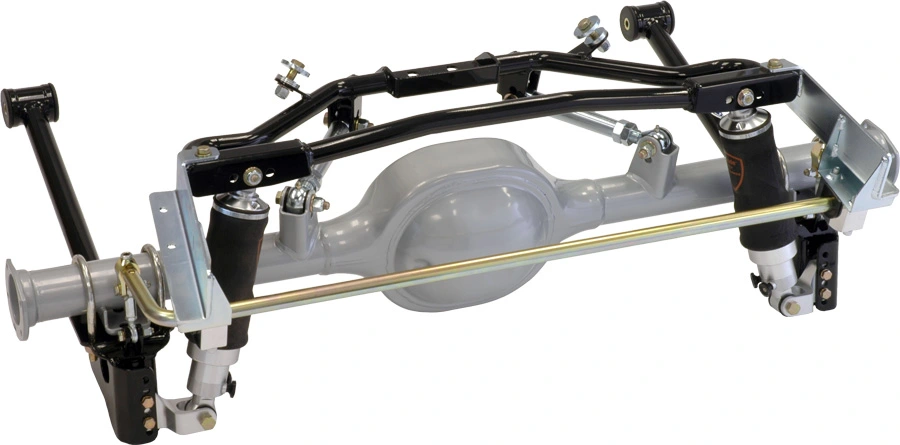

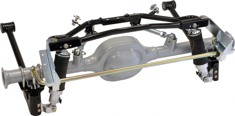

... are you going to develop a rear sway bar for the rear pushrod suspension system...

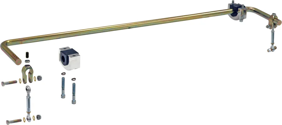

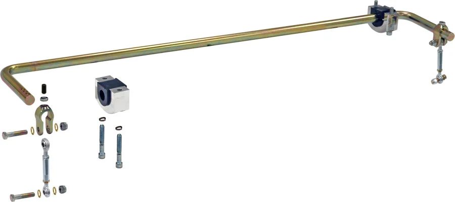

We've been extremely busy with multiple projects in each of the three product lines, so the rear pushrod anti-roll bar hasn't exactly been a front-burner item. However, it is on our to do list. I'm pushing for something similar to the sliding-link adjustable anti-roll bar we have for the g-Bar system. Since we already make usable or similar components, it should cut down on our time to get it into production once we get started.
Ok Cool, thanks.
