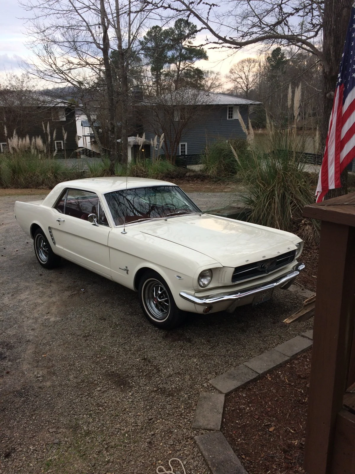

Hello all! Got my license in '65, wanted a new mustang REAL bad! Now, 4 years later, I finally got one, could not be more proud. It's restored well,, but alternator light has started flashing any time motor is running but alt charges battery just fine. If I press brake pedal or turn on lights or fan blower motor, flashing stops. Any clues where to start looking? Any suggestions are greatly appreciated!
