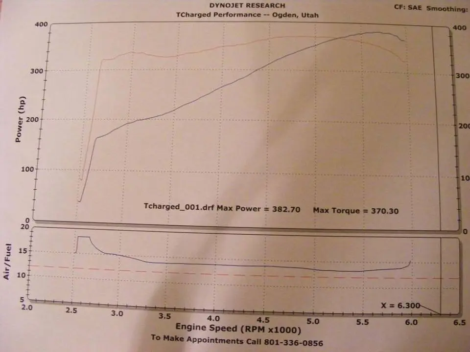

Since I put this together it has run flawlessly, power everywhere-idle to redline, I couldnt be happier...when I had it dynoed it put 382hp and 370lb on a Dynojet. I am located at 4600 ft in Utah.
Everyone on here has issues with idle problems, surging, running poorly...etc. I have just let the ecu do its thing, and Im happy. Everyone turns to the Tweecer, but I dont trust myself to tune it properly. I know theres more in there, but how much exactly? do you get more driveability than power? I would like to pick the brains of the experienced, and to learn in the process...thanks
I pulled in for my real world numbers, no cool down time. first pull...

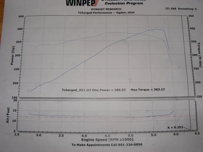

this one I added some fuel, but pulled the belt to see what a Merzire electric waterpump and power pulleys would do...
