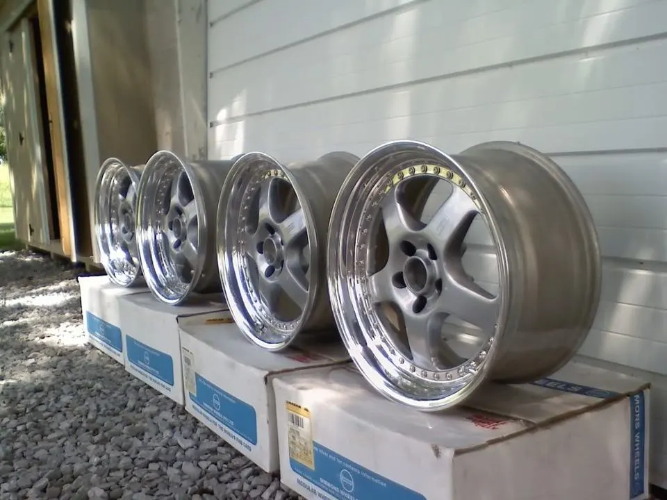

What happened to the other wheels?

you mean these? very good memory you have.
they are actually for sale. change of heart and decided to put the proceeds toward a nicer daily driver.
