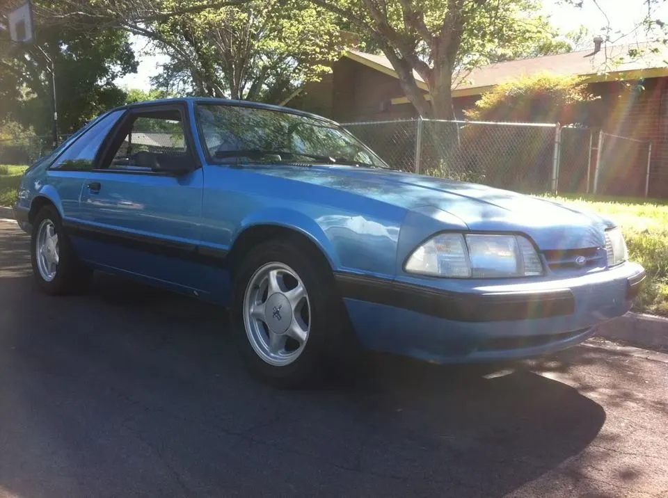

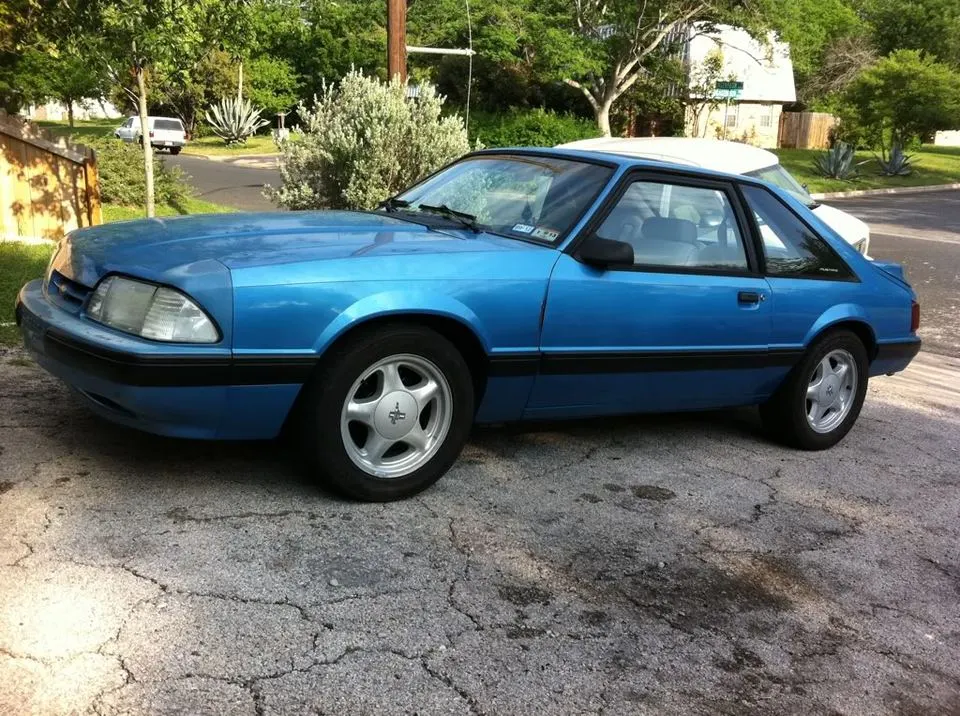

its a 2.3T. rebuilt stock bottom end, the head has been ported/polished, big valved, and completely gone through with a BoPort 2.1 kit at Kotzur Racing. probably close to 250hp as is, maybe a little more. with the work that will be done with a custom ECU, intakes and bigger injectors and at some point a bigger turbo itll be in the 350-400 range. WCT5 behind it. the body needs paint and a little work, but the car only has 54k miles. after the suspension and finishing the wiring, and a few more little performance things the next big project will be t-tops and fresh paint
as for wheels and tires, i think if i can find someone to swap my 10" for 2 more 9's im going to get with a set of 275 or 265 all the way around. when i do the brakes and 5-lug it will be getting rear control arms and new swaybars as well
Beautiful ride man you should check out my coupe.I plan on just dropping a 84-86 tc engine in mine.Did you paint your molding or just use back to black?I have done both to mine but i need to still paint some spots.My passenger side window is all rough up so im think just use some sandpaper and see if i can smooth it out.
