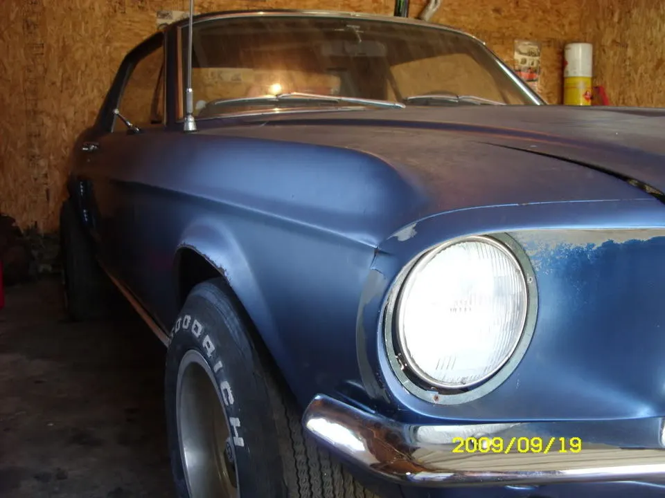

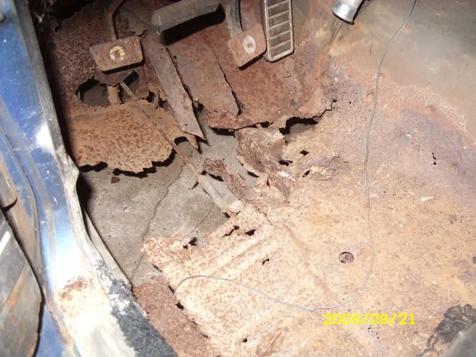

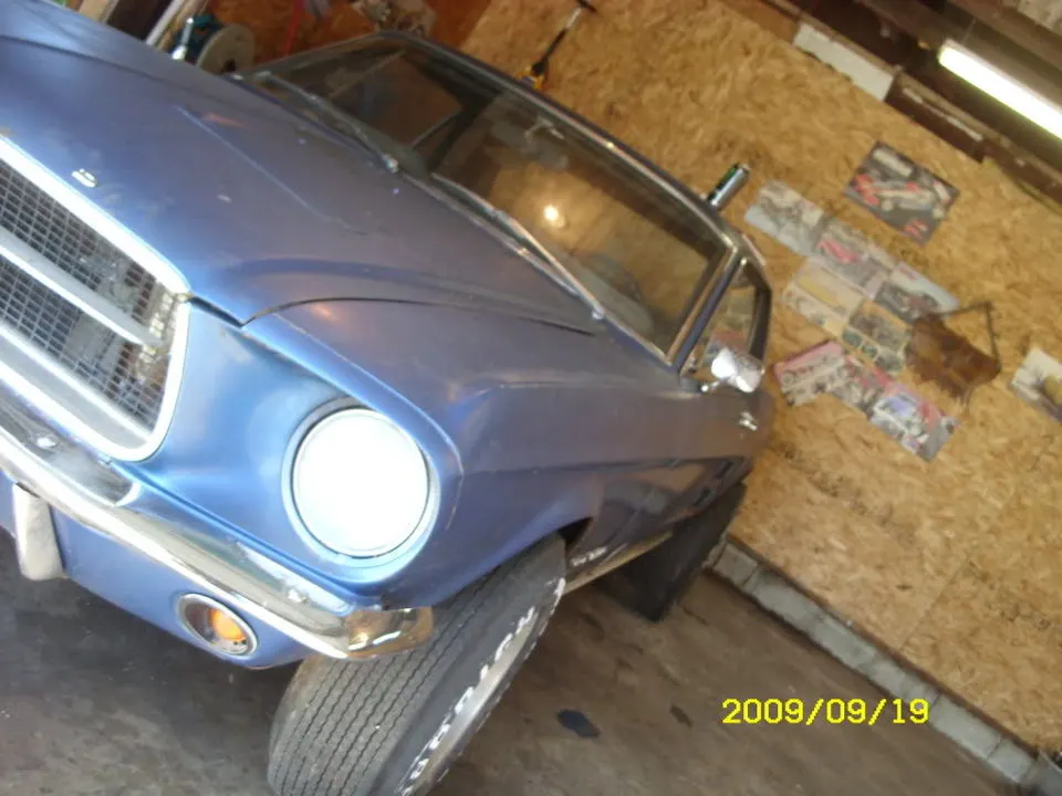

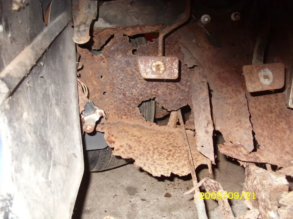

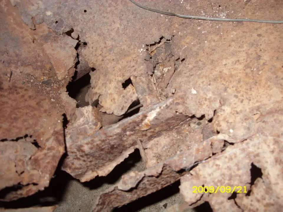

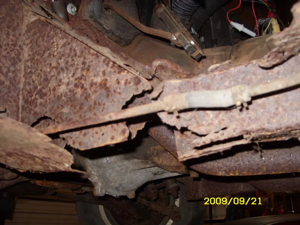

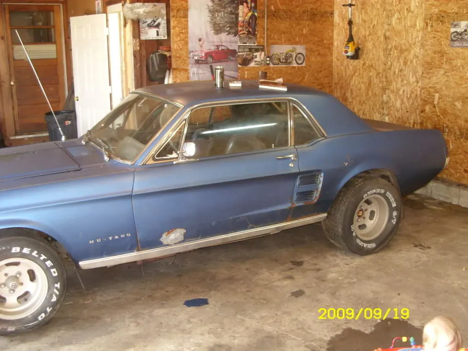

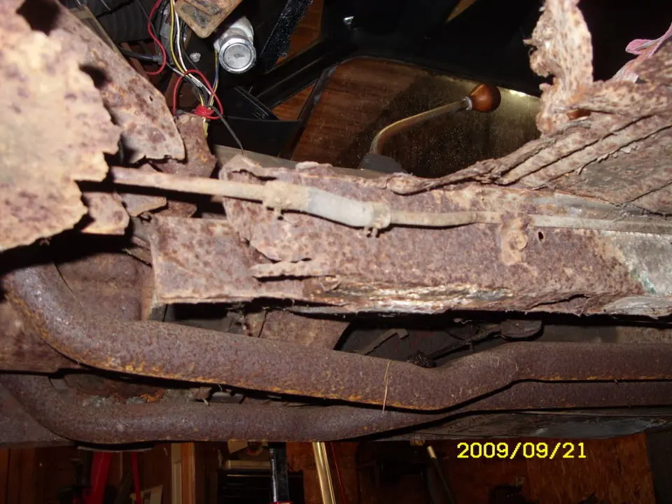

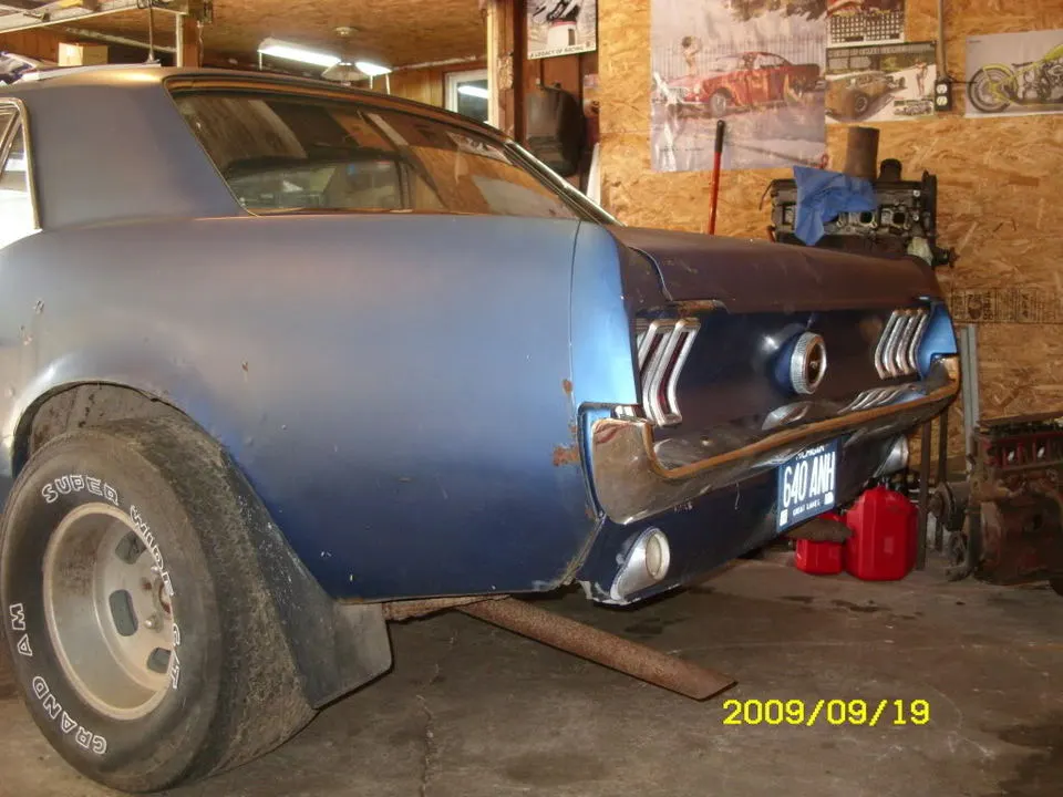

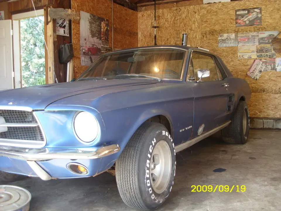

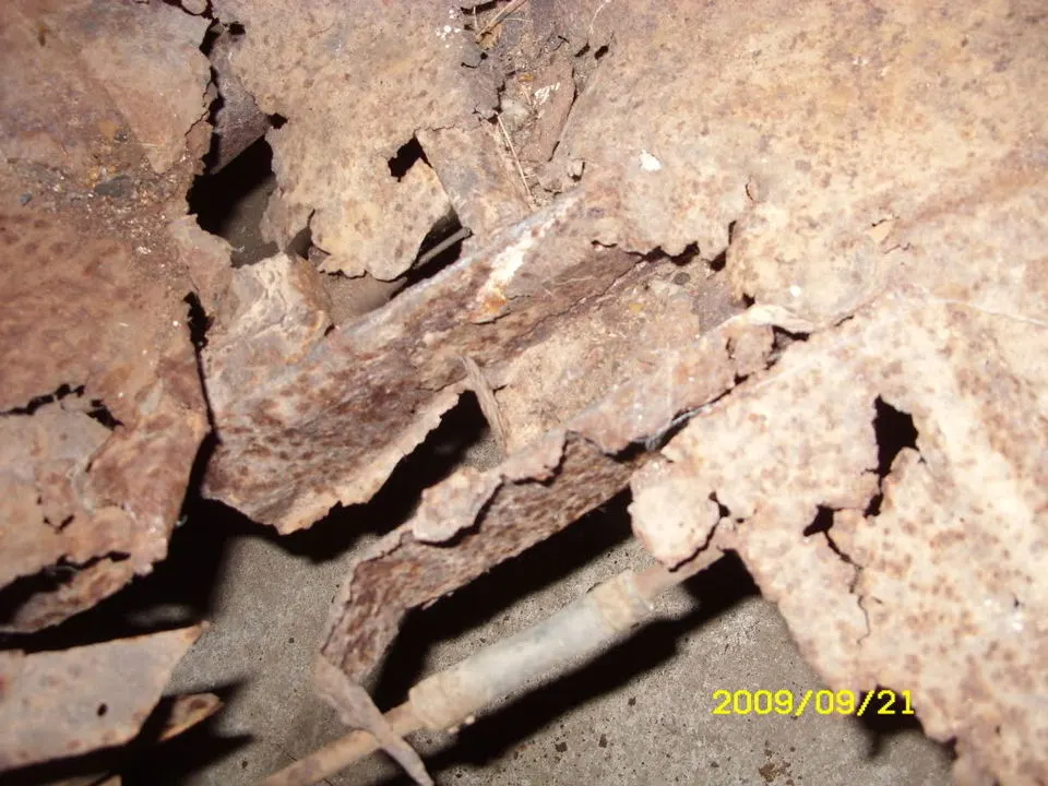

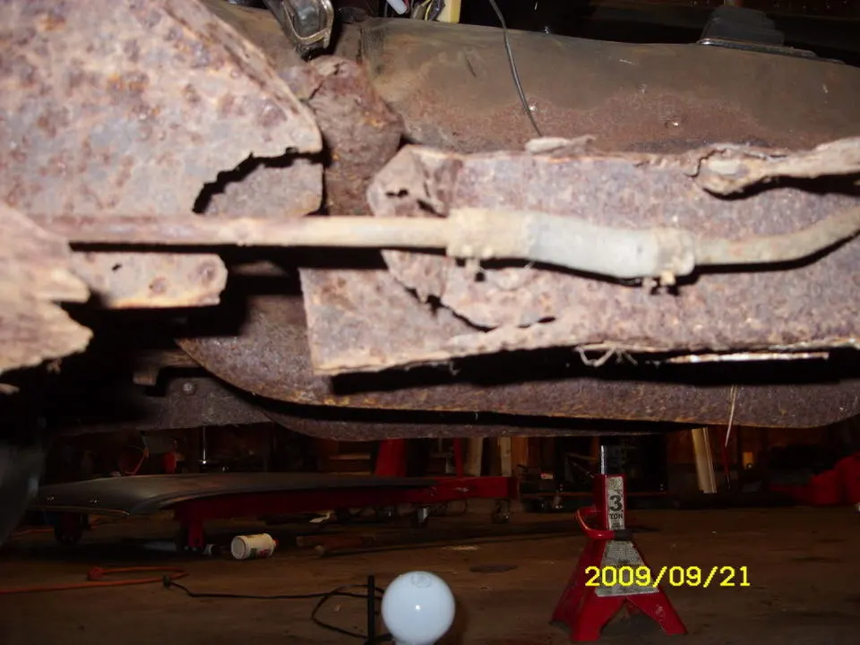

Here are a couple of pictures of my Dream car, Although rough... she is still gorgeous!
Pictures of whats left of the frame rails(front) are last.
( she will get new exterior sheet metel and all seams Lead/solder. NO BONDO!)
And this is what used to be a driver side frame rail.....
Any wonder she is still able to roll?? Pour car so sad.
Someday!

I'm somewhat speechless....
I would say to start gutting her, but I'm almost wondering if the stress that the rails would normally take is being transferred elsewhere.
I would assume that the rails should be done first, but before that I'd imagine that you need to get an external structure going to support that car before you start tearing her down.
You're in for a lot of..................fun.

OK, here's the deal. Do NOT cut all the rust out as the first step. The car must be supported at multiple points, and do the worst side first, i.e., if the left front rail assembly is to worst, leave all the rest in place and replace that rail. You might consider using complete rail assemblies, as was done with this Shelby:
Once you have all four front and rear rails solid, do the rockers, if necessary, one at a time.
Then replace the floor with a new one-piece unit. Once you have a solid platform, you can work your way outward to the exterior sheet metal.
