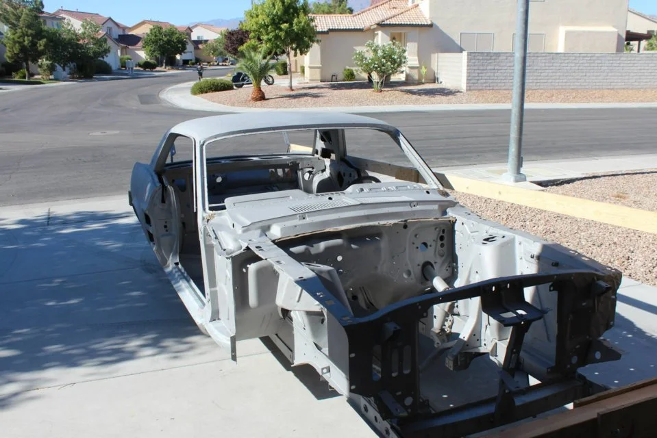

I wanted to introduce my project stang to you guys in the hopes that it would be a good conduit for me to ask you all questions as i progress. I bought this 67 C code, P/S car when i got back from overseas 1.5 years ago with the hopes of fixing her up as a restomod DD. Here is how she sits today.
67-stang-jpg.537845
That picture was taken back in October before i brought her to the body shop to get all the metal work done and paint and so fourth since i have very limited knowledge or facilities to do that work. Unfortunately, like many others, I fell into the hands of a unscrupulous body man and the shop ended up shutting down and taking my deposit with them.

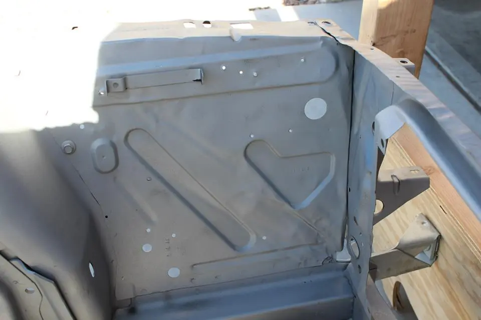

collision-damage-inner-apron-jpg.537844
Collision damage front apron

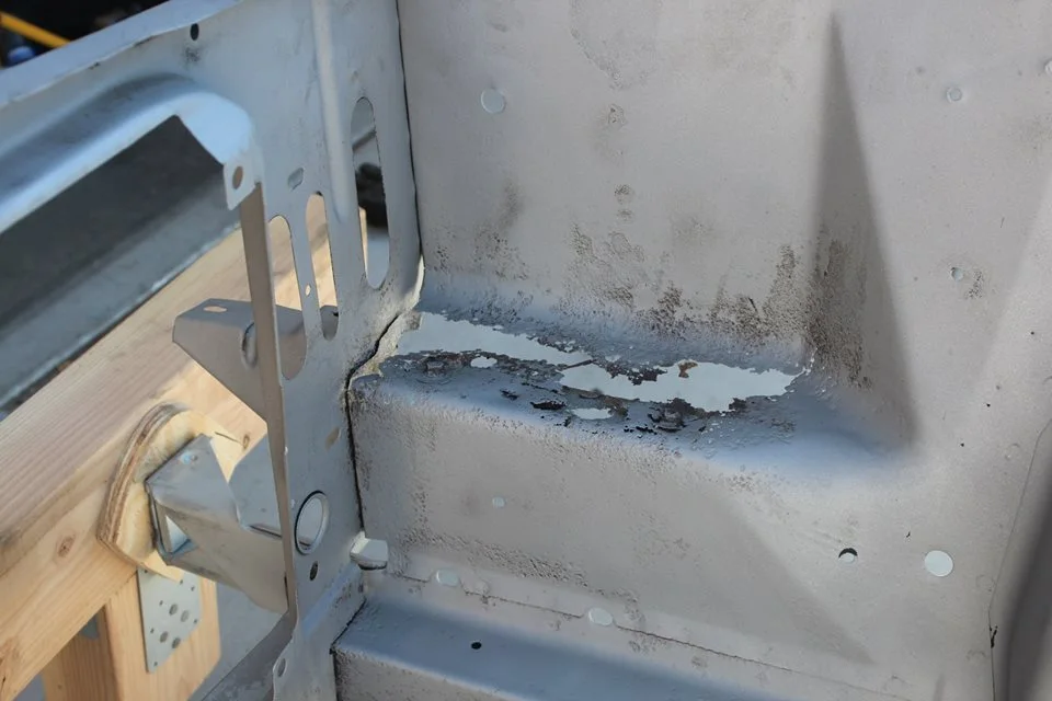

battery-tray-rot-jpg.537846
Battery tray rot

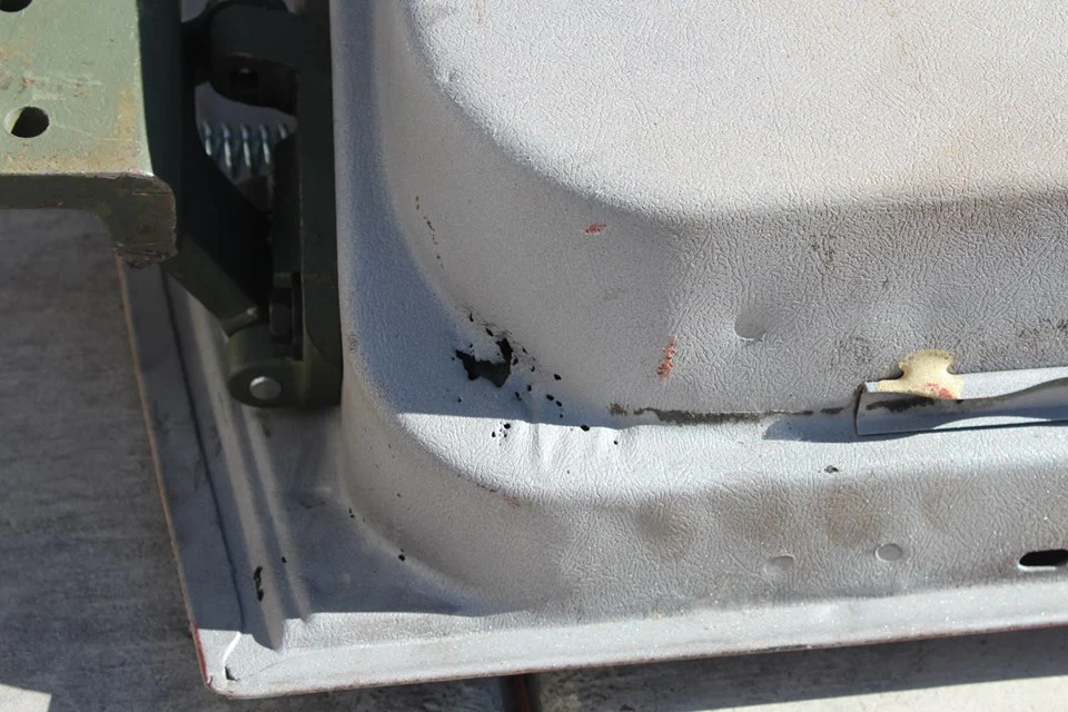

door-shell-rot-jpg.537847
Door shell rot on both doors

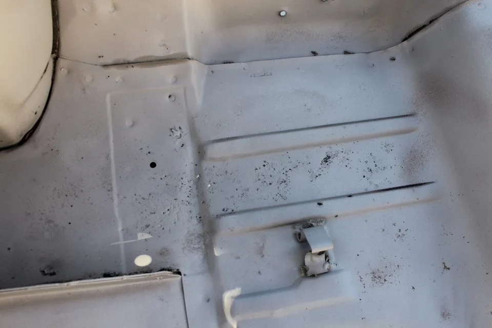

floor-board-rot-jpg.537848
Floor board rot

If you have welding abilities it will not be that big of a problem .Take measurements before you remove any inner fender aprons .I would do a complete replacement of both inner front aprons . The rear floor doesn't look real bad but that is a lot of pin holes to fill so i would do a short patch there .The doors are probably rotted from the inside out so they need to be cut out and filled in with new metal ,they have a grain to the surface, but the area that is rotted is not seen so that really will not matter .Get good replacement panels such as Dunacorn ,the cheaper panels do not have the fender mounting holes and the cheaper panels that do will not line up with the fenders . Teaching your self to weld is easier than you may think ,just look up @candphall, he taught his self to weld through welding videos .
