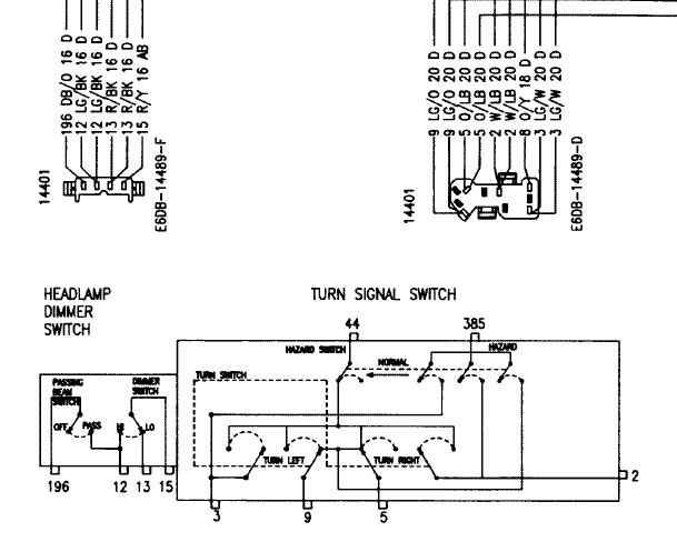

hey there i have an 86 gt and the interior was shot so i had a 88 lx laying around so i thought i would put that interior in the 86 everything went great, just one thing my blick/wiper/hi beam switch on the 88, the connector for the high beam i lost it so i have no clue when the 4 wires go, if someone could take a pic for me that would be great, or if someone know that would be cool too.
thanks alot guys.
Here's the turn signal multifunction switch & headlight switch from an 89. The wiring should be the same.
