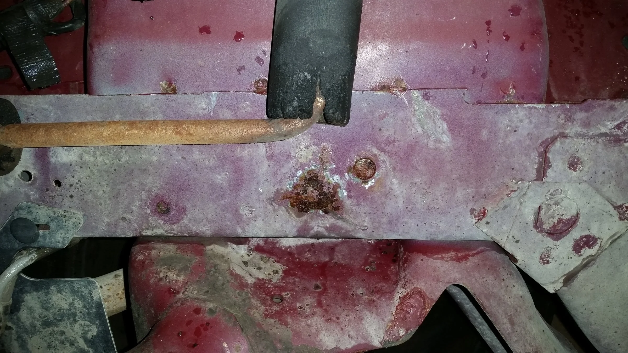

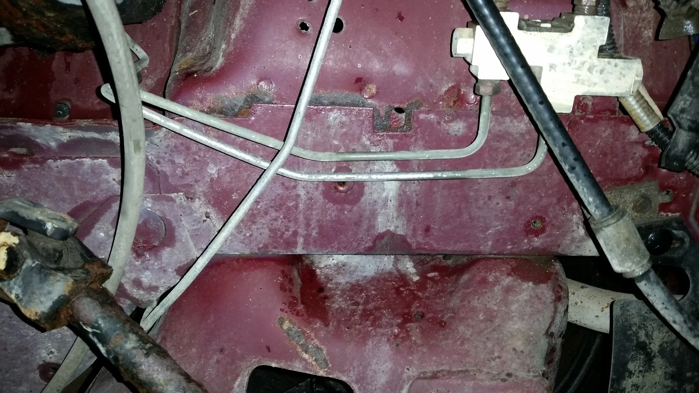

After work today I rolled the car out and started power washing. I got A LOT of gunk off, mostly oil/dirt grime off the K member and steering rack, but tomorrow I am going to spray it down with degreaser, rinse, then soap and water. Even after power washing, there is still a layer of gravel dust that needs scrubbed off. I have the wiring up out of the way, so its pretty easy.
What I noticed though, is that I have some notorious frame rail rust on the passenger side. It doesnt look too bad, but its there. Once I have the bay fully degreased, I will wire wheel the rust and see if its rotten through or not. Fingers crossed, because I have zero $ for shop labor on this kind of fix. Not even sure I can afford plane tickets to fly @madmike1157 up here for it (if his knees were 100%).
Passenger side has the rust.
Driver's side is good. Being wet makes it look worse. Most of what you see if left over dirt. This thing lived most of its life on a gravel road.
In other news, assuming the rust is surface and is an easy fix, dropping the engine in may just wait a bit longer. My steering shaft is rusted up pretty badly, so I want to replace it and possibly the rack as well. Would be way easier with the engine out. I just dont know how long it will take me to scrape up the $$$ for the parts. Damn kids.

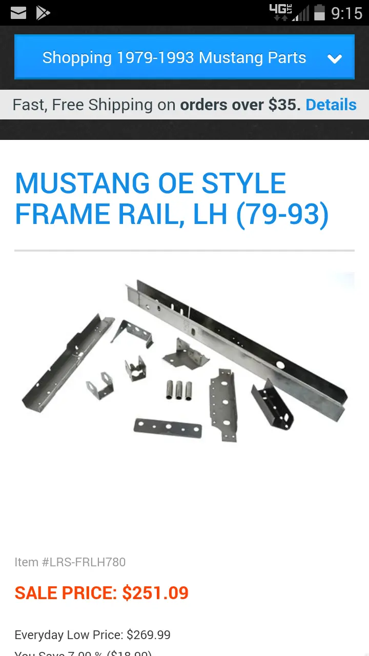

They sell a repair kit with all the metal needed pre cut. Hopefully, you won't need this...but just in case.

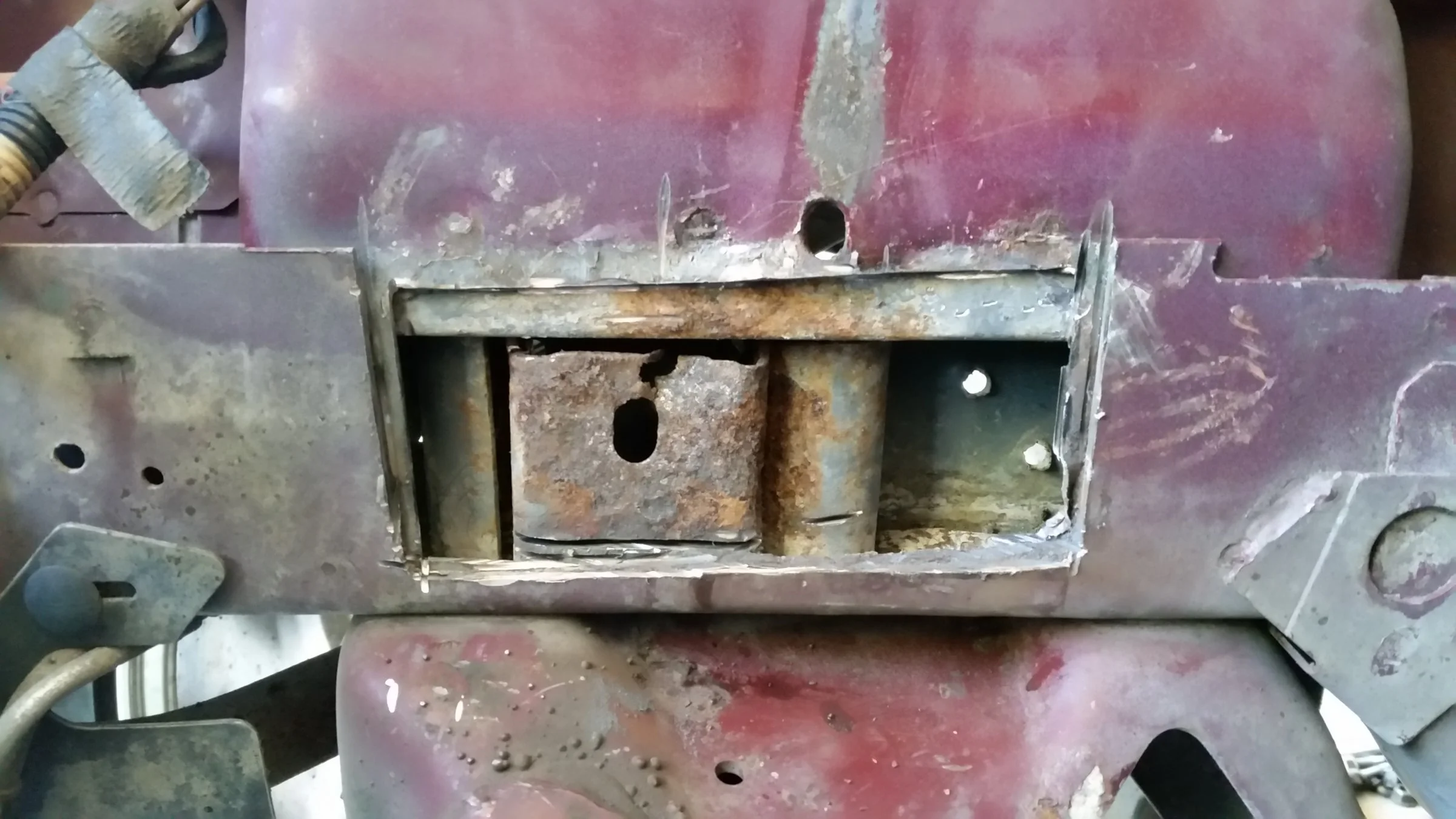

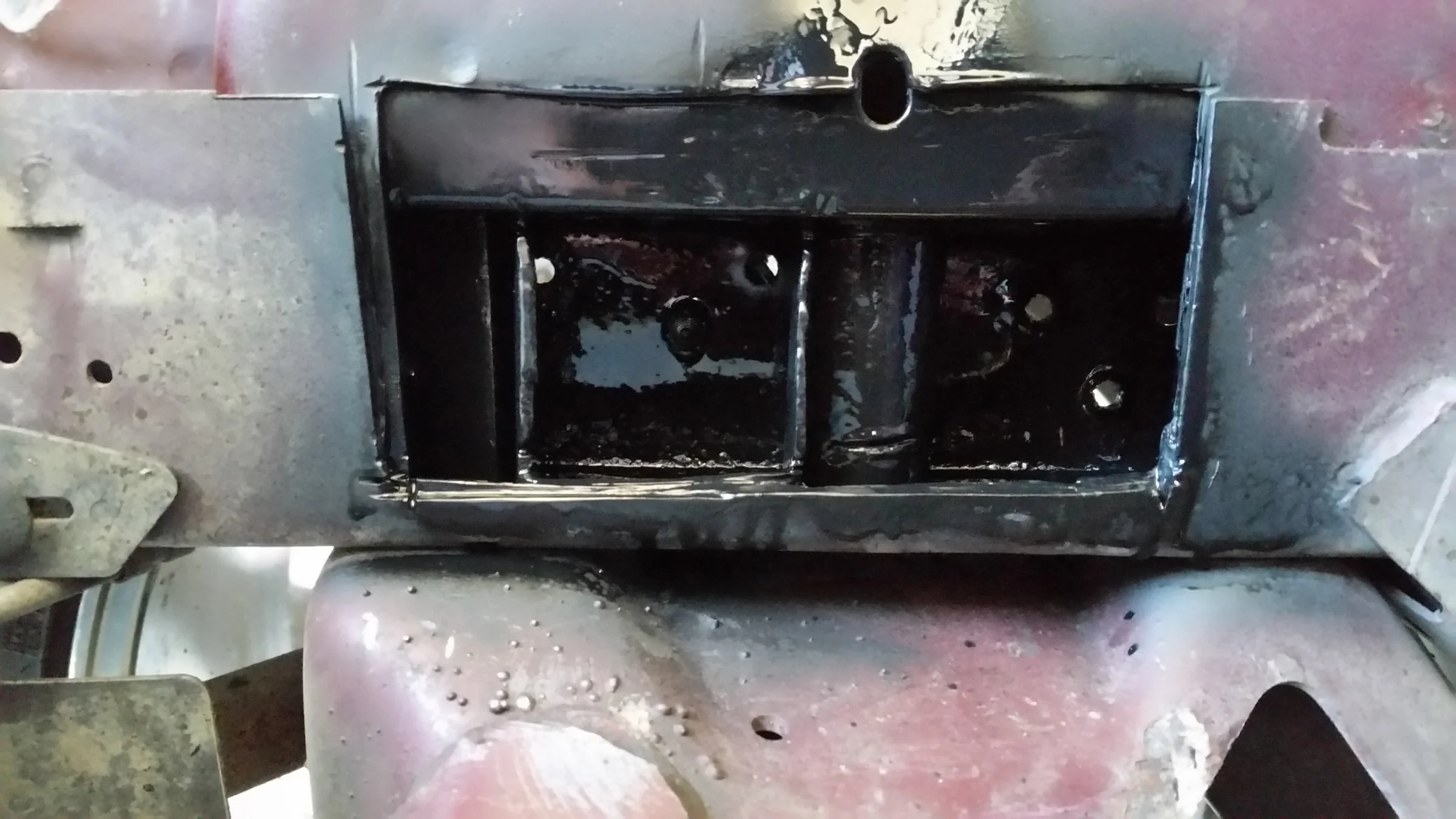

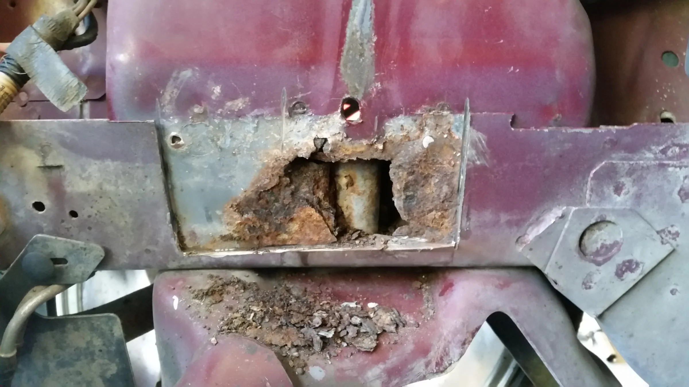

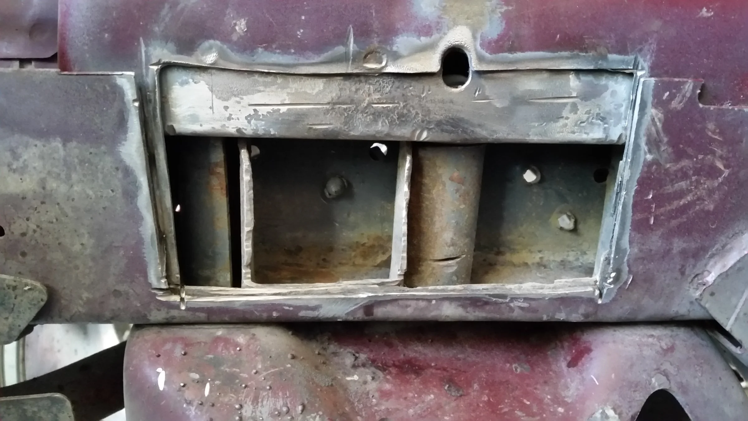

The rust was eating away more than my car. I had to take the afternoon off work and investigate. I hit it with a hammer, and it was almost all solid. Key word, almost. About a dime size of the spot was able to pop through.
Then I was forced to dig in. That A hole body man we have in here was right when he cursed me by saying, "I think you have a bigger problem in there Nick."
Thus, I must keep cutting. Accidentally cut into a good K member bolt brace.
Continued cutting, cleaning out Iowa gravel road dirt, until I was at good solid metal and, factory primer, and a teeny bit of very light surface rust.
I got in there with a wire brush, sand paper, spray bottle of soapy water, and hit it with compressed air. I got it cleaned out really well. Then shot it with rust inhibiting primer. Dont mind the runs on the outside, that will be cleaned up.
Then, I drove to Home Depot and bought a flux core welder kit. I started welding in my first piece, but I had to stop half way through. I cleaned, sanded, and primered the back side of the plate to keep it from rusting before welding it in place. I am using a series of spot welds until I can figure out the welder better. No pics of the plate yet, cause its ugly.
PS, my wife is royally pissed about the welder purchase. I tried telling her its a safety issue, and she says, "Yeah, for the car you dont even NEED!" I said....... biiiiiiiiitttttttccchhh.........

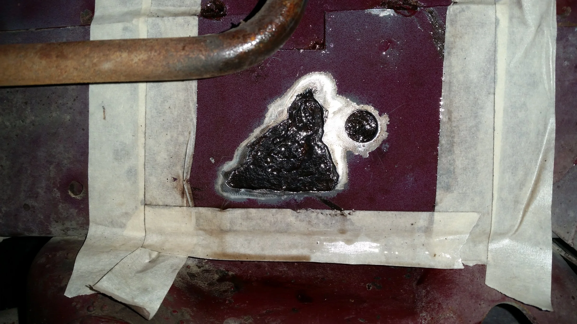

I see there are factory holes in the frame rail from the tire side. I think I will silicone those shut, or at least pop little Christmas trees in them to avoid getting more water and dirt back in there. If those holes exist on the driver's side, I will be blowing it out with compressed air. There was a LOT of dirt piled up in the passenger side.
