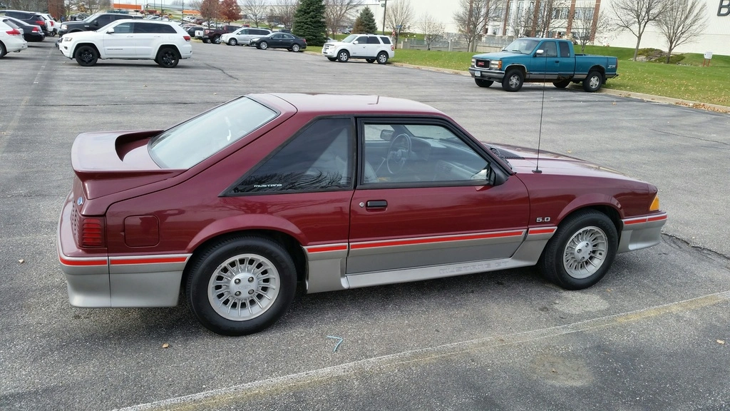

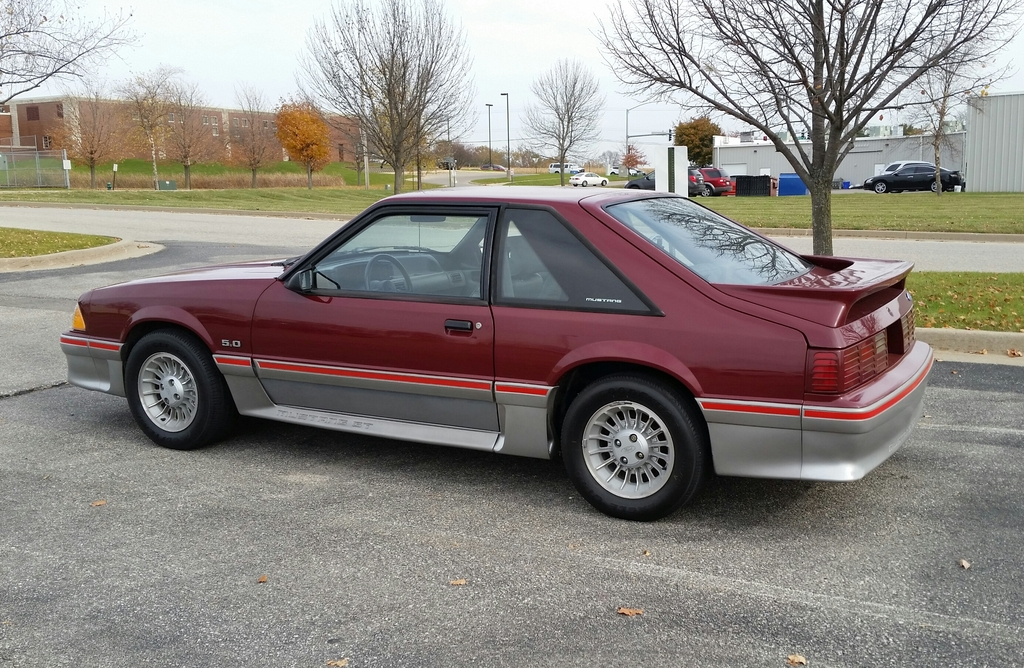

First thing is first though, here is the car.

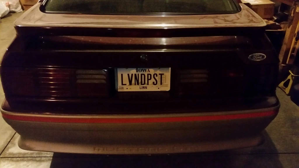

Next, to explain the title of the thread, the Iowa DOT issued me license plates "EVA 681." To keep random dudes from flying up to check me out thinking I am some chick named Eva, I splurged on personalized plates. But what to get?

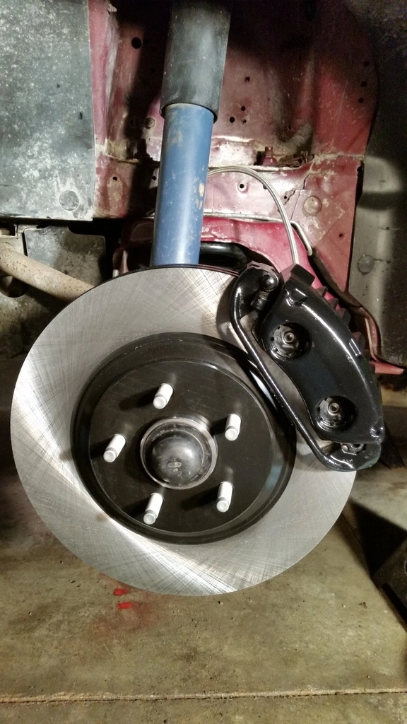

The first order of business was to address the humming front wheel bearings and pathetic brakes. This is an area where I am not going to repack the front bearings, and put new pads/rotors on. After hopping out of my SRT8 Charger with giant brembos, it was immediately clear that the stock brakes were not going to work for me on this fox. This car is never going to be anything more than a nice weekend cruiser for my reminiscing though, so PBR calipers and 13" front rotors should be sufficient. For now I am converting to 5 lug drums, and will see how that feels for a bit.

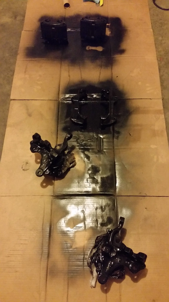

The used spindles came to me painted bright red (just refurbished with new hubs), my PBR calipers were bright silver, and caliper brackets dark gray. I decided to go all black to start with, since my car is two toned on the exterior, and I dont really want my front brakes to stand out since I am keeping the rear drums.

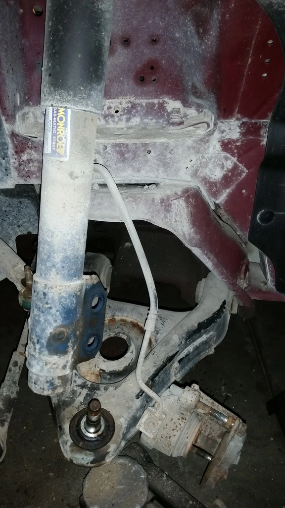

Can you tell this car came from an Iowa farm?

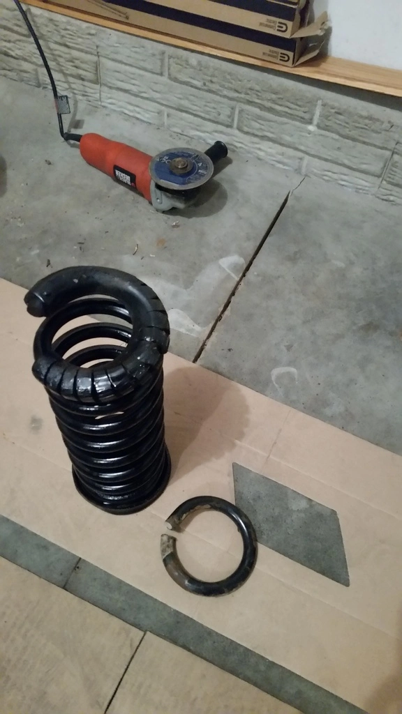

Since this resto will be on a budget, for now I am cutting one coil off the front springs, and keeping the super high performance Monroe struts. I cleaned and painted the springs, and reused the stock isos believe it or not.

That is a remarkably clean car for having lived it's life in Iowa. I almost fell over when you posted a picture of the cleaned up wheel well. If you couldn't take the car to a car wash (because it was torn apart) how did you get it that clean in the "after" pic?
**Edit.....just figured that out myself.....You did all of that stuff by hand w/ a brush and rag prior to the pic. Cause you know had you posted that pic of new stuff bolted onto dirty parts....................:nonono:

That is very good looking car.. Congrats on the find buddy,looking forward to the updates/progress on this one.
Nice look'n car, congrats.

Livin in da past (LV-N-D- pst)
lvndpst
SYH
Technically I was going for "living the past," Lvn D Pst, but close enough.

Wheels are chrome 2010 GT Premium style. Wanted silver, but couldnt find any and chrome were on sale for CHEAP. I just wrapped up the passenger side front brake swap tonight. Need to bleed them, and get the rear axles/drums swapped over in the next couple nights.

Here is the difference between you and me (one of a few?). I am ok with bolting freshly painted stuff to dirty stuff, and dont care what anyone thinks about it. I will likely take a lot of this stuff back off later for future upgrades as money allows. Besides lets face it, we buy these cars because we love tinkering with them. I will be putting fresh drums right onto the dirty rusty old axle housing. This summer I will drop the axle, grind it and paint it, along with adding upper and lower arms. But for now, it was 45 degrees in my garage, and I used a bucket of hot water and rag to wipe away some of the dirt to see how the paint looked under it. A power washer will do a much better job in a much easier manner once its rolling again. The passenger side only got a once over with the shop vac to get loose sh*t, and then parts were swapped over. I bet the car will lose 5 or 10 pounds of dirt when I get a chance to really clean it up well.
