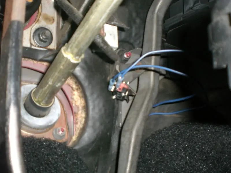

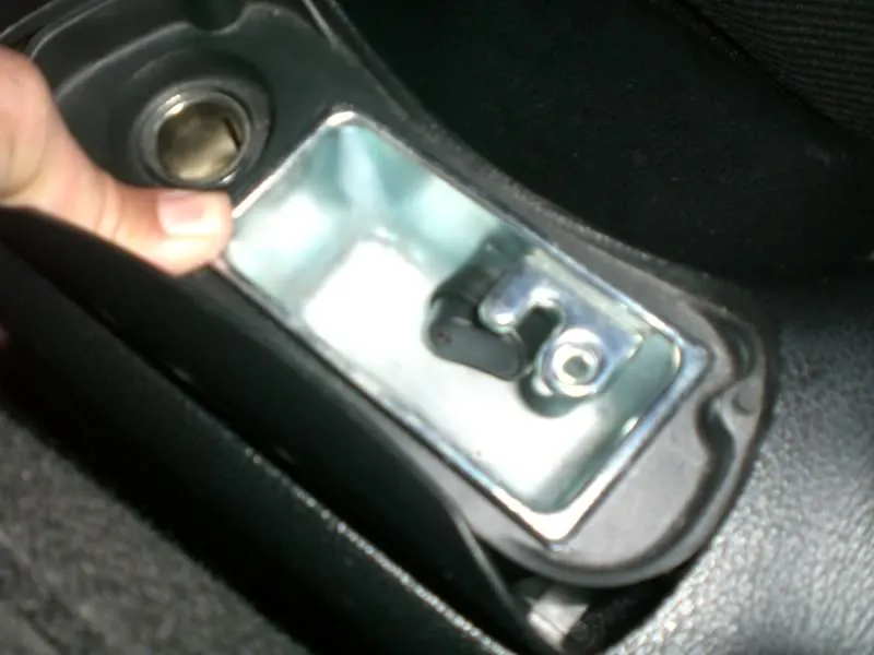

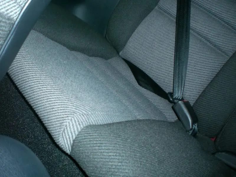

Well I am not doubting the experts here can find a trace of it. (Excluding the fuel pressure safety switch, nothing I could do about that.) But it is extremely well hidden. Ill get some pics up later. And the bottle is under the back seat All solenoids and wiring are in the passenger wheel well. WOT switch is on the pedal. Activation switch is in the ashtray. Purge switch is in the drivers side carpet between the dash and center counsel carpet area.

There's no room for a bottle "under" the back seat. I'm going to need to see pics of that too.

lol who told you that lie and got away with it? Of course there was "modification" made to the rear seat cushion

Will put pictures up after dinner

Actually it seems like its just about halfway, and its actually more then 10 now, lol.
Its actually at a 45* angle as per instructions but moved it when I lifted the seat to take pic.

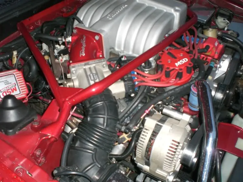

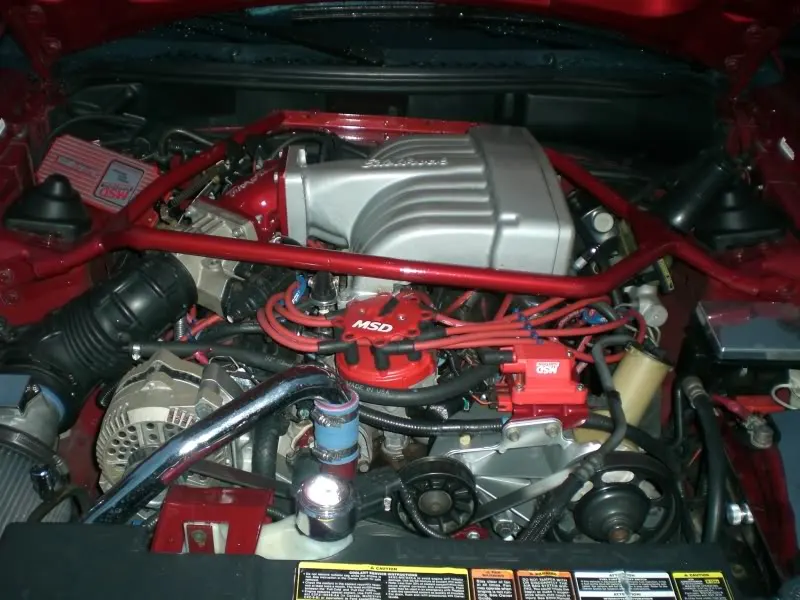

very nice, were is the fogger at?
GTA_V6_Mustang
Nov 29, 2004
1,326
39
Miami, FL
Apr 16, 2010
#14
  • Apr 16, 2010
  • #14
Exactly! Give it a few more minutes I am sure someone will figure it out *goes back to god of war*

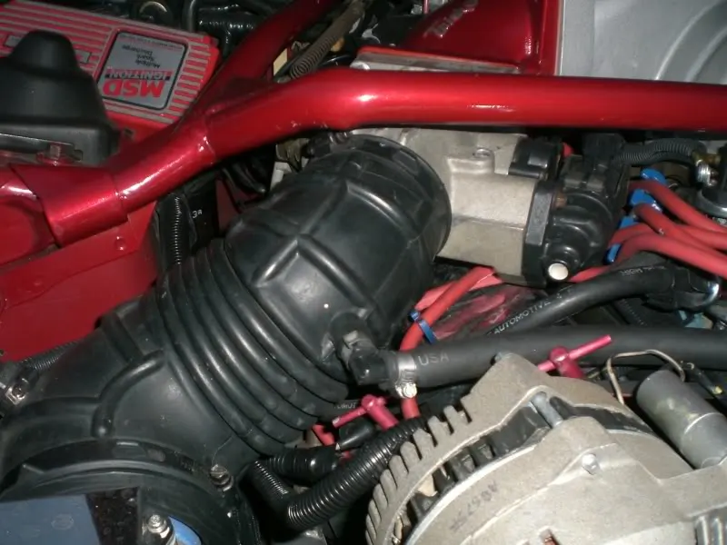

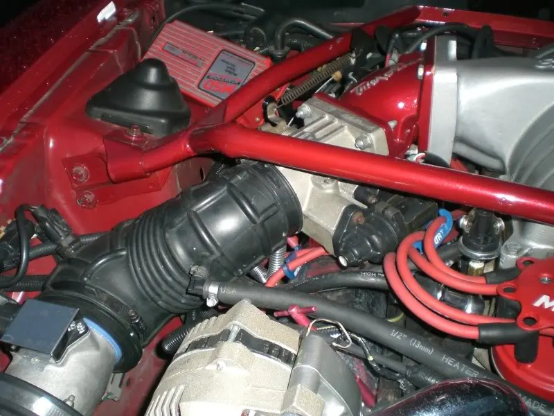

that heater hose line seems to be centered in the pics, is that it? or in the airbox maybe, haha, IDK, but I like it!
GTA_V6_Mustang
Nov 29, 2004
1,326
39
Miami, FL
Apr 16, 2010
#16
  • Apr 16, 2010
  • #16
lol nope, heater hoses are heater hoses. Except the one in front of the engine which is just the breather, from driver valve cover to intake tube. And nothing on the filter.

Why does the strut tower brace look all weird at the bend by the TB?
Kornnut
Nov 25, 2000
1,999
48
108
Tulsa
Apr 17, 2010
#18
  • Apr 17, 2010
  • #18
Is it on the underside right before the TB?

lol, you sneaky SoB, i can't tell where it is, and the bottle....how in the hell did you get that to fit there? you are creative! kudos!
