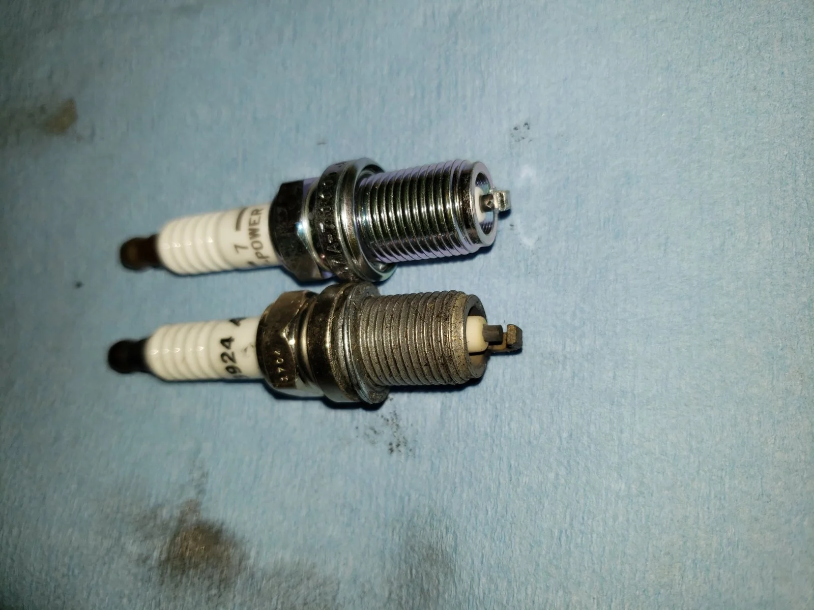

Just bought another set of R5671A-7's, which are 2 steps colder I believe. For a 10.8:1 331 with a 100-125 shot. Believe these may still be a little hot and might bump to an 8 next. I think NKG in a stock heat range is around a 5.
Here are the NKG 7's vs 3924's.

Do you guys think I should at least go to the non protruding tip?? Joe your pic is exactly what I’m trying to change FROM and TO but want to be right on understanding heat range..
so R5671-(heat range).. is what I want yes? If I’m right about that I’ll probably start with a 5671-5..?

The R5671 is the plug type, the number on the end is heat range. Stockish should be a 5, so if you are going to spray it, I would go at least one colder for starters, so a R5671-6. From my research, the non protruding plugs were better for nitrous use, so yes, i would recommend it. Basically the more heat in the chamber, the colder plug needed. Cam design, compression, base hp level of the motor can all play a part in your decision in addition to the amount of nitrous you spray.

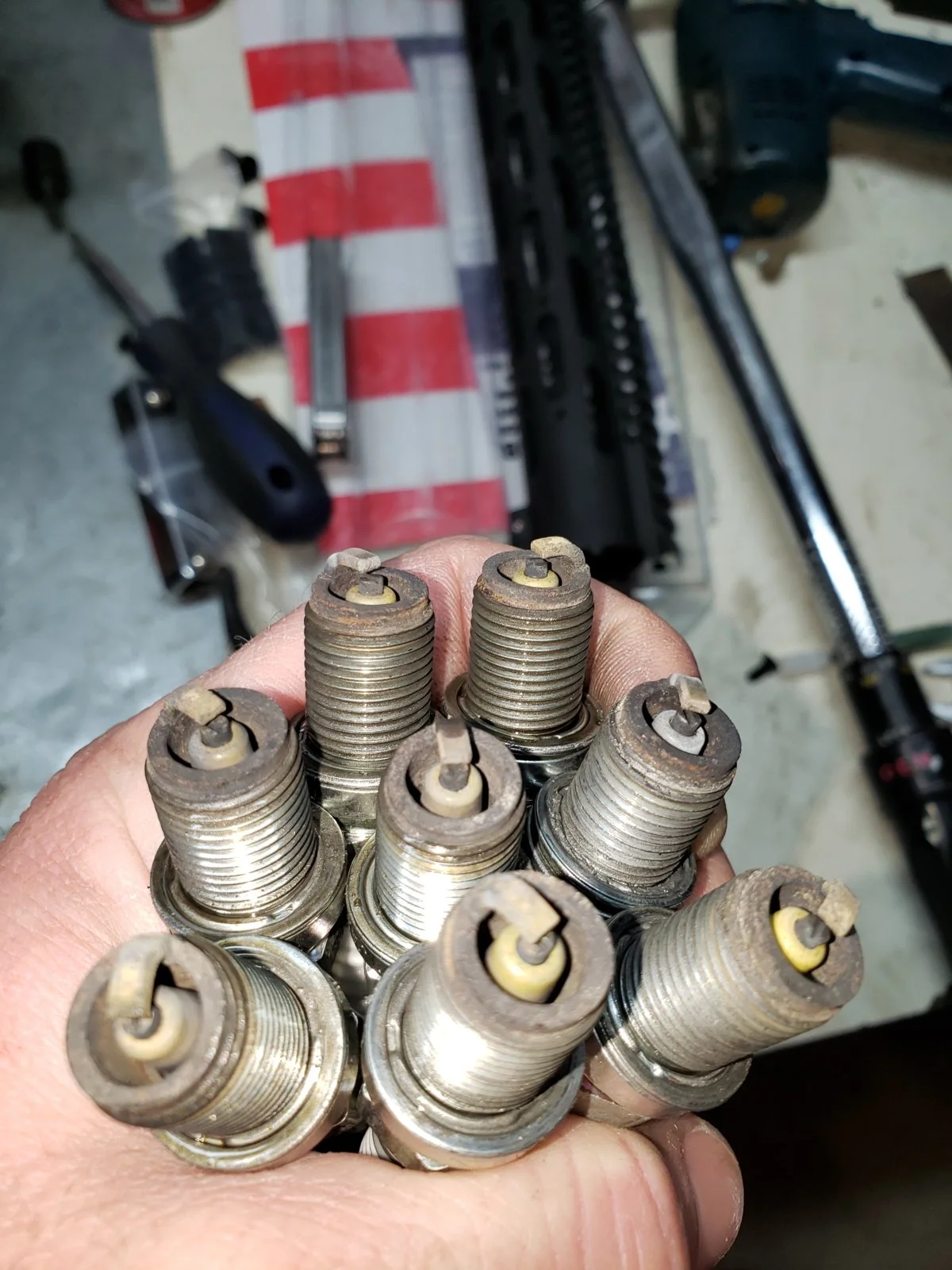

There are a lot of things wrong with these plugs, but these are the NKG's I pulled and replaced last night.

Those are a projected tip, not what you want for nitrous use. Not sure if it would be considered a "race" plug or not. They may not make a stock heat range plug in the r5671 style, which would make sense considering they are a race, power added oriented plug. If you are going to spray the engine, why do you want to stick with a stock range plug?

I think you are right, they don't make that plug any hotter than a 7. I am sure you could get away with another style plug in the 6 heat range on such a small shot. In my opinion, the worst that could happen from a too cold plug is it could foul out quickly. Too hot though could lead to a melt down. Like I was saying on mine, I think a 7 may be too hot. I am going to pull timing this weekend and try it again with a fresh set of plugs.
