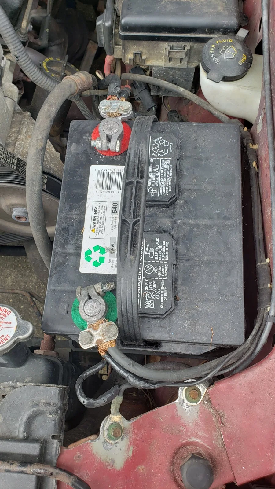

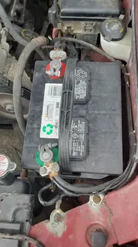

Ok the car is running. Only took a week and a half. Lol. I bought this car for my daughter 2 months ago and this site has helped me a couple of times already, and for that I say THANKYOU. It has those aftermarket battery cable clamps. I took them apart and cleaned the cables. I even stripped back some of the coating on the positive and negative cables and cleaned that too. As you can see in the pic I removed the two ground wires in the bottom of the pic and cleaned everything. Put it all back together and presto, it started. Stangnet is definitely top notch in my book. Thanks again.
