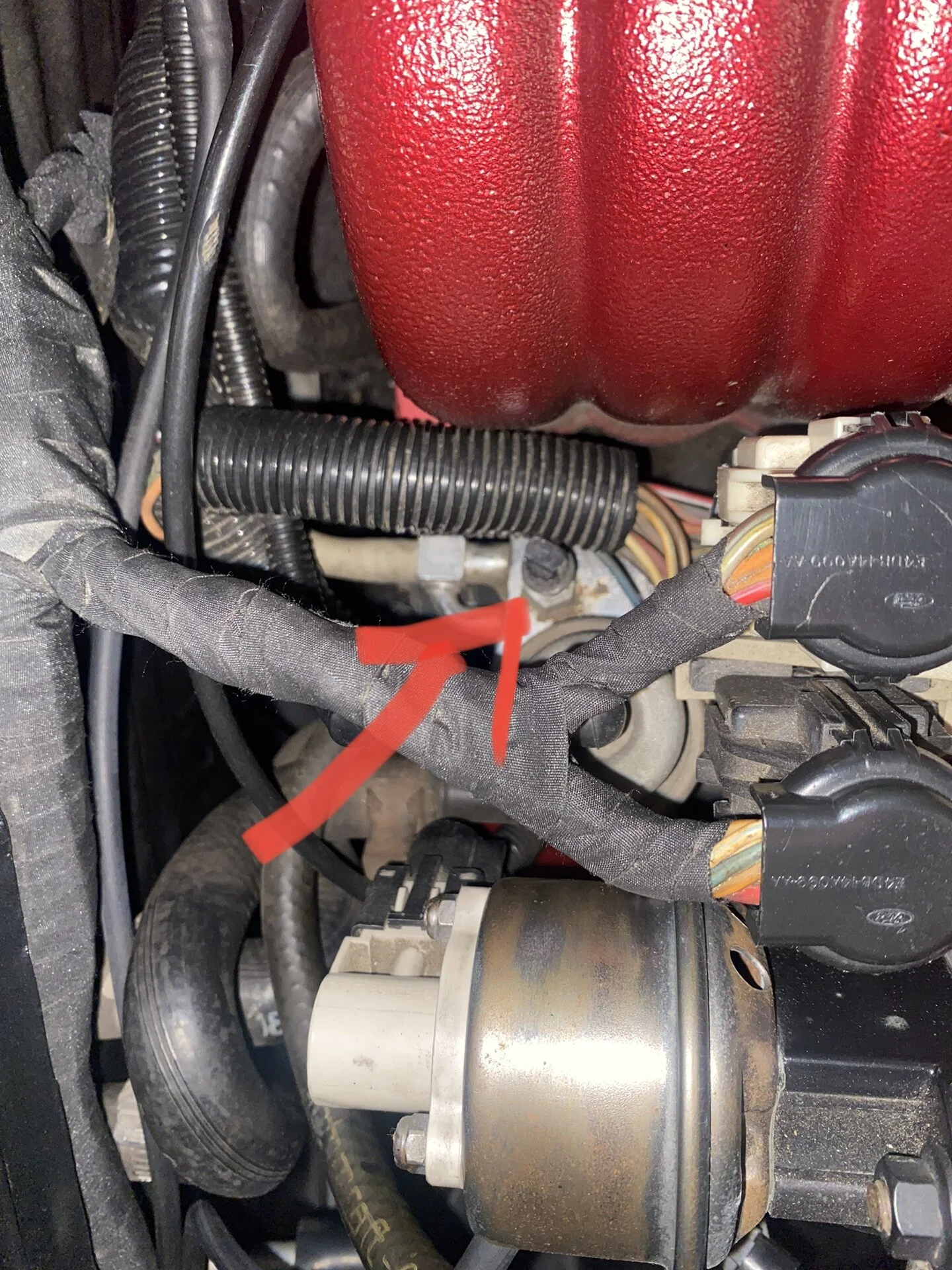

Couldnt find it. Ive seens videos of it being right next to the valve cover, but I cannot find one on that line at all.
Follow the line to the rear of the engine bay. My ‘86 LX has the Schrader valve all the way in the back, right behind the 10pin connectors. You have to lean over the motor and look straight down behind those connectors. My ‘86 GT had it behind the alternator. Why it’s different, I don’t know.
