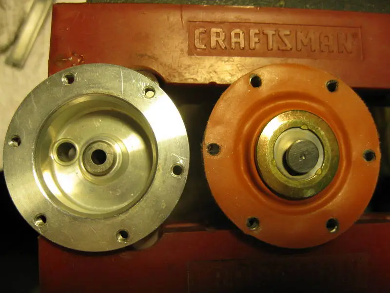

Unfortunately, I have nothing to compare to. My pump was replaced in 2015 when I installed this set up. I believe it's a 255lph...or 340lph walbro. ( would have to check my thread ). I thought I had an issue at first and did several checks on the fuel system. Even contacted the place I bought it from and Kirban. The pump was holding pressure, the diaphragm was OK inside the Kirban, no leaking injectors. I did some quick research and found several people with Kirban and the same issue. I deemed it normal. They were going to send me a replacement but I canceled it. If I plugged the return line the fuel pressure held for a while. The pressure was bleeding off through the regulator out the return line.

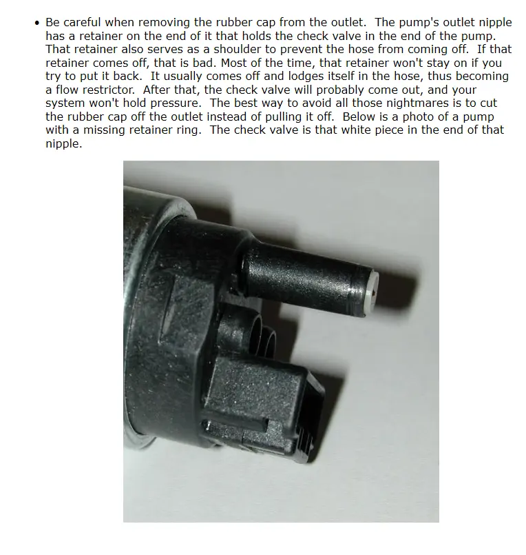

There is also a check valve in the pump. This is usually the main cause of the failure of the fuel system to hold pressure. The FPR just acts as a restriction in the line to build pressure ahead of the regulator (where the injectors are) but if the fuel pump check valve has failed, there is nothing to prevent backflow through the pump relieving all pressure in the line.
I haven't handled a walbro pump in a while, so I don't know if the new ones still have it or not. I think I still have my original pump somewhere to take a look at.
That's how my kirban looked inside. Definitely a check valve.
In order to hold pressure in that line, since the fuel pressure guage is between the FPR and the pump, you need a check valve on both ends (when the pump is not running) otherwise pressure will relieve itself through the pump.
