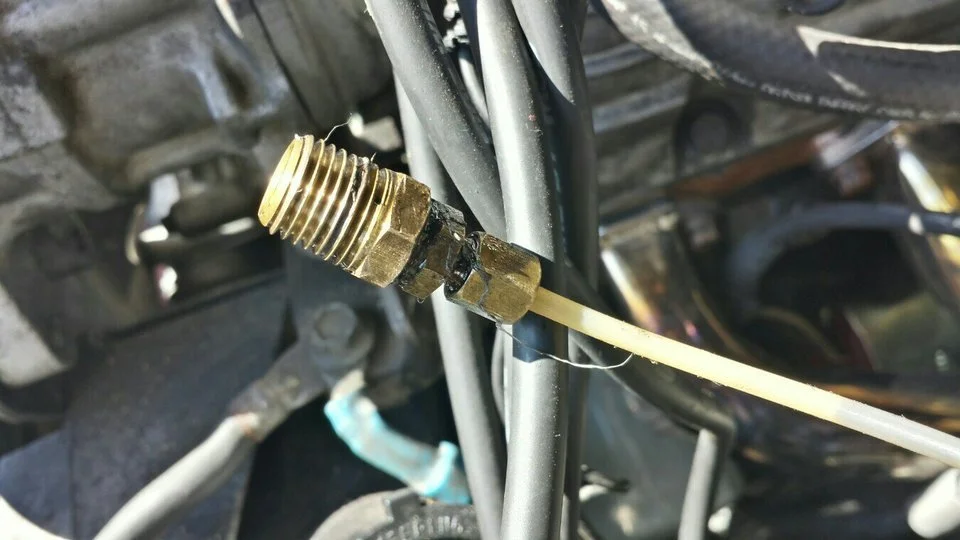

I have a big problem. After I took the car for oil change, days after, my check engine oil light came on. I was thinking it was low so I took it back and they showed me where it leaked from the nylon tube out the sender.
So I fix that, with new connection but same nylon to the mechanical gauge and it didn't leak but check light didn't switch off. Pressure remained good. At 2k normal engine temp, pressure was at a solid 45 psi. (25 psi at idle)

Well, if you have a mechanical gauge, you don't have a sender.
At first thought i'd think the engine is fine and it's something with the nylon tube. Could you have gotten tape in the tube or in the way? Compression fitting crush the tube?
I've never had any luck with the nylon tube, switched to copper and never had an issue again.

Thanks for clarification, could that unit be bad anyway ? Im gonna change the tube with the new one that came with the kit. If that fixes I can upgrade later
x2 on the copper tube. I've seen overtighted nylon tubes pinch off the oil pressure gauge or make it really slow acting. I would change it to copper first. If still not pressure reading pull the distributor and look to see that the oil pump shaft is ok.. Then you can use a priming tool and a drill to test the pump and see if it makes pressure without running your engine and doing any further damage if any.

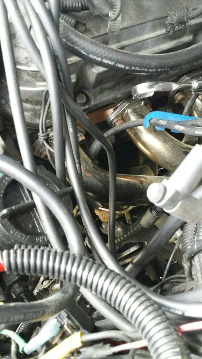

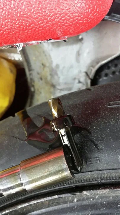

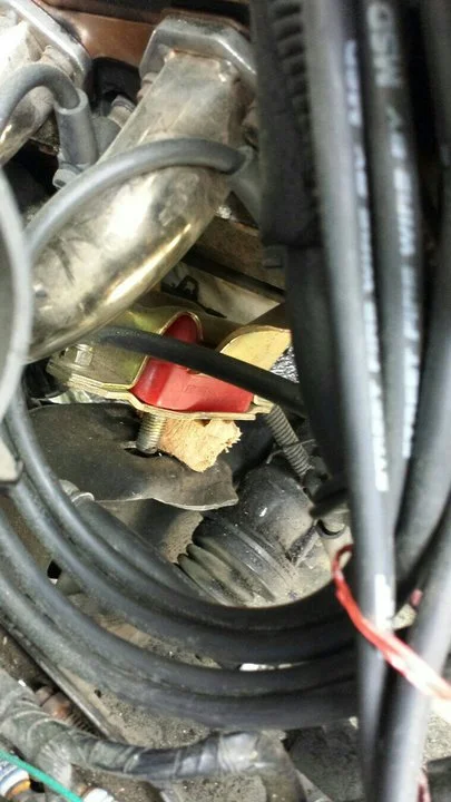

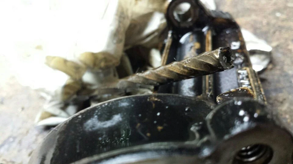

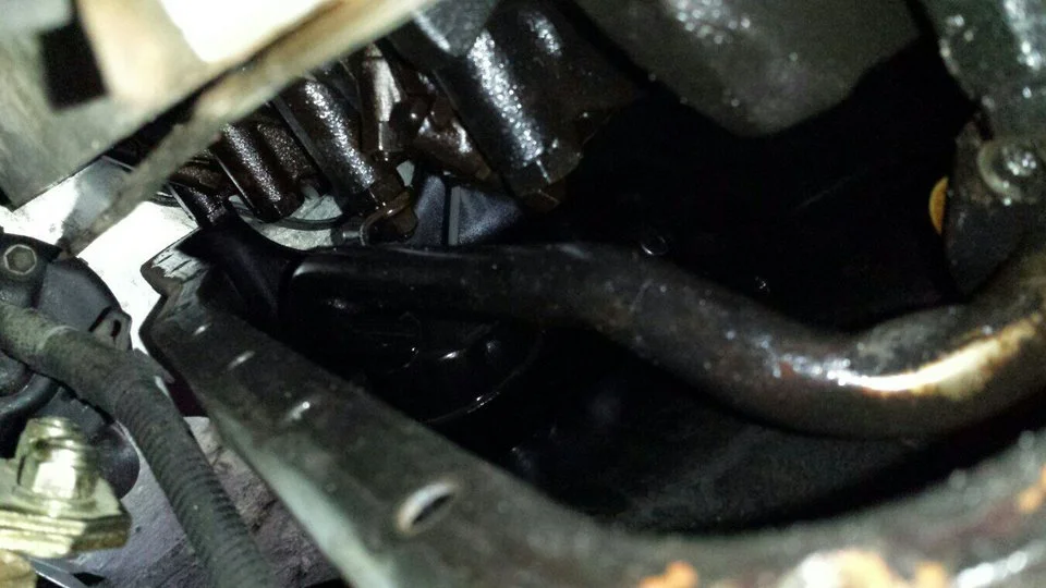

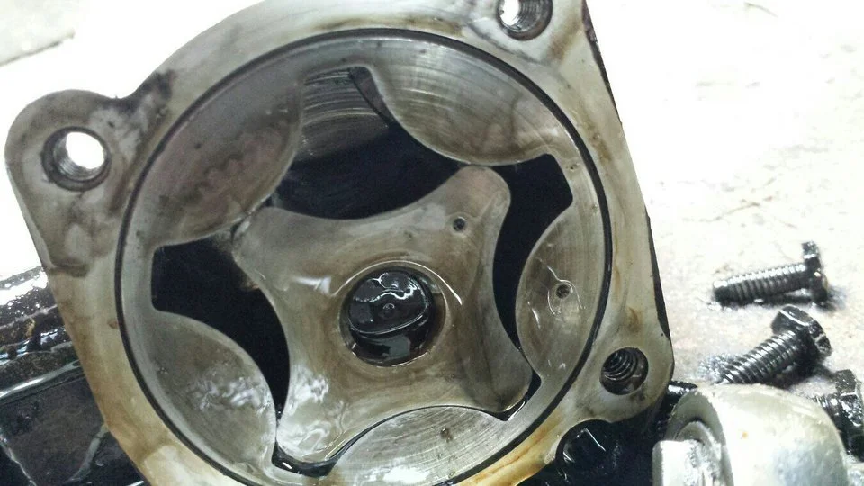

Well I did the near impossible lol. It's not as hard as made out to be, but definitely no cake walk first time around.
The original for pump locked up, and broke the shaft. Putting in the new parts tomorrow.
