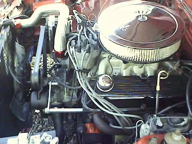

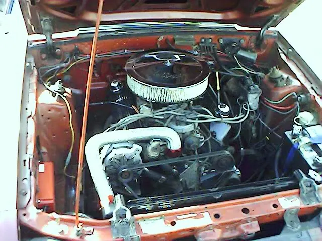

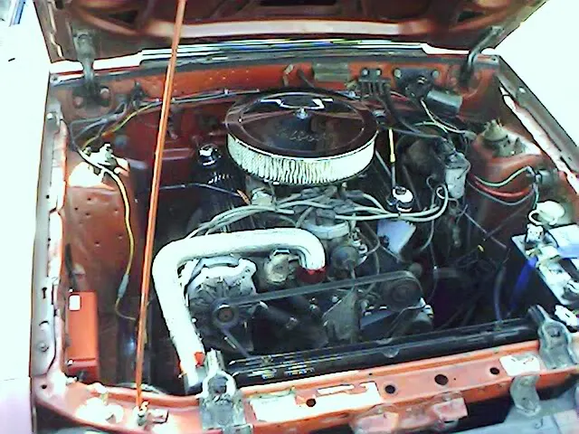

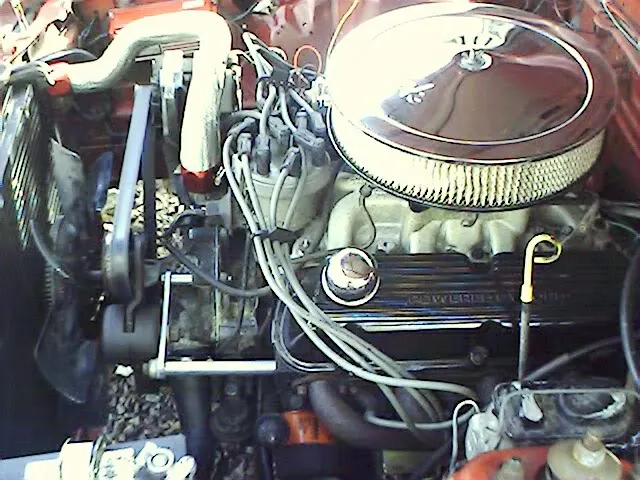

yup i run that setup, i bought the march ac delete kit from summit and it has provisions to delete the powersteering as well, here is a pic of my setup,
the silver pieces are the march ac delete kit

I wouldn't spend the money on the March AC delete, it's not worth it (I tried it). I went with a www.stewartcomponents.com standard rotation water pump ( any standard rotaion pump for a 79-85 will work) and a ASP grooved water pump pulley. If you have underdrive pulleys you'll probably need a 44.5" belt. I have an overdrive alt. pulley so I used a 43.5" belt. You can check "my garage" or my stangnet sit for pics.
