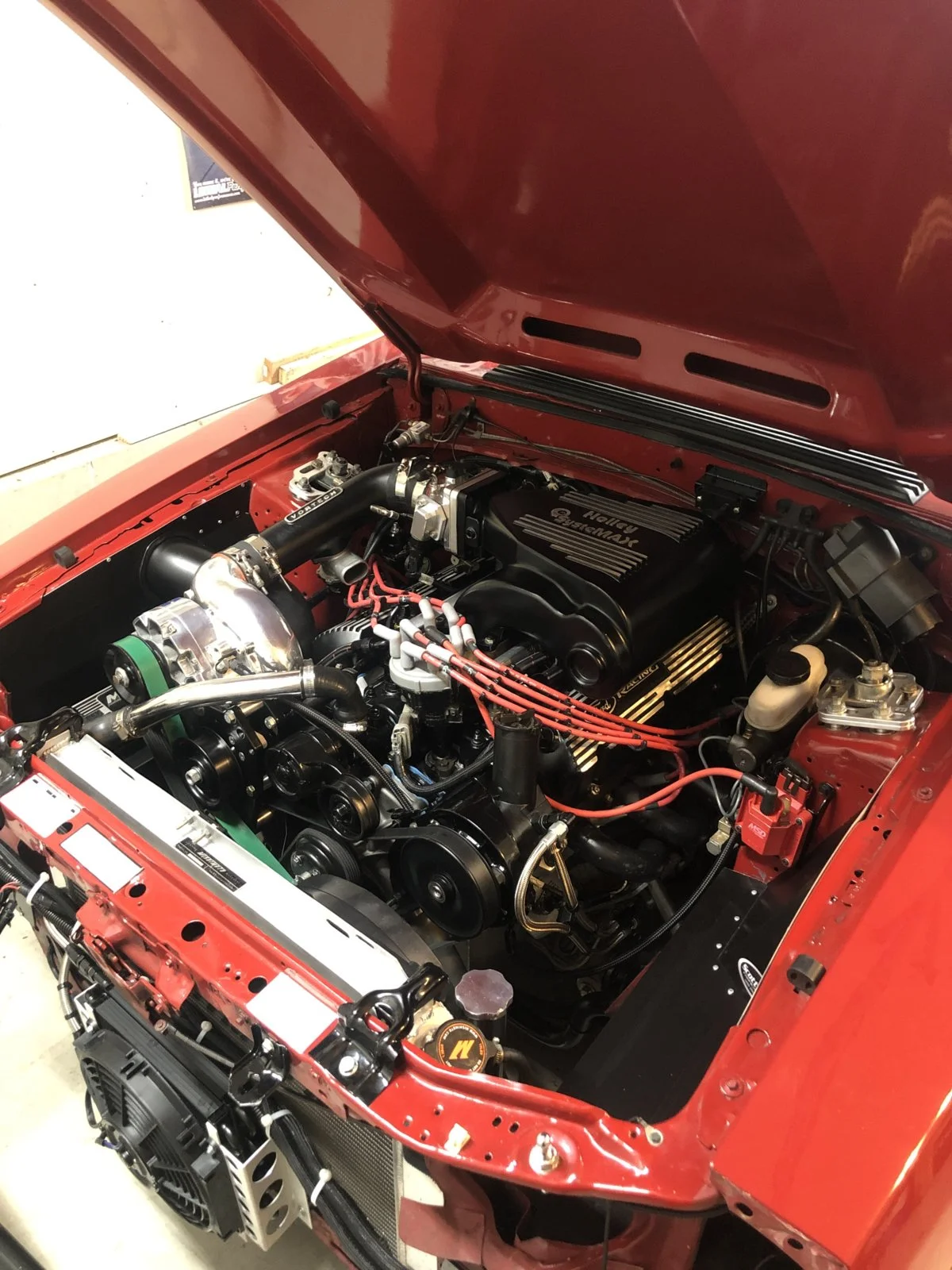

I have their fittings in the rack . High pressure is a fragola crimped line .
Low pressure an old return piece of fuel line . No leaks . Pump just has an earls adapter fitting with a 90 on it
