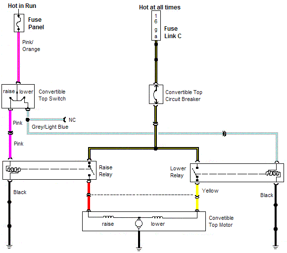

My 89 GT Convertible has been running fine. Yesterday I got in turned the key and ... absolutely nothing. I checked the battery, which is new, new positive wire, new solenoid and even a new alternator. OK, battery was low so put a charger on it. Charged up quick and still no power. Took Positive cable off and the battery showed power, charged it and it came up fine, put cable back on and ... immediately it dropped. OK, took cable off, charged it again, put the cable on and quickly hit a door lock (electric) it moved slightly and .. battery nearly dead. OK, the key was not on or even in. Nothing works. It seems there is a dead short, a major one. One possibility is the convertible top motor which the other day struggled to get the top down and up. Is there somewhere I can take it out of the circuit. The connections behind the seat do not want to come apart and are very hard to access, is there another point I can take it out of the circuit? Is it possible it is drawing power and killing the electronics or ....... where else can I look?

Diagrams courtesy of Tmoss & Stang&2birds
Convertible top wiring diagram

Typically it is something draining the battery. Small things like glove box or courtesy lights are often the culprits. If you have an aftermarket stereo or alarm system, it is also suspect.
The ideal method is to disconnect the negative terminal, and connect a Digital Multimeter (DVM) between the negative terminal on the battery and the negative cable. Set the DVM on a low current scale of 2-5 amps if it doesn't auto range. Watch the current draw, and then start pulling out fuses. When you see a sudden drop in the current, that circuit is the likely culprit. Note that the computer, radio & clock will draw less than 1/10 amp to keep the settings alive.
