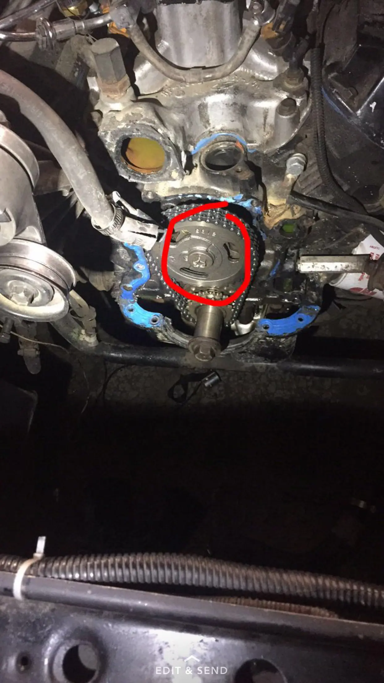

Hey everyone I'm new to the stang net and just recently bought a fox. It's a working project. I'll start with some background to help explain my scenario. Bought the mustang running rough, looked it over and realized the drivers side up stream o2 sensor was cut off. So I replaced the o2 sensor and also wired in the new female connections for the o2 sensor to plug into the harness. I fired it up, it ran for about 5 seconds and made a bang and lost spark. Ever since then I have had no spark. I've since then started with the coil. Nothing. Then I checked the distributor for timing. Then I also replaced the TFI sensor on the side of the distribulor and Still nothing. I'm not sure if I may have mis wired my o2 sensor and it is causing the no spark issue. Thanks and sorry for the long message.

Yes it's a 90 gt manual. I have unplugged the sensor I even unwired the new plug. I'll check that no start check list. I have power in both terminals at the coil. Nothing after the coil

I Figured out my issue. Finally after hours. So the previous owner told me that he had installed a cam. Well apparently he never tightened down the cam timing chain gear. It slipped right out of the keeper. And crazily enough this issue happened right after I had replaced the O2 sensor wiring
