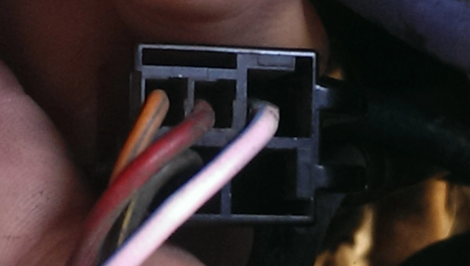

One thing I did find this afternoon that confused me at first was low voltage at the fuel pump relay (1.5v), both sides of the associated fuse link have 12.3v. I had checked the reset button on the inertia switch when I put the new pump in, but I neglected to check the voltage on either side of the inertia switch. The fuel pump does prime shortly so I hadn't thought much more about that side of the fuel system, but I'm starting to think the inertia switch is only intermittently working or that the hot wire going to it is grounding somewhere.... So that'll be on the agenda tomorrow as well.

From what I can tell, my issue seems to be surrounding low voltage @ the fuel pump relay. Everything else seems to check out good.
With the relay disconnected from the harness, I back-probed the harness And showed 12.6v @ the Red wire (key on) and 0.1v on the Orange wire. I'm assuming that the Orange wire should be 12v constant, bit I've found conflicting wiring diagrams.
Do you know if the Orange wire should be hot at all times?
And if so, does anything other than the fuel pump run off of it? Im thinking it would be a lot easier to route a new wire than tear the harness apart to find the defect.

I just realized I've been checking the WOT AC Relay.
ID89GT
May 26, 2008
1,659
18
49
Spokane Valley, WA
Apr 2, 2014
  • Apr 2, 2014
Fuel relay is probably under driver seat.
Reactions: NC Firefighter

It was. In my frustration, I overlooked it somehow.
