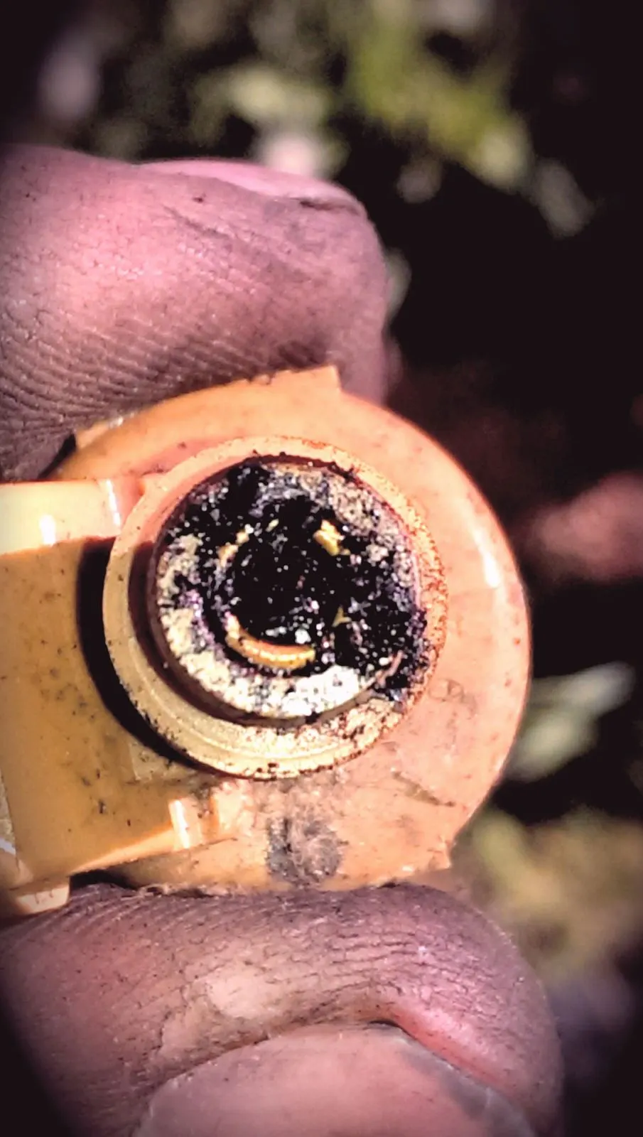

Found the problem.... Junk in the injectors

That's pretty close to what I said.... Lol.
Looks like fine rust particles, must have came out of the old tank. I'm guessing the the new fuel pumps flow dislodged it from somewhere in the fuel lines.
Now for cleaning the fuel lines and new injectors and maybe fuel rails.
