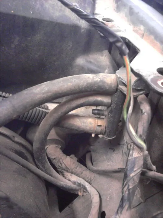

As far as vac leaks I have this
but it i just plugged it. It doesnt appear to go to anything.
LOL. Ok, that's a significant vacuum leak. There is supposed to be a small hard plastic line that goes to that nipple, and runs along the firewall. It goes through the firewall near the air conditioning pressure lines. That vacuum line goes to the HVAC box and provides vacuum for the vacuum solenoids that control which vents the air blows out of for your A/C.

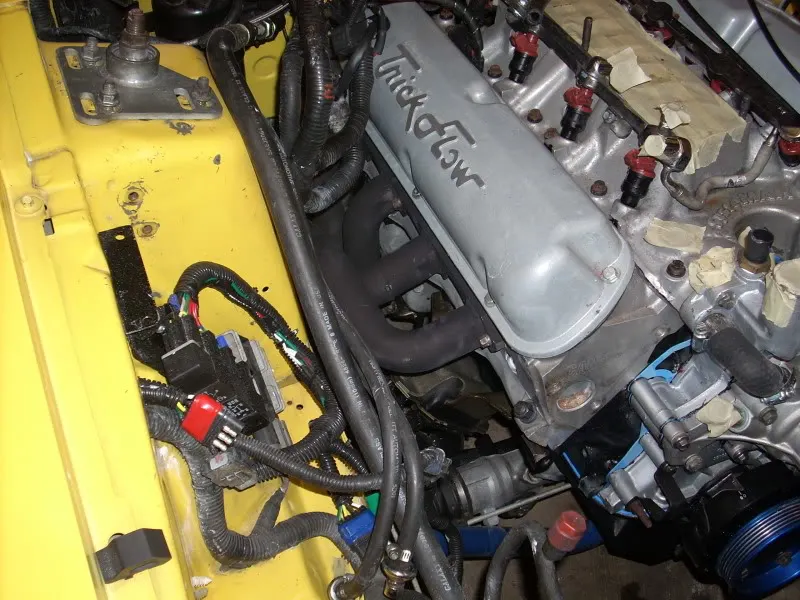

Here's a picture. I didn't take this picture specifically to illustrate the position of the temperature sensor, but you can see where I stuck it in the top of the water outlet. I wasn't sure if it was going to work, because it won't show proper temperature until the thermostat opens up, but it's never been an issue. The EEC seems to stay in a cold condition operation until it gets above the temperature the thermostat opens up at anyway.

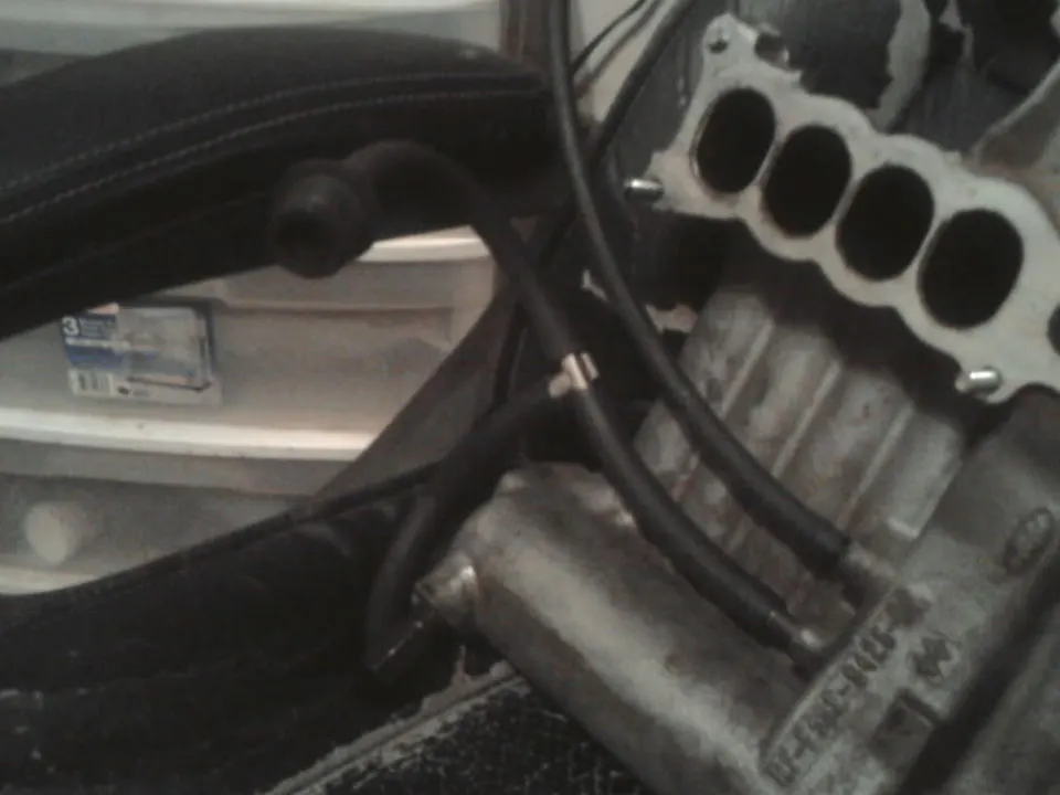

Went to install everything today. found that my T stat housing akso has a bung that the ECT fits nicely into so it will be installed there tomorrow. Got to looking and the ect where it was on the intake wasnt the worst of that proble. But they had also when they extended the connection used the wrong plug, it fits over the connection backwards so it broke the terminals inside of the new ECT. I ordered a new plug, bought a new ect will be installing both along with the IAT in hte morning reinstalling the upper intake blah blah. Any way will let those of you attempting to help me know the rsults, I'm hoping this clears my problem up. Also I have taken a pic of the vac lines under the upper intake, Im just wanting to know if they are all routed correctly?
