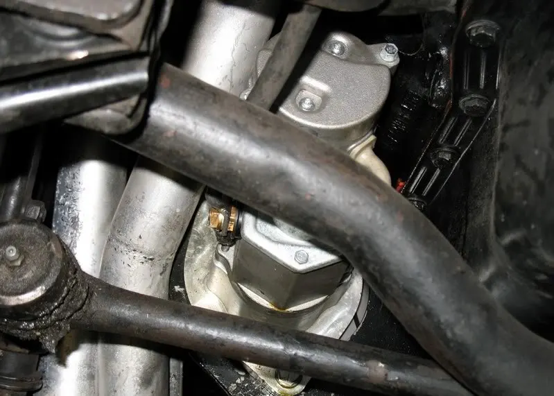

Mrfixit hit it right on the nose. The tubes are closest in the vicinity of the upper control arms and that is where I did my clearancing. You will gain a better access to the plugs, but you still won't be able to get a ratchet on all of them since the tubes themselves can get into the way.
Plug access with the Accufab's really isn't horrible if you use a short, thin 5/8" spark plug socket AND it has a head for a wrench. I need to remove 6 of my plugs that way because I can't get a ratchet on them. I can R & R a cold set of spark plugs in about 20 minutes, including setting the gap. I can also do them hot (obviously not quite as fast,) but I need to wear the proper protection to keep from getting burned by the headers.
Since it sounds like you will have the engine out, I suggest mounting the accufabs to your motor to test their fit. This is the best time to check if you can install all the header bolts (may need to enlarge the dimples) and to make sure that you can install your spark plugs. I am certainly glad that I did this step first!!!

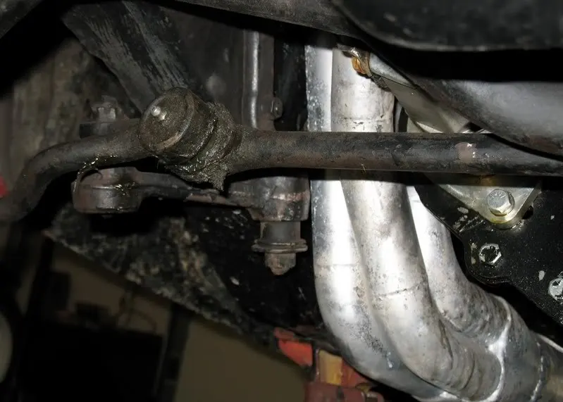

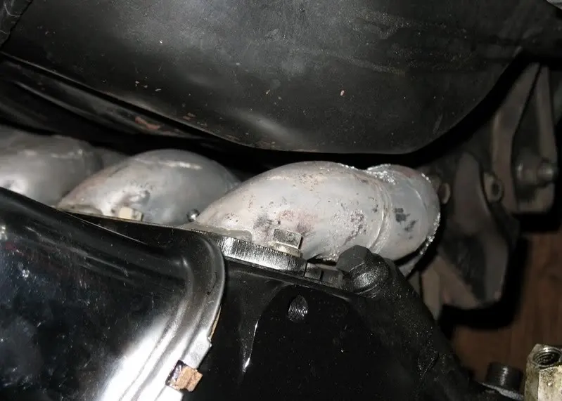

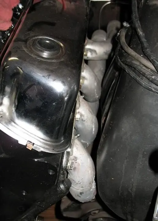

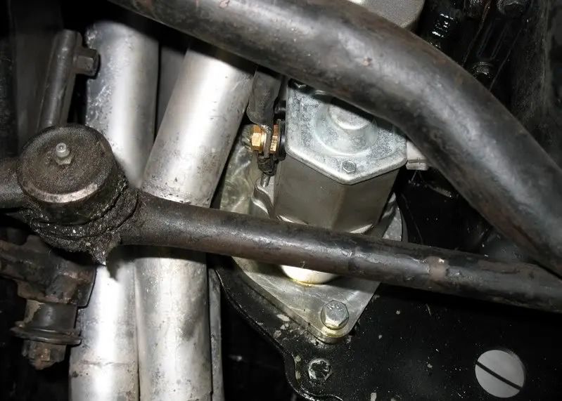

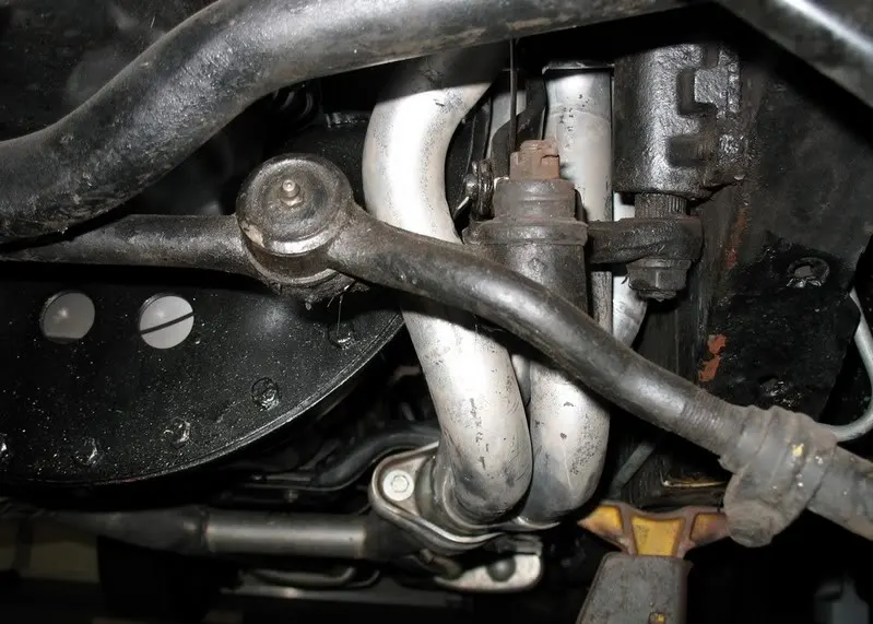

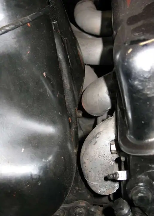

I am afraid that you will only be guessing if you do it it in advance and it won't be right anyhow. My headers were first installed without any dimpling and they just touched the shock towers. Hard drag runs starter to ding the headers and that is why I decided to just go ahead and ding the shock towers to prevent more crushing of the headers.
The Accufab swap headers need installed after the motor is in the engine bay. You will need to raise the motor somewhat to slide them in place from underneath. Do not install the starter until after the headers are installed. Also don't be surprised it you need to move on to a mini starter like I did because it was very hard to install the factory unit.
I had no problem with the passenger side motor mount, but needed to trim the driver's side. I then built a heat shield to protect the rubber. The passenger side was a little harder to install, maybe because I did the driver's side first. If you have a manual tranny and want to use the factory Z-bar it is doable with a couple of tricks. Otherwise it will seem impossible to install.

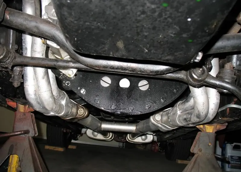

Here are a several pics of my swap headers installed:
You can see some of the dimpling of the shock tower for the front tube in the following pic:

dennis112 said:
Pics if the headers by themselves can be found here: dennis_8047/Accufab Headers and Exhaust - Photobucket - Video and Image Hosting
A roller idler arm will help a lot with the steering. Those rubber bushing units are horible.
