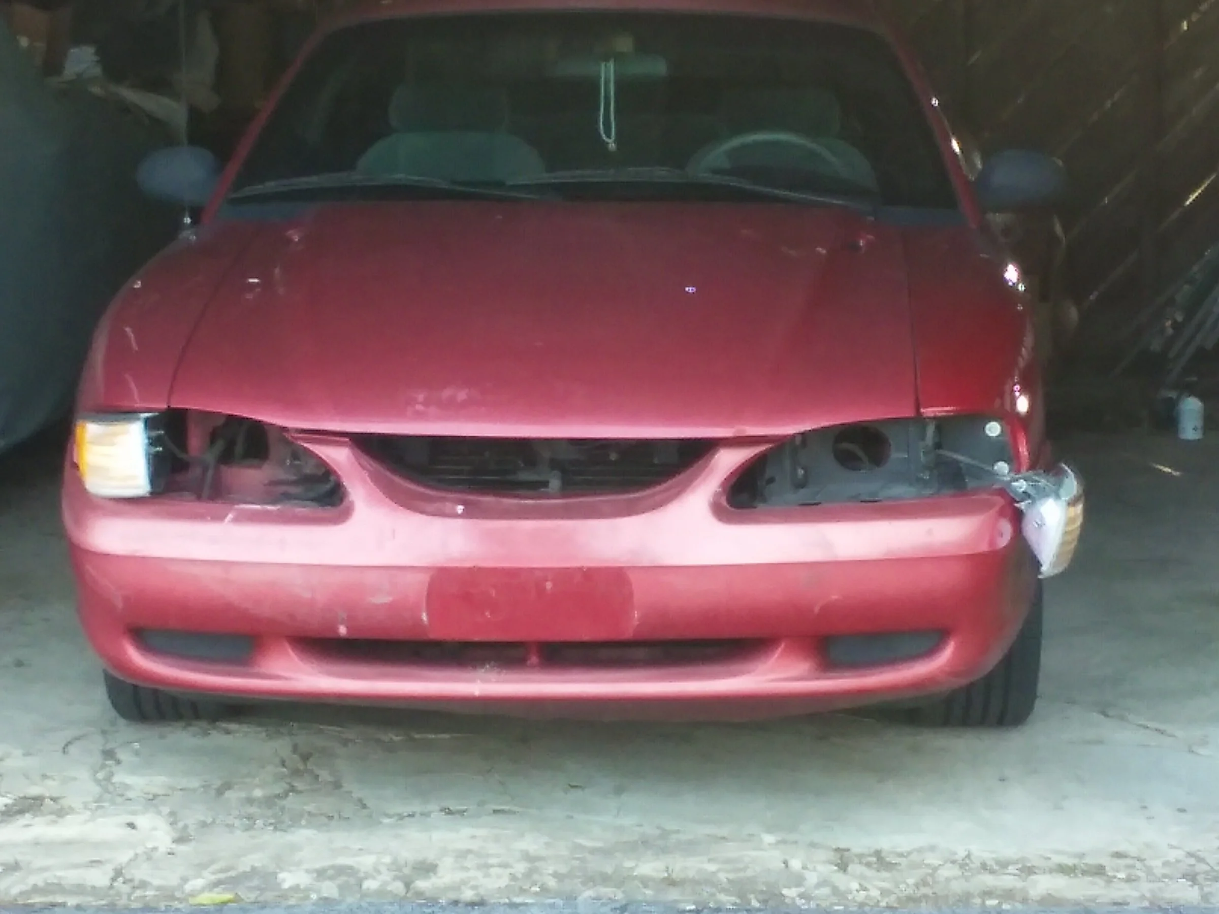

Thanks guys, that will be easier to do than shipping it to someone in the next state to repair. On to the next problem. I smashed the front end yesterday and busted out the plastic substructure (?) behind and around the lights and pony. Is this one piece or separate ones? Y'all are awesome.
