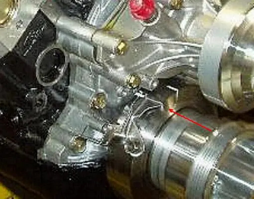

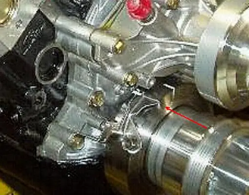

IS IT BETWEENTHE TWO ATTACHING BOLTS OR ABOUT 1 1/2" TO THE RIGHT OF THE TOP BOLT? PICS WOULD BE A BIG PLUS.
THANKS GUYS :bang:
Here is a shot of mine.
To make sure you are using the correct marks, bring #1 up to TDC compression with the spark plug out.
This is what mine looks like. Use the tip at the top of the pointer, not the center or bottom holes.
