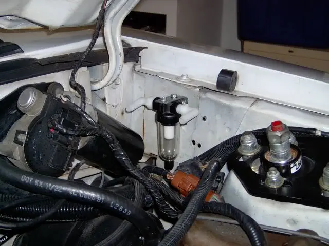

The quick version (last one I did was on my '94 so YMMV, but you know the 5N95's anyhow). Get some 3/8" fuel line (I used hydraulic line, which was a pain since it is so stiff. I was concerned with fuel line crimping as it goes around my STB). Grab a separator of your choice. Grab fittings (my separator had 1/4" NPT threads, so I used a fitting with 1/4" threads and the other end had a 3/8" barb. I used fittings that turn down 90* for packaging high on the SN95 firewall). Remove the OEM hose from the PCV valve. Run new line from the PCV valve to the inlet of the separator. Run a new line from the separator outlet to where the OEM PCV hose used to connect (A tee fitting behind the plenum, in my case). Mount the separator (there are two bosses in the top of the unit I used, so I tapped one and made a bracket to hold the separator and mount it to an existing firewall fastener).
Like I said, I removed the element in mine, as after about a teaspoon of oil was caught, the element started to clog.
That's about it.

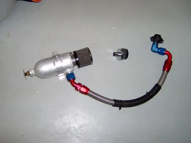

Here's a pic of my old set-up when I had no PCV
Here's how it looked on the car. You can barely see the
tank done by the smog pump eliminator
Here's a pic of my new air/oil seperator, as I decided to go back to a PCV system
