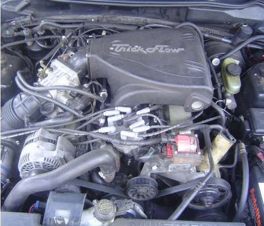

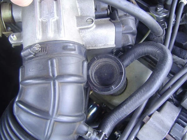

here are some pics of the engine bay and oil fill spout

I am curious as to why you are having fitment problems to begin with. I dont know how different the throttle location is with trickflow vs edelbrock but on my performer 5.0 intake I was well within room. Also, the rpm that I am using now moved forward some but still gave me plenty of room.

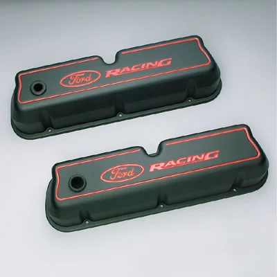

Well I was looking at getting the FMS Tall VC with the pre drilled breather holes but i was wondering about the PCV tube that goes from the VC to the intake tract (it is circled in red on the pic. Can I use a regualr breather with that and cap the tube, or is that a bad idea. I have also seen Breather caps that have a nipple on them can I use that instead. Please does anyone have any experance to share with these VCs. ANyone know what size (or part numbers) breathers I need to use with these VC?
Use this and you'll be square:
http://www.fordracingparts.com/parts/part_details.asp?PartKeyField=482
Could you put a little heat to the tube while bending it? It doesnt seem like you need to bend it to much. I just installed fox vc on my set up to clear the 1.72 rockers. I had to grind the inside of the covers and grind my oil cap tabs off. I also had to grind the bottom of my egr and intake and install a 90 degree elbow for the vacum hose on the driver lower side of my Cobra intake. It was a lot off modification but didn't have to get a spacer and didn't have to modify my surpercharger tubing and didnt have to spager my egr tube. Check out my thread under painted valvecovers and intake.
