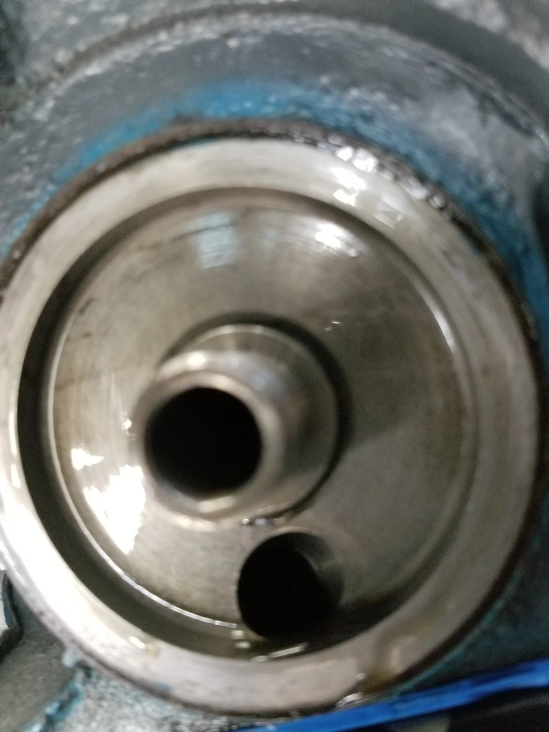

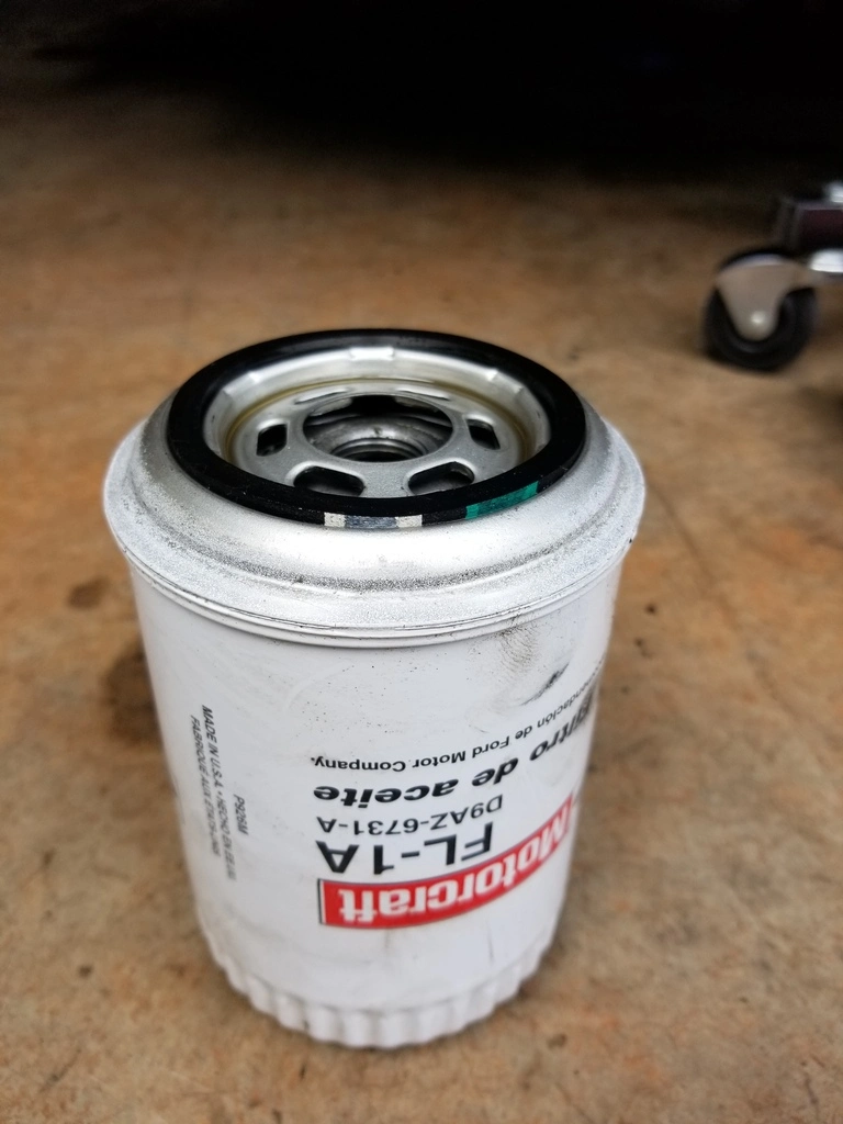

I just put this engine together (It had recent rings but otherwise stock). I can tell you I don't know what oil pump it has etc. as the only thing I did to it when I got it was bolt on the heads and upper half. I have ran the engine at idle several times for a total of probably 15 minutes. I went to change the oil filter (which was new when I fired it up for the first time) and this is what I found.
It looks like pressure built up in the filter?
Car starts and runs fine, and sounds normal. Oil pressure (by stock gauge) is right in the middle.
Any idea what is going on? I JUST finished putting this together and hate the thought that it has to come back out.....
Chris

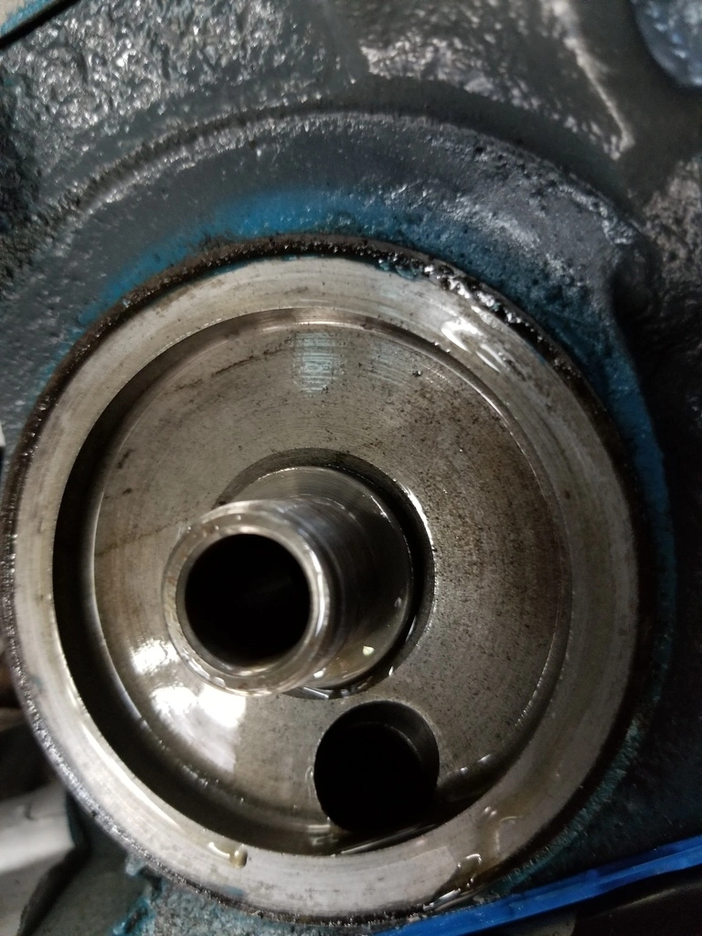

I looked where the filter goes on and there is a hole with nothing in it? Isn't this where the pressure relief valve goes? If yes, where can I get one and how does it install? Sorry about the questions, never dealt with this type of issue before.
