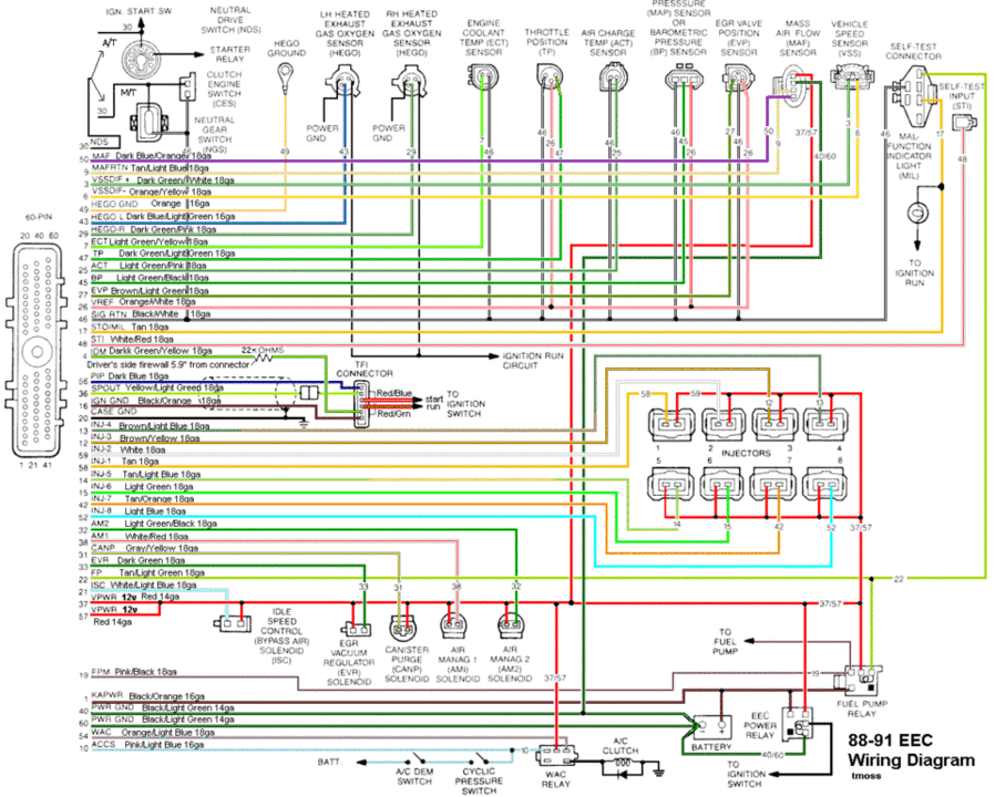

oil gauge?
There is no connection between the computer and the oil pressure gauge. Check out the
diagram and you won't find an oil pressure gauge on it.
See the following website for some help from Tmoss (diagram designer) & Stang&2Birds (website host) for help on 88-95 wiring http://www.veryuseful.com/mustang/tech/engine/ Everyone should bookmark this site.
