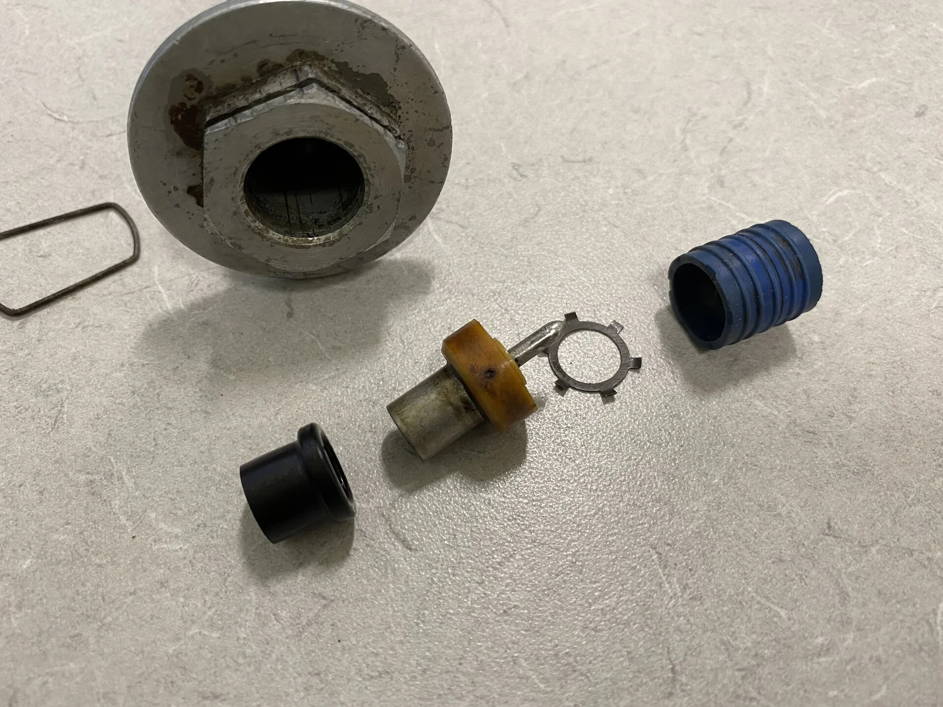

I'll have to pull mine apart again but it didn't have an O-ring. It had a clip that was retaining a blue rubber cylinder that created the seal. I was hoping for an O-ring.

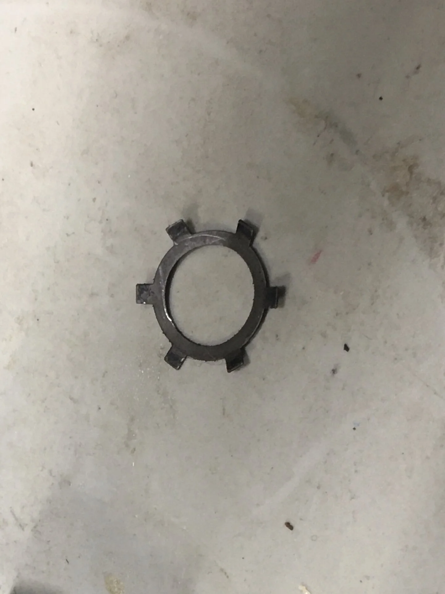

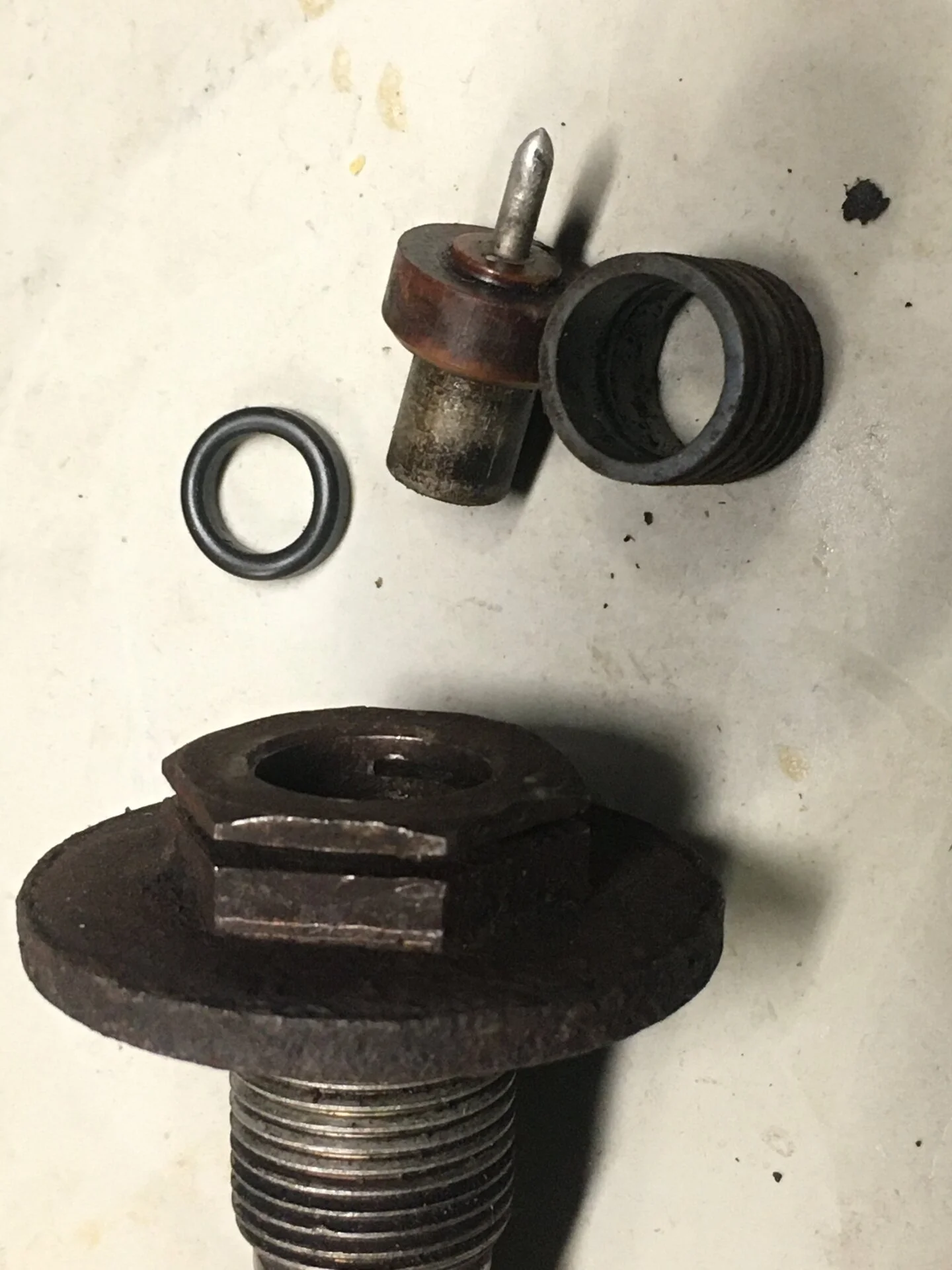

The blue plug and the clip is for the wire connection. You need to take the sensor apart and change the o-ring inside the sensor itself. I have a spare one somewhere. If I find it I’ll post some pictures.
Here is what the inside looks like. You have to bend the tangs off a star washer to release the sensor from the housing.

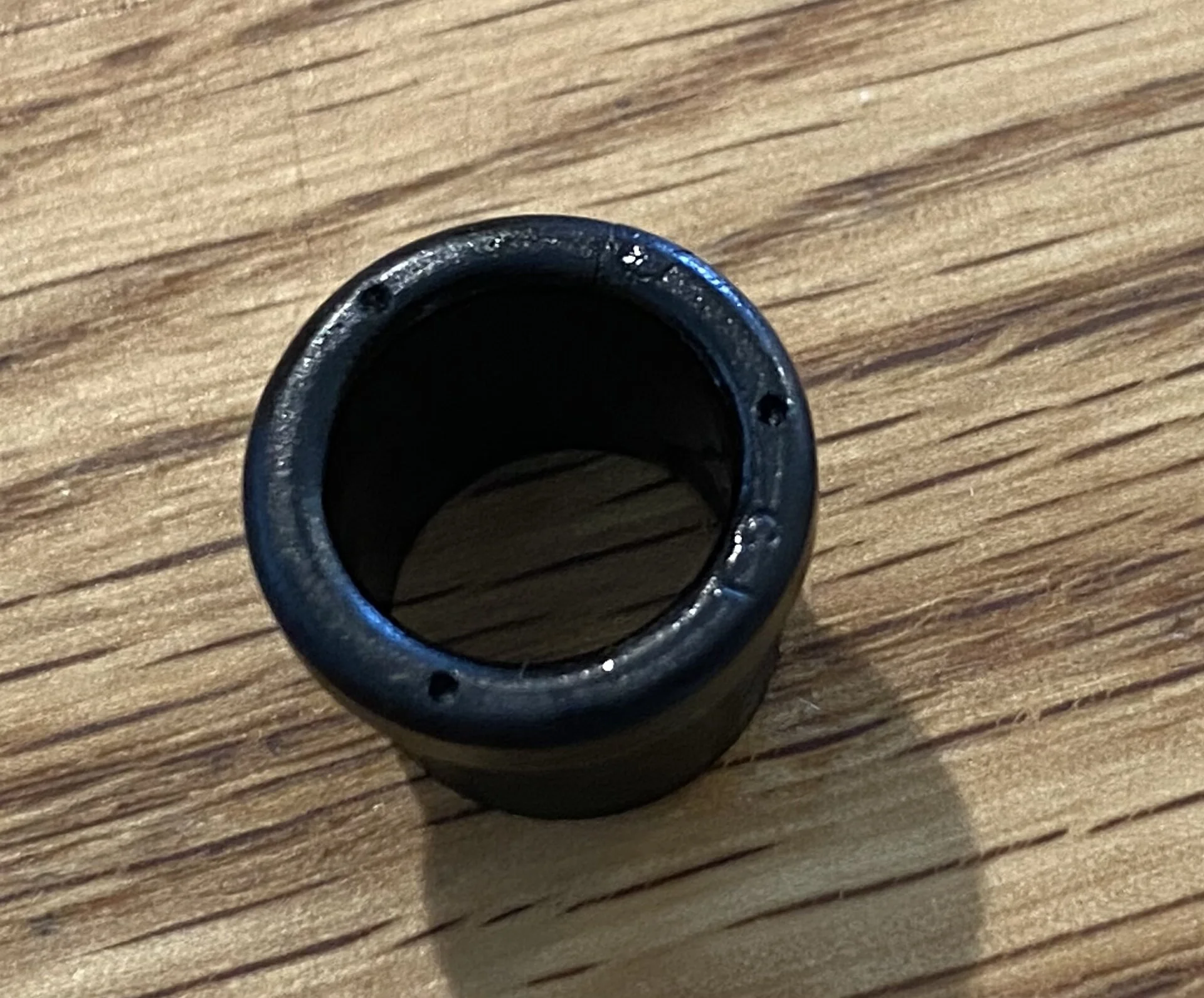

No o-ring on mine. It has a black hard plastic sleeve at the bottom of the sensor probe. There’s no o ring inside anywhere.
This is the original sender on the car so i'm the only person to ever pull it off and disassemble it.
I think there are two kinds. One has an O-ring and one has that sleeve which has a built in o-ring up top. I bet that sleeve was softer at one time too. You should be able to take that plastic sleeve off and replace it with an o-ring. Mine had just an o-ring. No sleeve.
The black part is definitely a plastic molded part. You can see molding indications and a number in it up close
