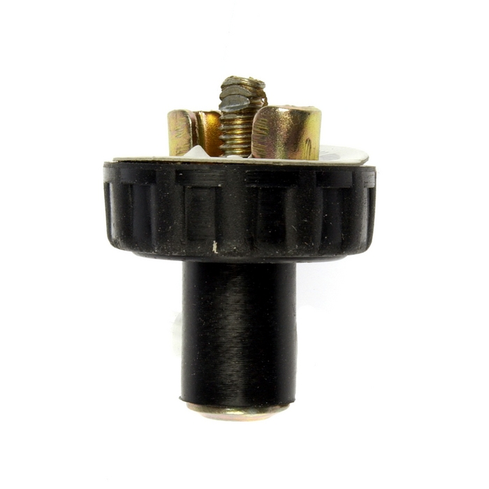

You can also buy a rubber oil pan plug that will fit into the drain plug hole. I've used them on stripped plugs and they do the job. Very easy to install/remove.
