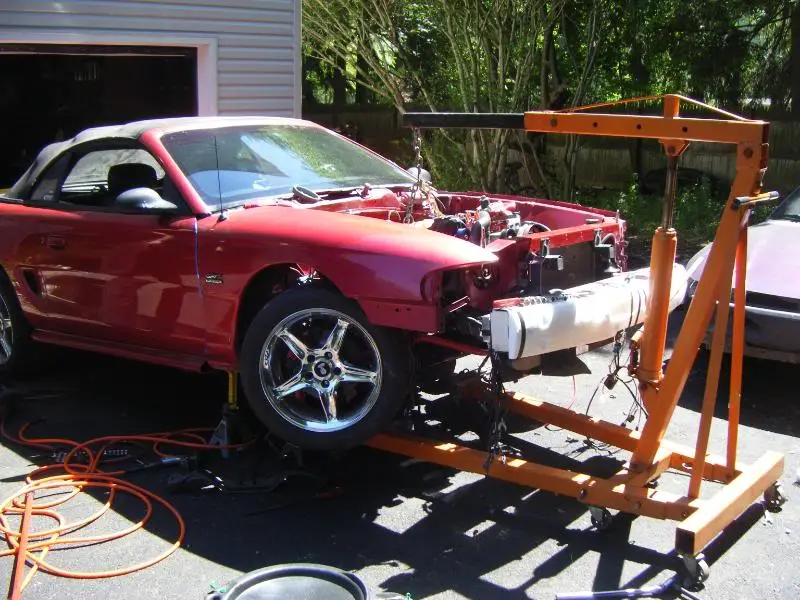

+1, it may just need a new gasket. You can drop it enough to get a new gasket in. Felpro makes a nice one piece with steel reinforments that usually come with a set of plastic dowel pin type hangers that go into the pan mounting screw holes and will hold the gasket in place while the pan is raised into place. You can also gain a few inches of clearance if you use a hoist/cherry picker and unbolt each motor mount bolt on each side and raise the motor a bit
Hoist motor, Pull rack forward, and you can get it off.
