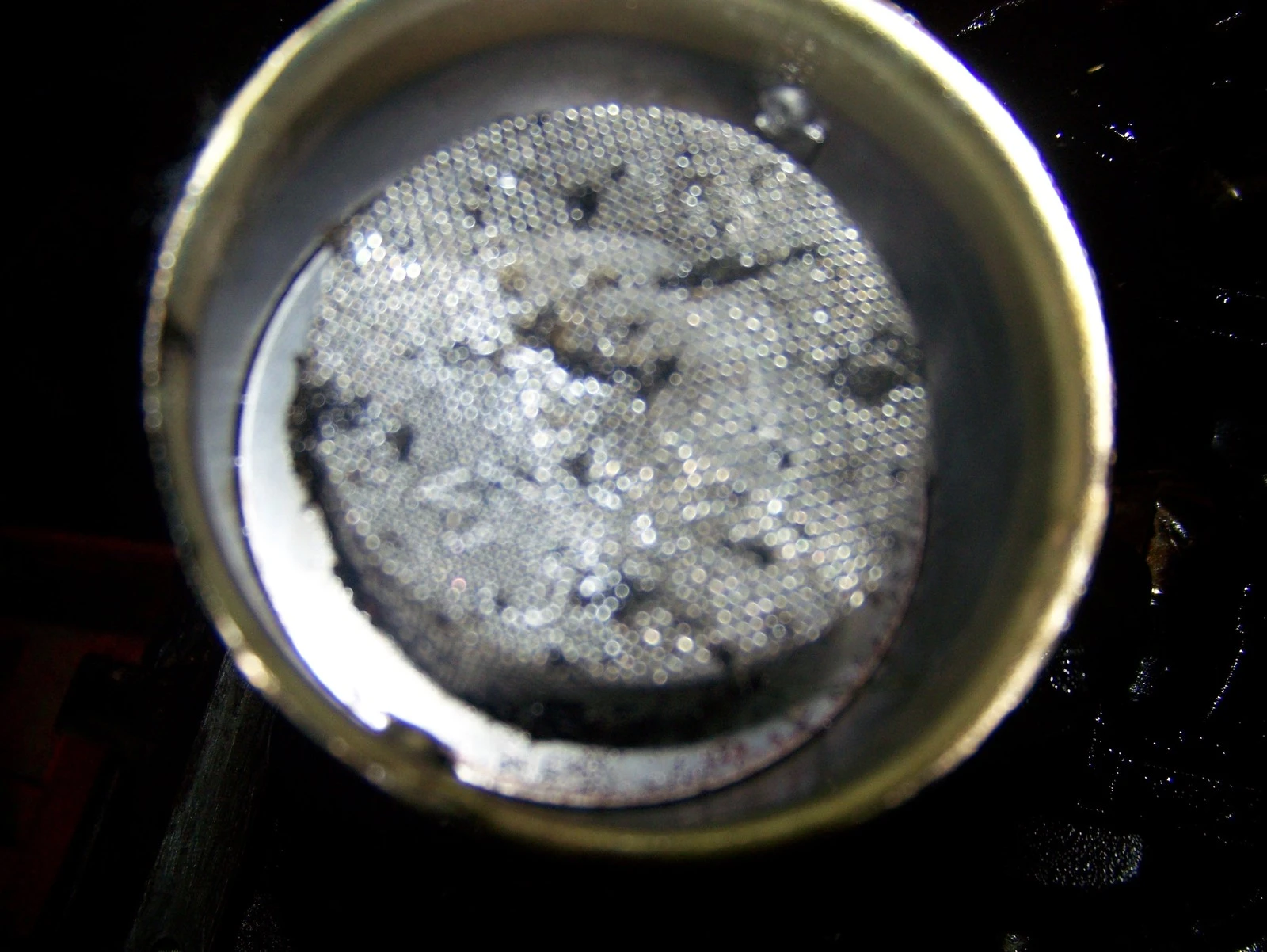

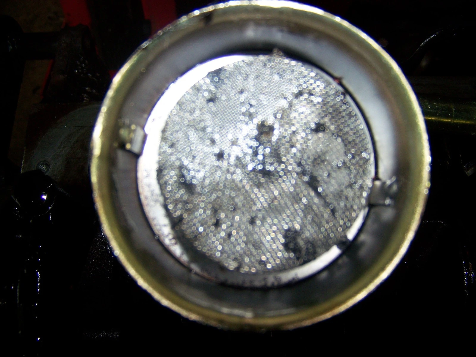

I got the motor out tonight and there is a little crap on the screen, not a lot but some small pieces that look like bits of silicone or gasket scrapings that I did not get out of the bottom end before putting it together. There is also a reddish color on the rod caps, I am assuming it is from the assembly lube I used putting the cam in, I didn't get the main caps off, it was almost 9pm so I left that for tomorrow. I did check the height of the stock pump and the new one and they are about the same, the new one might sit lower, I'll measure tomorrow and make sure it isn't sitting on the bottom of the pan.
Yes, got a few.
