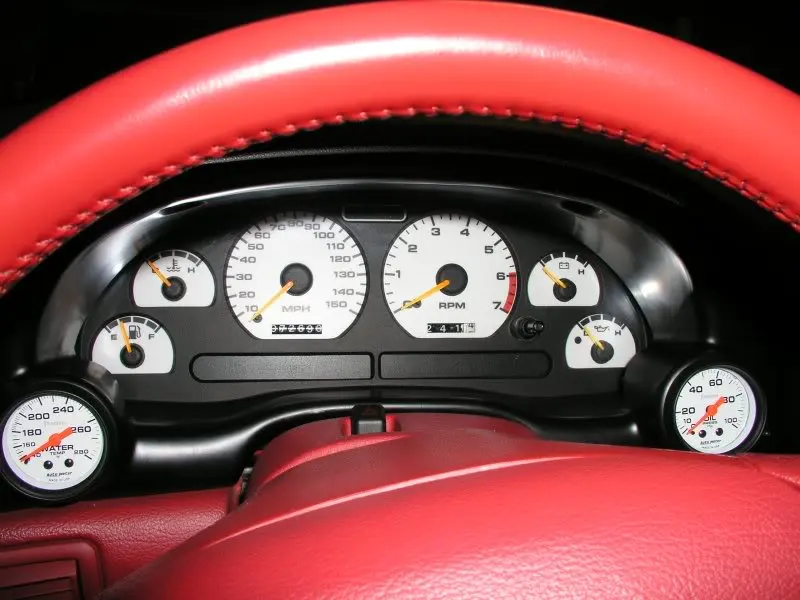

I've got some pictures of my factory gauge reading on the lower 1/4 of the gauge with my Autometer reading 29psi at idle and then 40psi when I reved it. The stock gauge showed no change (no surprise).

That's what I did. I put the 2 gauges in the Autometer gauge bezel. :nice:

illwood - that guage setup looks really nice. I might look at doing that myself, cause I'm sure the stock Temp guage is probably nearly as bad as the stock oil pressure guage.

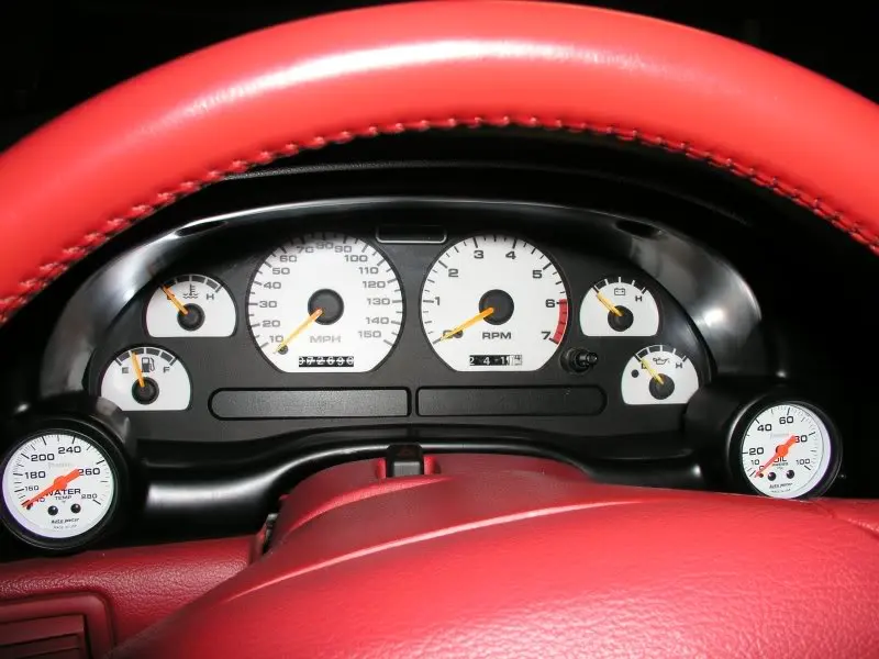

The stock oil pressure gauge blows dong. I stopped paying attention to it a long time ago. I believe the gauge in my F150 has the same design, dead nuts in the middle, or off, giving me a red light. A small revving of the engine makes it go away.

Good call - the stock temp gauge is just as useless.
For both gauges and a first time install, give yourself an afternoon. I'm pretty proficient but Illwood makes me look like a piker in terms of install-time. I spend a couple hours doing an oil and water gauge install. I spent a chunk of time just removing the ground in front of the oil sender so I could remove it.
