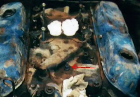

Sorry to hijack, but now that we know where the oil pressure sending unit is, could you point out where the water temp sending unit goes? 65 289
Screws into a hole in the intake, near the thermostat, I think.

Here is a pic of mine during teardown a few years ago:

So it looks like I may not have one, but I could put one in place of this plug in my manifold? My intake is some Edelbrock performer 289 or something like that:
Yeah that should do 'er.

I have the same manifold and that's where mine is.

Hey thanks guys. Maybe I'll throw one in one of these days!
