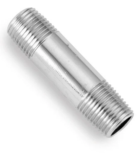

Relatively simply. Look on drivers side of engine. Small little bell shaped sender with a single wire just ahread of the headers.
it's all 1/8" NPT. Just remove the sender and put in an extension, and a female tee. Then screw the stock sender in, and the aftermarket sender (mechanical or electric) and call it a day
1/8NPT extension
1/8npt female tee
