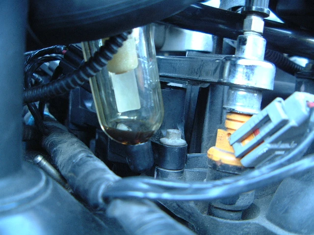

So after 70 miles and 5 times down the 1/4 mile, this is how much oil I got.
Anybody else have a oil seperator? Is this the amount you guys are getting?

I had one that size. The funny thing was, mine could never get more than 1/2 full - the intake was able to suck up the oil. I installed a larger one and it does catch more. Now I don't have to empty it all the time. Plus, I routed the hose (not zip-tied) so that I can empty the oil separator into the oil fill for the engine.

Those are only needed on eaton/twin screw type blowers that have an intercooler. Even those type of cars, my tuner said he doesn't waste his time cluttering up the engine bay with hardware store parts. I was gonna do one, but he said of the 100's of Whipple's he has installed not one got a seperator.
