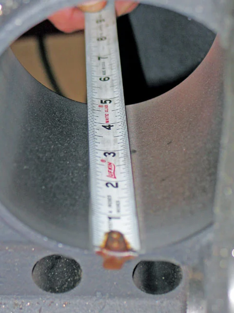

I'm just saying, that before article came out, or I measured, I saw it was shorter. With no preconceived notions before I saw the block. It stuck out like a sore thumb. I'm not guaranteeing anyone to have motor problems, but I wouldn't run one. This style motor has been around a while now, and with what we've learned about them and any other motor, the shorter sleeves, can't be good.(Ford has done many a things that boggle the mind. This would just add to the list. It's a good thing this place wasn't called Mustangnet.com a year ago huh ?)

No one has said it can't be done. Custom pistons would go a long way to fixing the problem. All I said is that it could cause a reliability issue. There is a big difference in building an engine for a magazine spread, and building an engine that will have some longevity on the road.
As for him calling BS in the link you posted, if you keep reading there is a post with a link to some pictures that plainly show the shorter cylinder.

Maybe he doesn't know how to use a tape measure. Everyone measures them shorter but him ?
But quite honestly winning a competition like that doesn't prove to me it won't have longevity or reliability problems.

If you tell someone what I'm telling you, it's hearsay. What I am saying, is from the horses mouth. "I" have personally seen them. Again, not saying it WILL cause problems because nothing is concrete. But I tend to lean towards the physics side, than "Big Joe." Doubt at this point any of the motors are even old enough to show the wear yet.

There is a local speedshop here that had a Boss block on the floor last time I was there. I can tell you that the bores were obviously visually shorter than a stock block. With all this bickering, I might have to head over there on Monday with some calipers and a camera....

Ken, this picture does not support Joe's statement touted above. "That is all B---- S----/ The cylinders are all the same as the stock 302 blocks." Stock blocks have cylinders of 5.125" in length. That sure looks like 4.75". The angle is not great, but it looks like it is shorter than a stock 302. I am not sure if there has been a change in design or what.
Read my post again! I did not state anything about the length of the cylinder wall, just that it was not a problem in a stroker application. If the length is different then ok! what I took from the thread was it was not a problem in a stroked application.

What I've read is that Ford DELIBERATELY made the cylinder walls shorter so that they wouldn't required extra machine work to clearance the bottoms for strokers. So Ford changed the Boss block so it would work better for stroking.

I have read that too, but I am not sure where. If it is true that Ford did this intentionally to make a 347 require less machine work, then they inadvertently chopped off an important piece of piston stabilization. It would have been better if they had cast in the proper notching.
