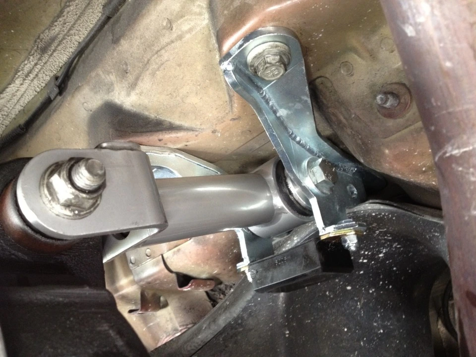

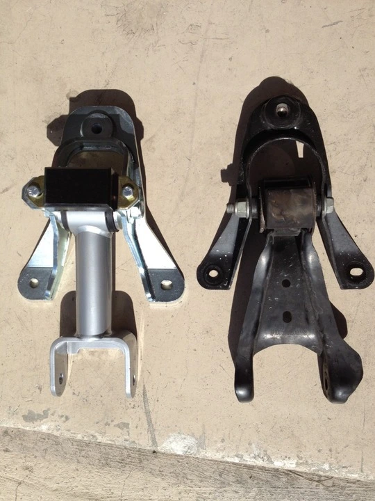

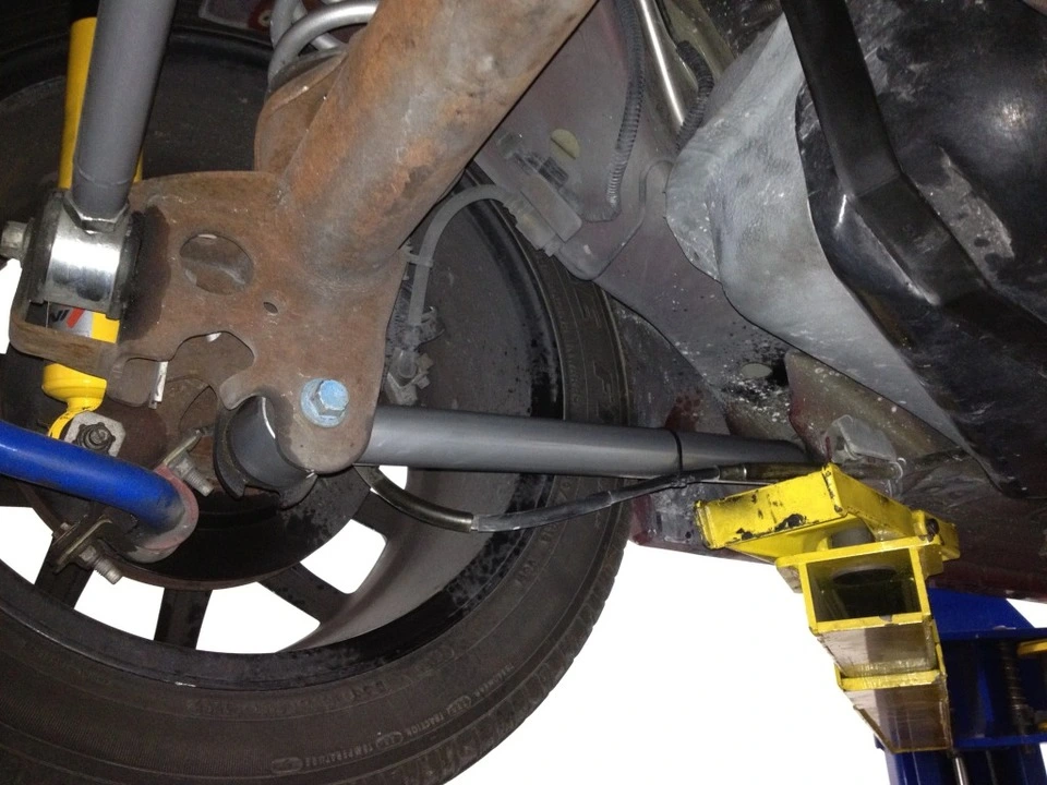

We replaced the upper control arm with UPR's Pro Street UCA and Heavy Duty UCA Mount:
http://www.uprproducts.com/mustang-upper-control-arm-mount-street-silver-05.html
The UCA features the same heavy duty construction as our LCAs, and the HD UCA mount is much stronger than the factory stamped steel piece, so there is no longer flex in this critical area.
Here is a side by side comparison:
And here are the Pro Street UCA & HD Mount installed. Installation was simple and straightforward, but working space is tight around the UCA.

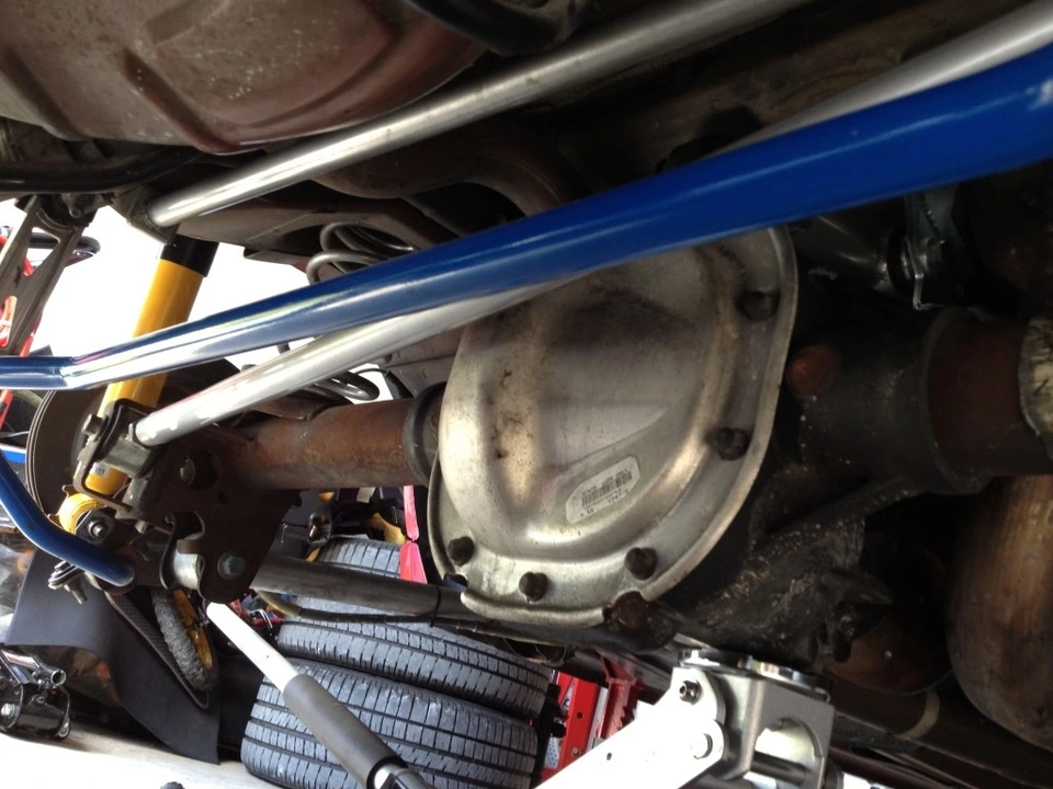

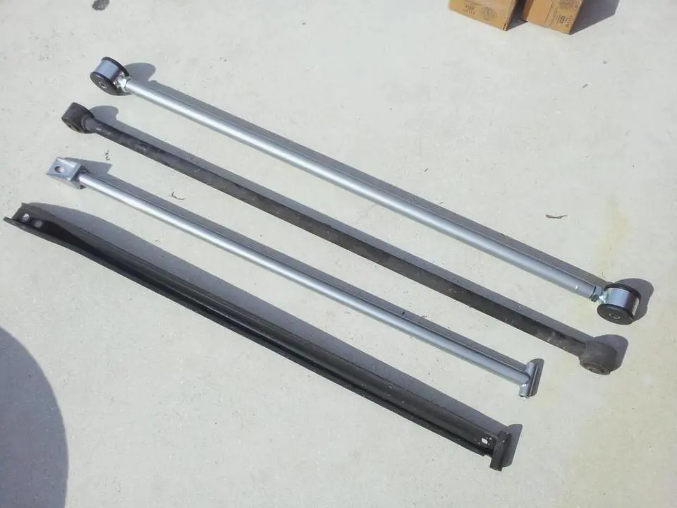

We upgraded the factory panhard bar with our Pro Street chrome-moly double-adjustable panhard bar and we also replaced the factory panhard brace with our chrome-moly brace.
http://www.uprproducts.com/mustang-pro-street-adjustable-pan-hard-bar-05.html
http://www.uprproducts.com/mustang-pan-hard-brace-05.html
The Pro Street PHB is on-car adjustable and features polyurethane bushings for reasonably quiet operation. Here they are side-by-side:
Installation was very simple with hand tools. Here they are installed:
^^as you can see in that photo, we previously upgraded the swaybars on my car during a track test at Sebring International Raceway. Stiffer swaybars greatly improve cornering grip. We recommend these Eibach swaybars:

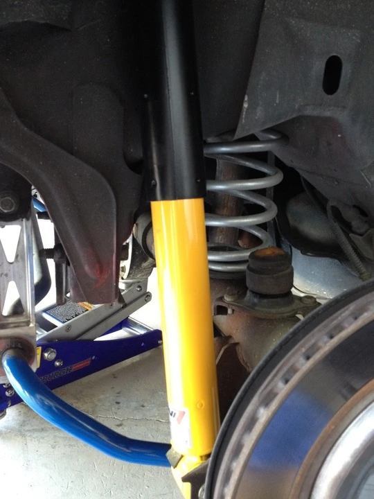

We are still debating which dampeners to offer with our S197 Handling Package. On my car, we used Koni Sport (Yellow) struts and shocks, which work quite well.
The shocks and springs were an easy install. Here's a closer look:

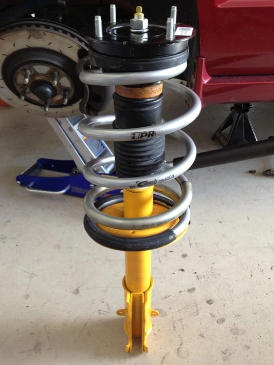

Moving onto the front end, we installed the previously mentioned Koni Sport struts and UPR/Eibach Pro Series springs with FRPP's M-18183-C GT500 strut mounts, which we carry at UPR. Here is a shot of the strut/spring/mount package prior to installation:

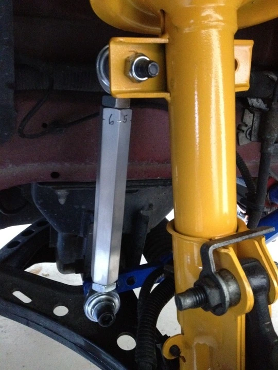

With the strut assemblies installed, we upgraded the occasionally problematic OEM swaybar end links with UPR's billet swaybar end links.
http://www.uprproducts.com/mustang-billet-sway-bar-end-links-front-05-satin.html

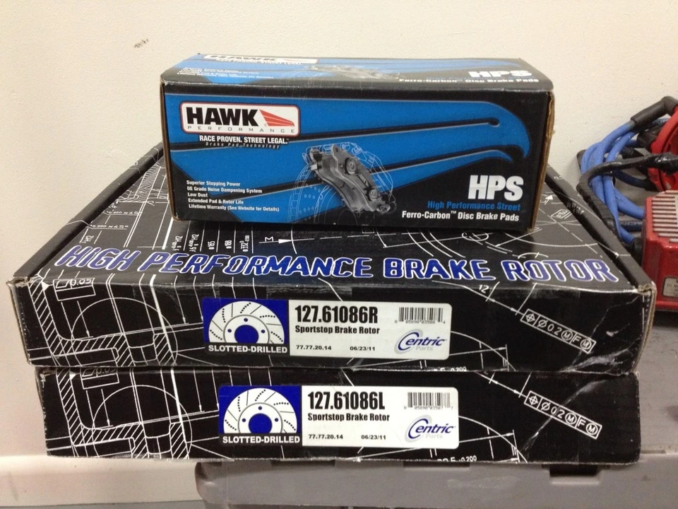

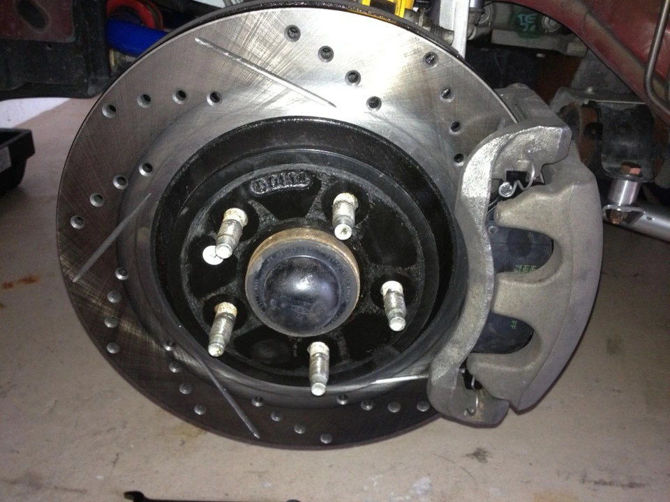

While we were up front, we installed these Centric brake rotors and Hawk HPS pads. (the rear was previously upgraded to HPS pads during the Sebring test and the whole system uses Motul RBF600 brake fluid)
Much better:

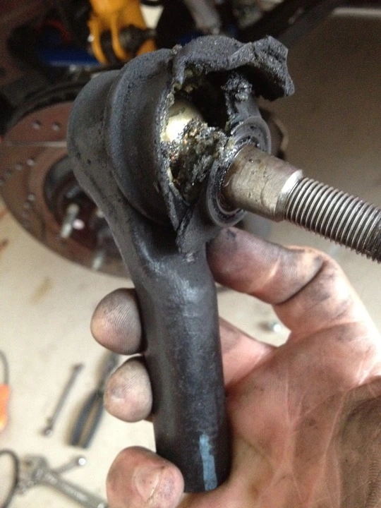

Interestingly, we only ran six sessions at Sebring last year, but apparently we baked the tie rod ends. Check this out!
Yikes. We replaced them with some Advanced Auto cheapies just to get the car back on the road, but we'll be using the UPR Extreme Bumpsteer kit with our S197 Handling Package:

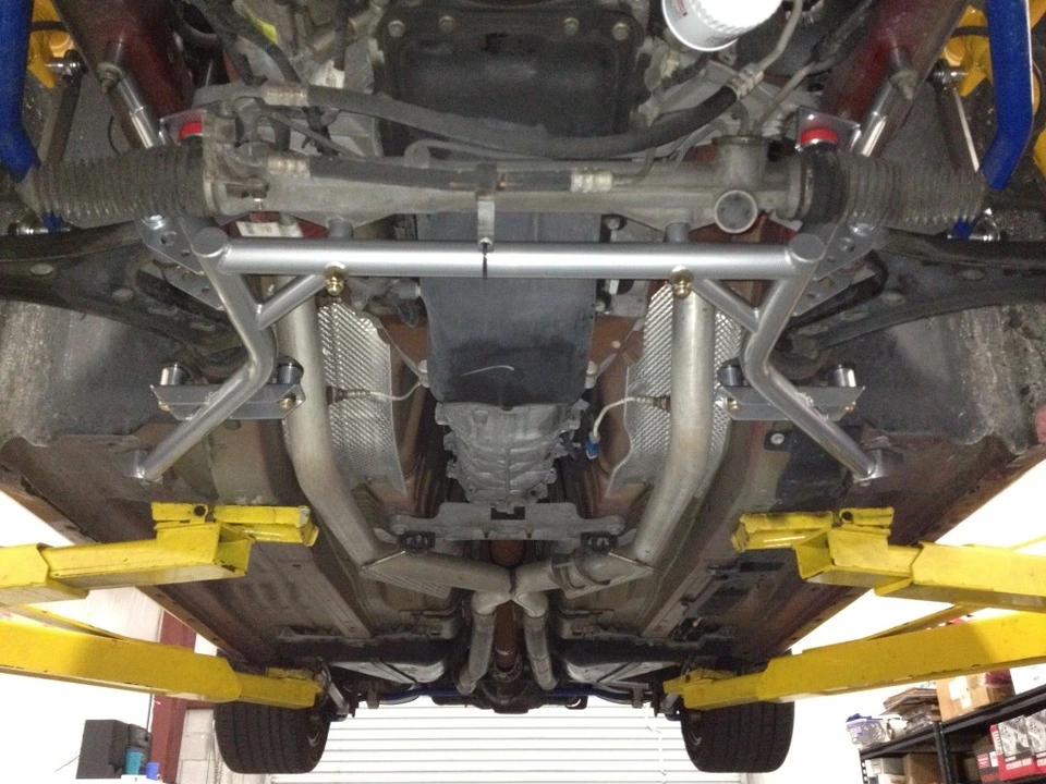

Last but most certainly NOT least, we installed our UPR tubular chrome-moly k-member kit to drop some weight off the nose and lower the engine 1/2" for a lower center of gravity.
http://www.uprproducts.com/mustang-pro-series-chrome-moly-k-member-05.html
We took the car to Mustang Performance Racing in Boynton Beach, FL where Tim Eichhorn made quick work of the k-member install. It can be installed on jackstands with hand tools, but we wanted to photograph the car up in the air, so this did the trick.

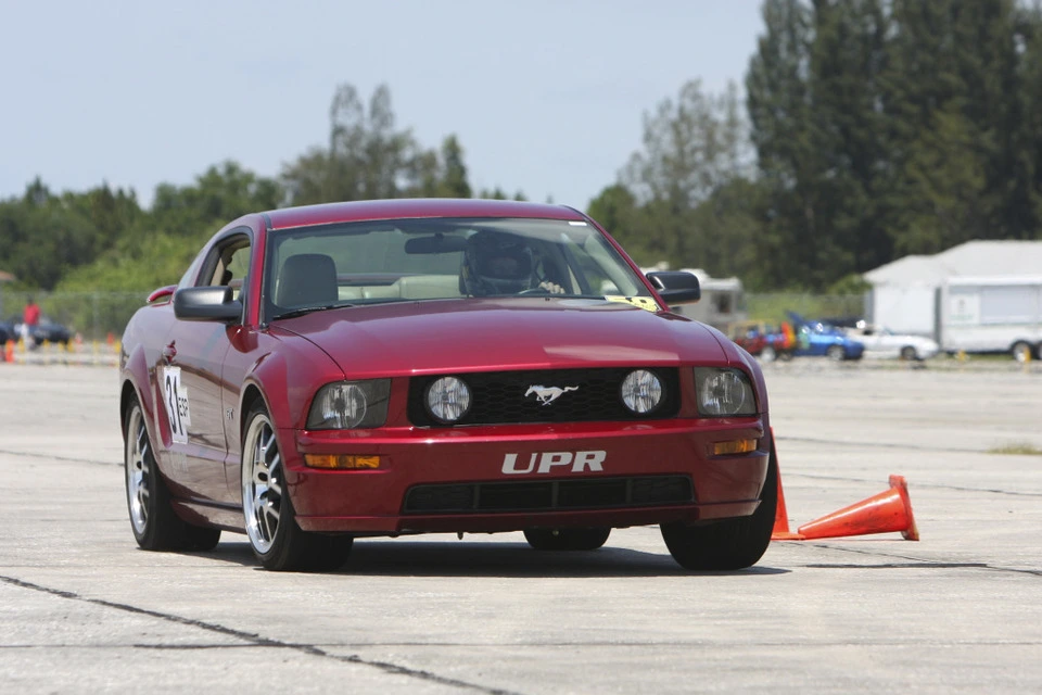

Well, the difference in cornering grip was unbelievable. I drove around town for a few days hitting my normal corners with enthusiasm just to see how much more cornering grip the UPR S197 Handling Package has to offer. I was able to carry quite a bit more speed on my favorite corners, so much so that I was afraid I'd lose my license before I found the limit on the street. So I did the responsible thing and entered the car in a local Autocross event.
I had modest expectations since everyone in my class was running slicks and I was on relatively narrow Goodyear F1Supercars, but I was pleased to find that I was able to run in the middle of the pack. In fact, I was faster than several exotic cars on slicks with my '06 Mustang on UPR suspension and street tires. Most importantly, the handling was smooth and predictable. There was a surprisingly good amount of grip available, but I could easily rotate the car with the throttle, without any unexpected surprises. It's hard to describe exactly how it felt, so I'll just say that the car is much faster on the UPR S197 Handling Package, but it's also easy to drive at the limit of grip.
Here are some pics of it on the autocross course-
Exiting the box:
Hangin' a left:
