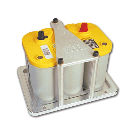

I currently have the red top but will switch to the yellow if the red ever dies. My local pep boys sells both for $129. The tray needs to be messed with and the mounts are messed up. I just ordered a billit aluminum holder for the optima...$99 http://aerospacecomponents.com/battery_holder.htm

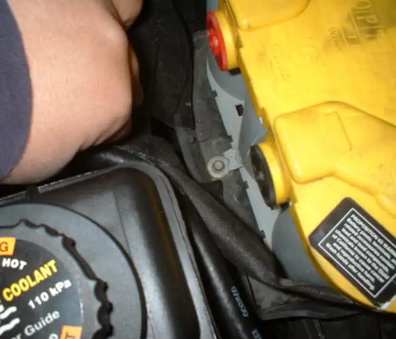

that tie down id really nice. but if yu want to save 100bucks, this is what i did with mine
I think tray itself posed no issue. But tie down didn't work. And didn't know about facy tie down, so i made this little redio back strap, and its holding down on edge of YTP. after branket is placed, you won't see any of it, as if battery is just chilling there. But it won't go anywhere

I played with the stock plastic tray bracket to make it work. I've had an optima in my mustang for 5 yrs and its secure. I just really liked that optima hold down kit and wanted to waste some money.
I've also seen a billit replacement hold down to replace the stock plastic one much cheaper. Think it was from MMR.
