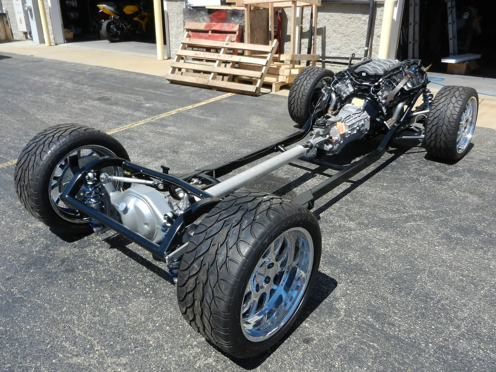

I know you said front clip but,
complete sub chassis are offered by Schwartz performance, The roadster shop, and Scotts hot rods
Some will even go under the existing floor with little modification depending on drivetrain choice.
badass but all are pricey.

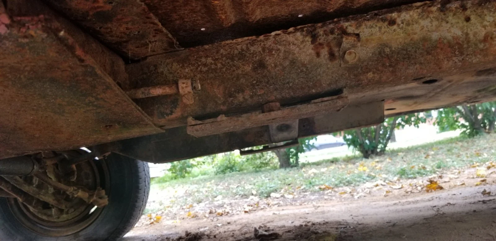

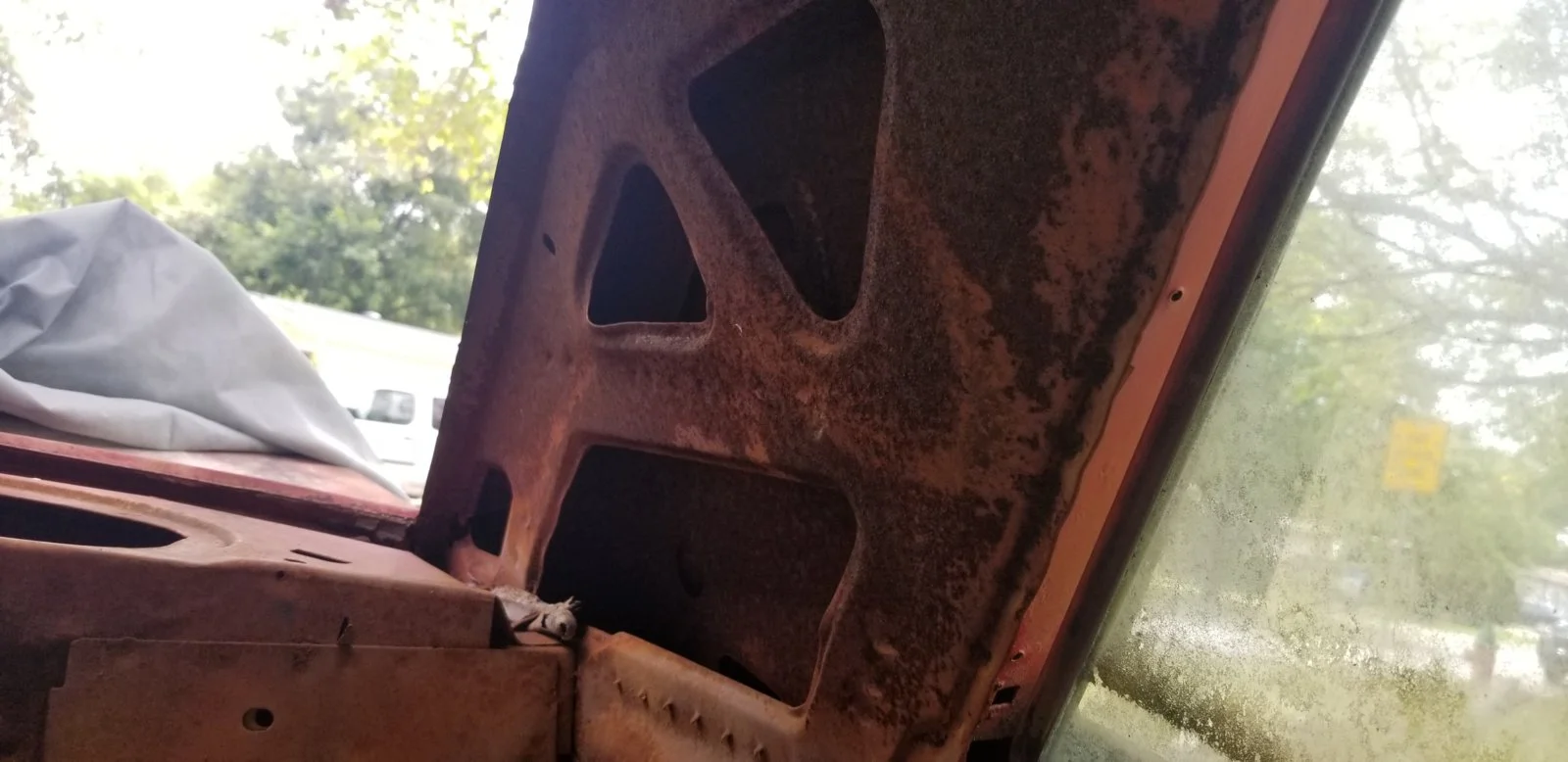

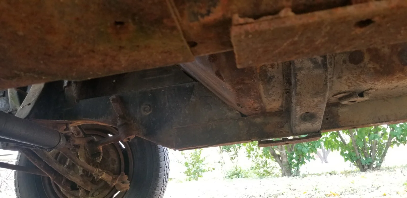

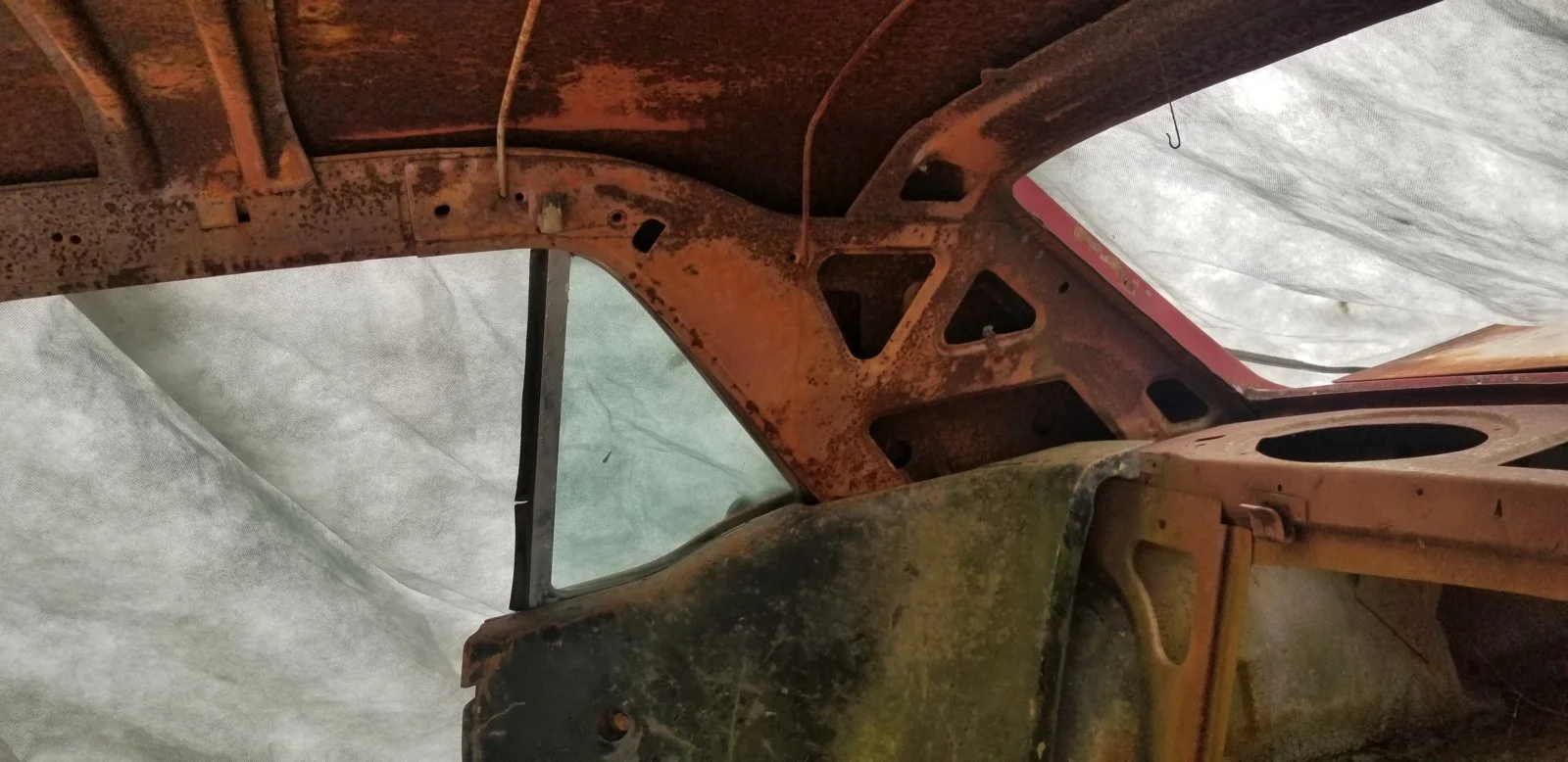

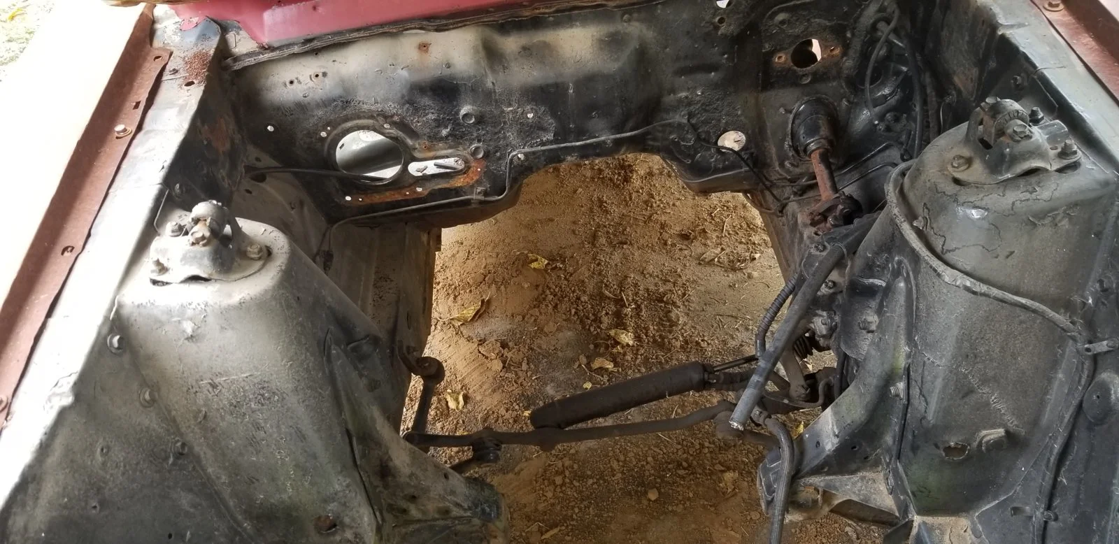

pictures attached. Best I could get right now. Car looks rough but its very restorable. Few areas have issues that might be a pain.
The inside quarter panel frame is all rusted as you can see in the pictures so I hope they are saveable. I could not find any replacement sheet metal for them. Inside roof is rusted pretty good but sounds solid.
Engine bay looks the best the with minimal surface rust but all the suspension that's on it is shot and being trashed.

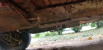

Best pics I could get of the frame rails. Looks like the rails underneath the floor pan are flat out rusted but the front portion at the aprons are decent and savable.
Already ordered floor pans. Should I get new frames rails or wait until after it gets blasted? I'm just blasting the inside. The outside I can take care of as the fenders and hood are trash and already removed along with the trunk lid. Rest of the body was sanded and coated with red paint but some areas have surface rust but again the outside sounds really solid.
Yes I was either doing a complete front clip like Total Control or new rails with a mustang 2 full crossmember. I'm just not knowledgeable on frame rails and torque boxes to replacing them. Beyond my skill level.

I see a lot of surface rust which isn't to bad. A lot of that will just sand blast and finish fine.
Your front rails might be just fine.
Hard to judge from a couple of pics though.
We expect the floor pans to rot out,
Blast and epoxy prime and start from there.

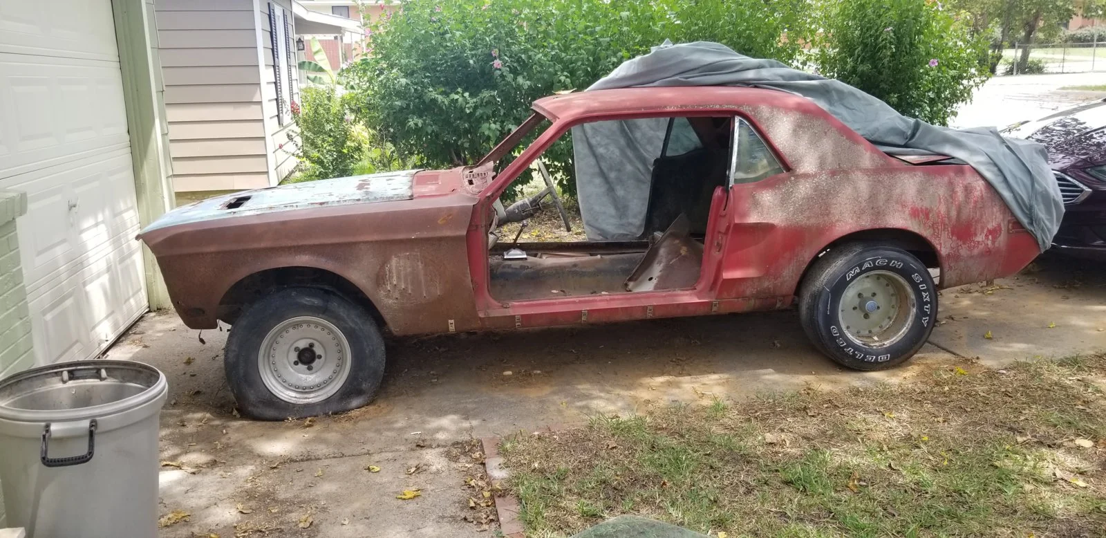

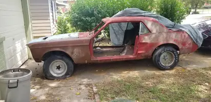

Sounds good. It's getting fully stripped this weekend and hauled to the blaster to do the inside. Got a pretty decent price for just the inside so I might have the outside done just to get that over with and he's only. Picture of the entire car is attached. I bought it without doors for 400 bucks with a title so I consider it a good buy at least lol. 68 is my favorite. Still has that small sports car look but with better muscular lines than the previous years. Plus they fit bigger engines lol. I'll be sure to update my progress. This is my first full on restore since when I got my 74 lemans when I was 16 back in 99. Oh have the years have past. Dang kids. It came with 4 good centerline rims I'm going to sell I like them but not my style for a street cruiser.

Decent shell with clear title is worth $400 bucks for sure.Of the 64 to 68, the 68 is the best looking imo.
I have this dream of a White with black California Special clone, just saying.
Nice! Mine actually came with that hood but it looks like its to far gone to save. Going to use it as wall art in the garage.
I lucked out when it had all the power steering components came with the car in the trunk that's usable. I just need to find doors now....
