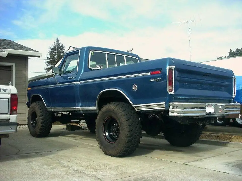

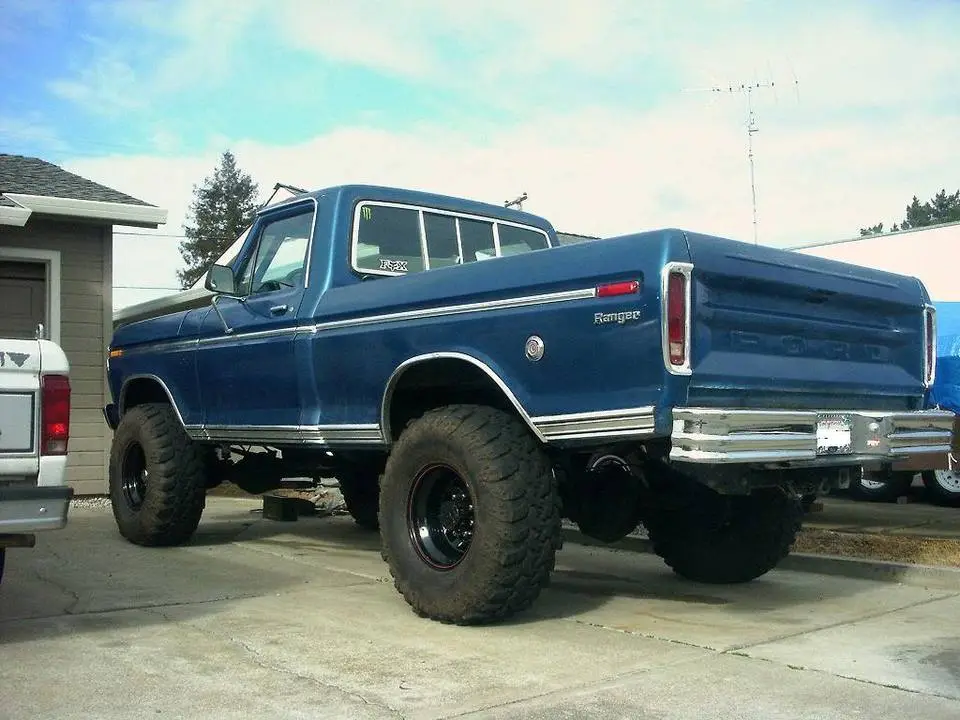

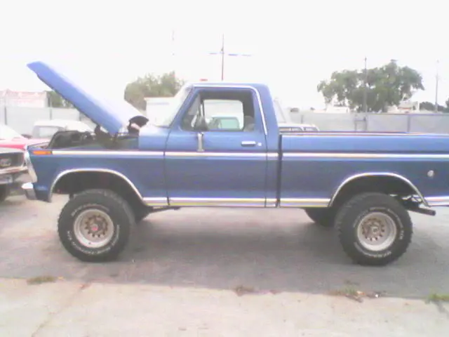

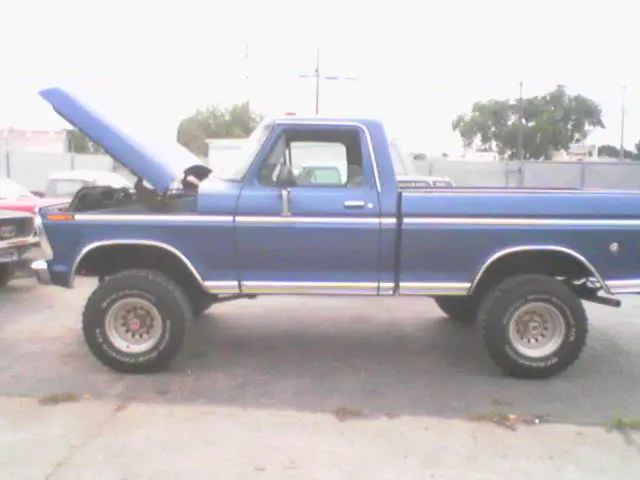

Heres what I like to play around with when im not wrenching on the stang. Heres when I got it stock

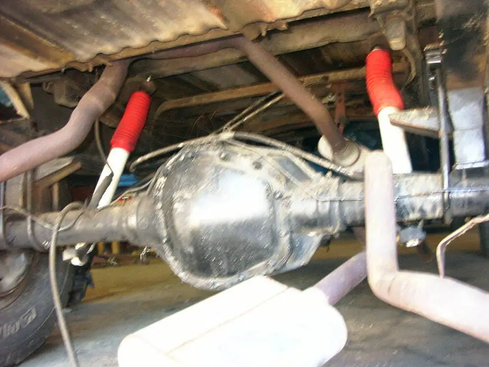

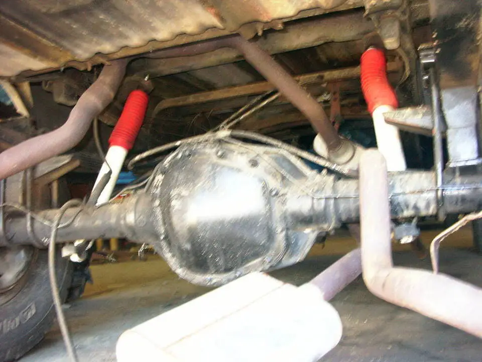

Threw in a Sterling 10.25

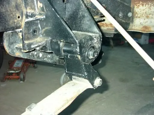

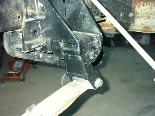

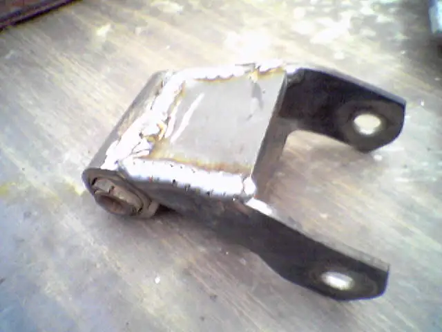

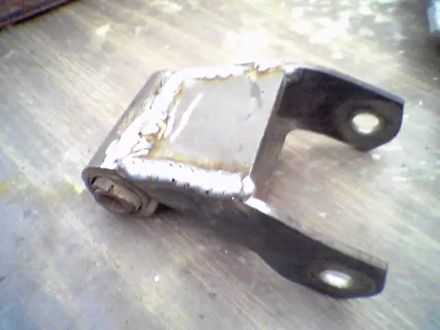

Eliminated the lift blocks using junkyard f450 front spring hangars and modified shackles

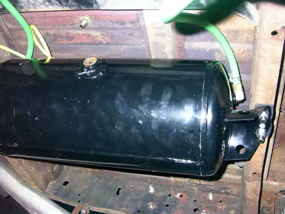

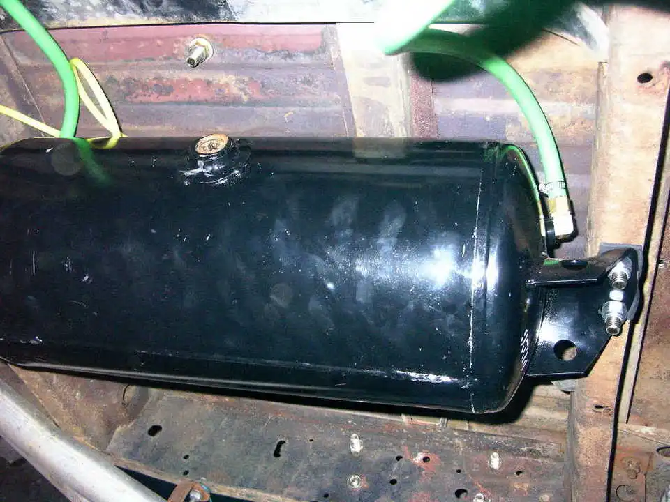

i added a plate that boxed in the end of the shackle aswell. heres my onboard air system utulizing a york ac compressor

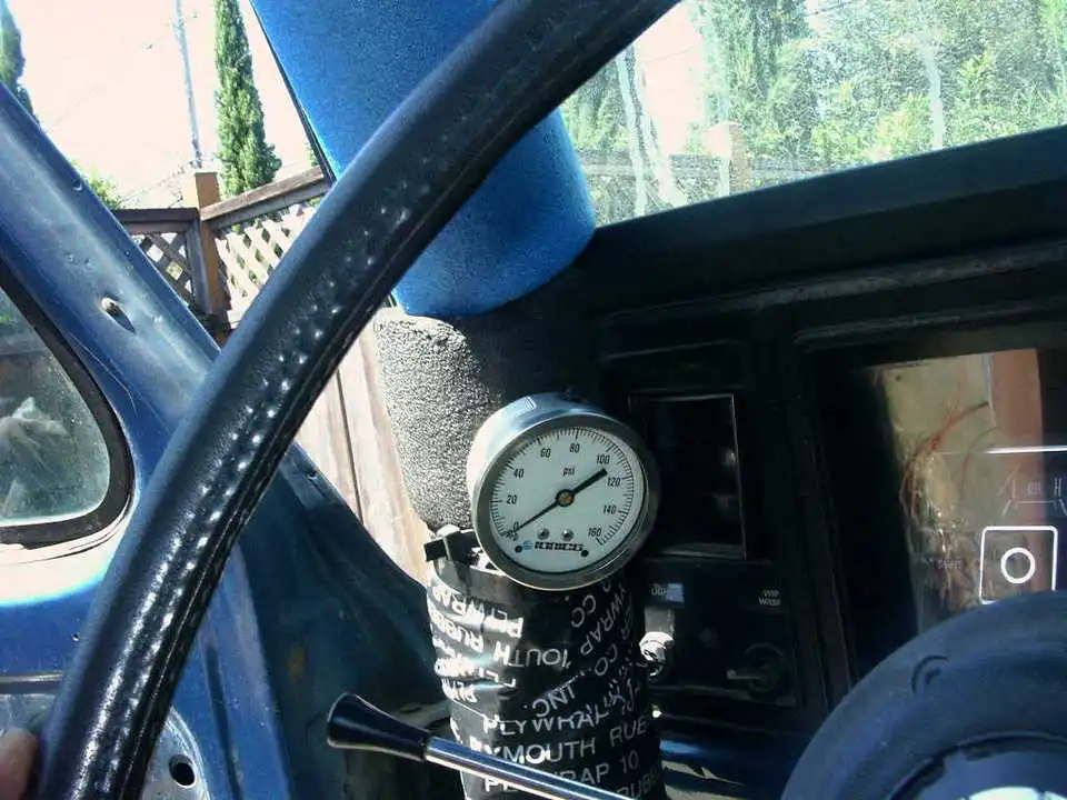

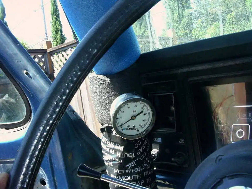

professionally mounted gauge :D

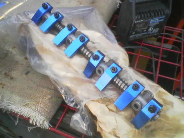

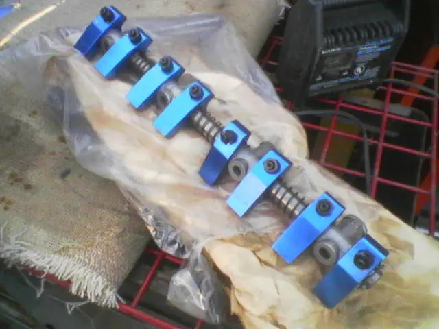

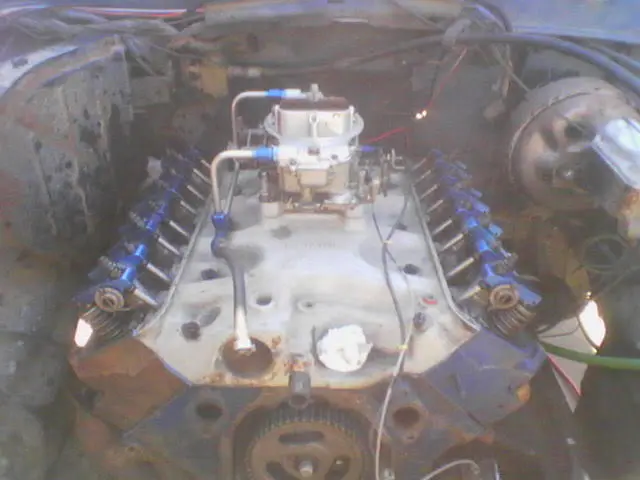

recent additions in progress : solid lifter cam, roller rockers, getting my gt390 heads done.
future mods may be a disc brake 14 bolt (free gm junk that I am working on) dana 60 front, much more.

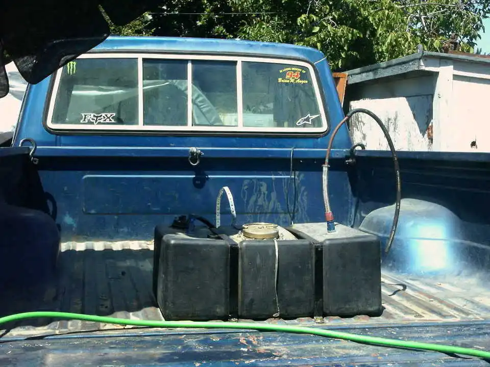

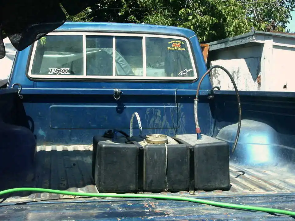

thats from last time it was rolling/running :D oh and the vent line on my fuel cell isnt permanent, just to block it off hehe

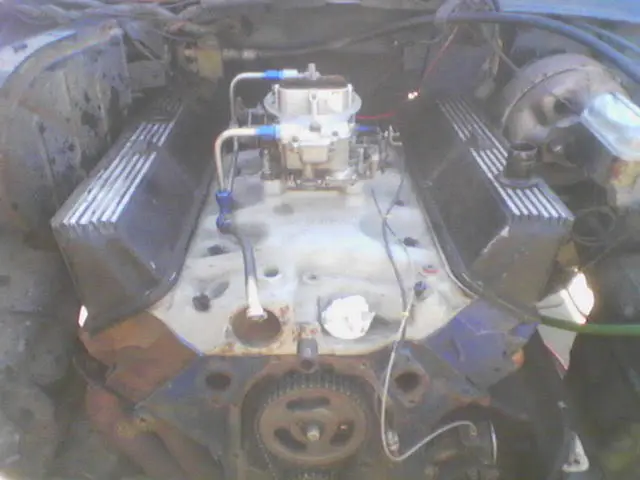

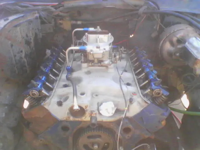

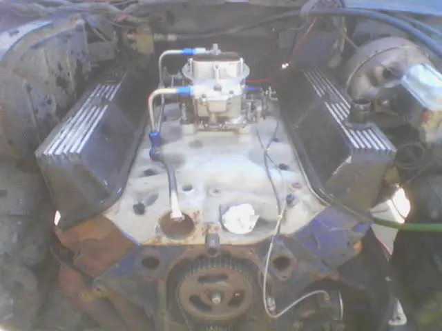

Finally going to get her running again. I have been waiting on heads for like 3 months, and they still arent done so I just got a set of c4ae's that were pretty nice cleaned them up threw on some 1 piece retainers and called it good. My carrol shelby valve covers are a bit tight with my heater box tho.
