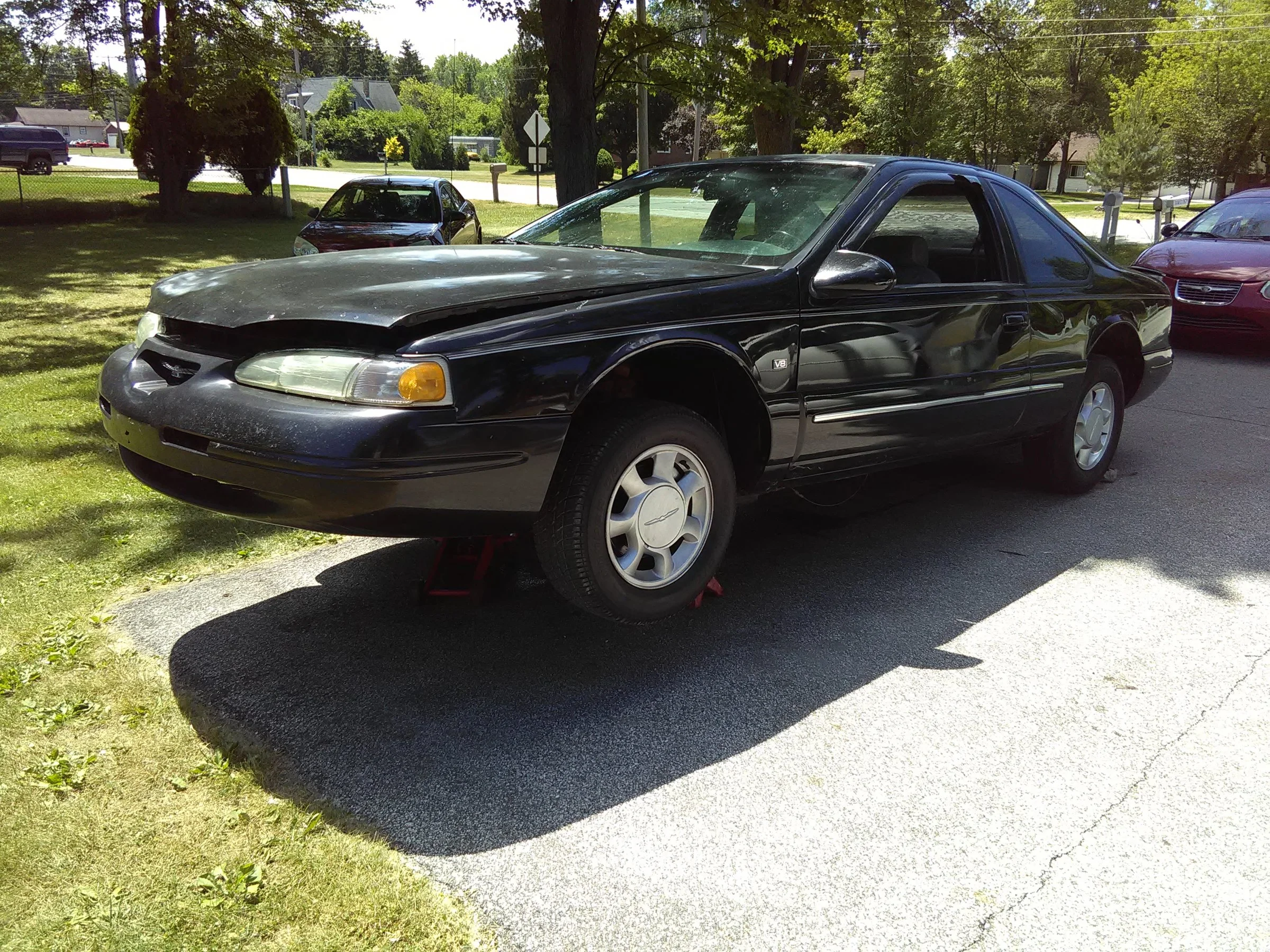

P71 Installed In My 96 Thunderbird Perfomance Tech Needed
Well after alot of time and labor I finally have my 2004 P71 4.6 interceptor installed and runnin, not too shabby I might add. Heres my question can I purchse a set of comp stage 3 cams along with a matched edlebrock aluminum intake and 90mm throttle body with cold air/tuner kit for a 2004 mustang gt. Any help or suggestions welcomed
Everything you just said is overkill, and will remove all the torque that a heavy car like that desperately needs. If you're sticking with Comp, I'd go for a xe262ah on a PI engine in an MN12. Otherwise, I'd be looking at a stage 1 or 2 MHS PI cam set for a car like that. Add a 70mm TB, or an aftermarket plenum and a 75mm TB, or a Bullitt intake if you want to go even further. Find an 03 GT MAF/airbox if you're paying for a tune anyway.
