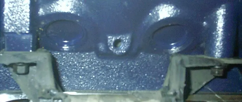

Hey,
I'm getting ready to put my motor in my car...finally. I found a tapped whole in the block about 1" up from the center of the motor mount bosses on the drivers side. There is a whole similar to this on the passenger side, but it just looks like a drilled and tapped whole. What goes into the tapped whole on the drivers side???
THANKS
i couldn't find any holes. The motor mounts have bolts and then an inch forward (toward front of car) is a freeze plug then the starter wire bolts up. On the drivers side, I didn't see a freeze plug after the motor mount...the oil filter is pretty close to the motor mounts? :shrug:
Here is a picture...drivers side...
It looks like to me to be the oil passage. If I am correct, it should just have a pipe plug in it. It's also a nice place to get an oil pressure reading. There should be a couple pipe plugs in the block. Just look in the hole and if it looks like it goes somewhere, it's an oil passage. Just get a pipe plug and screw it in.
